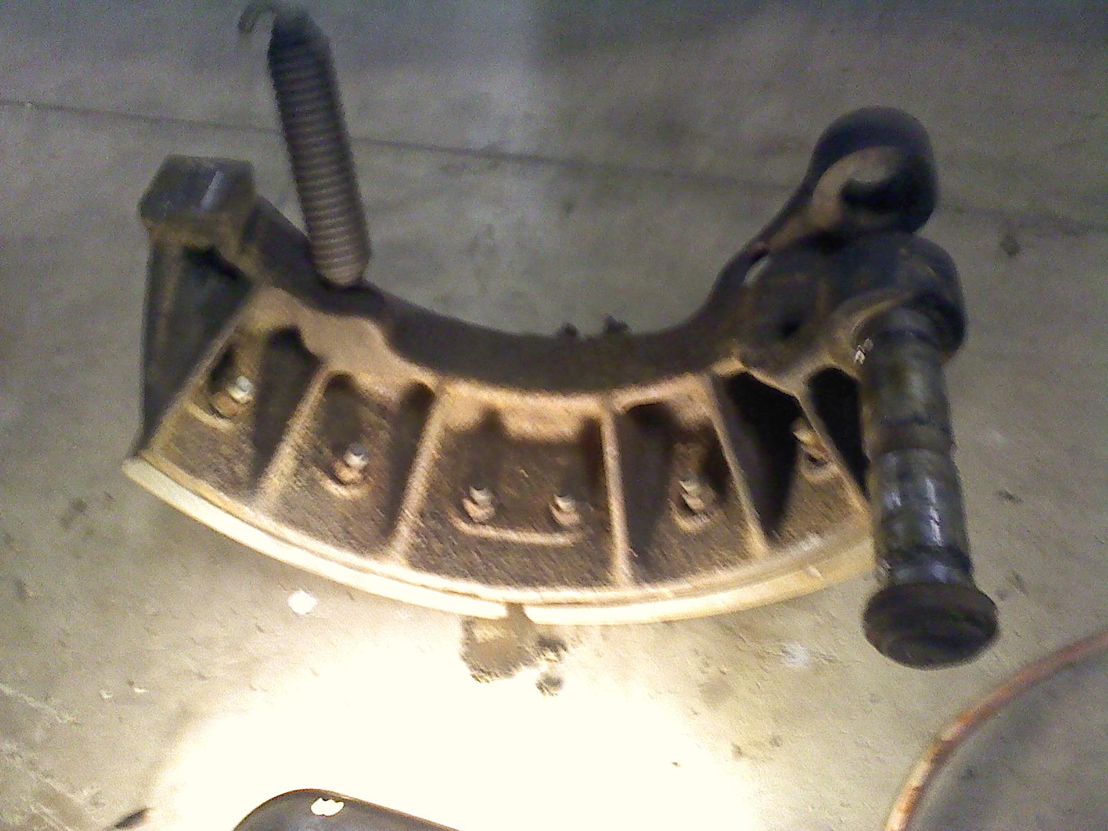

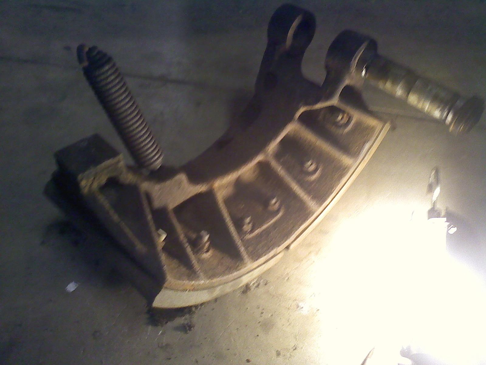

  16. He tried to get them relined but they told him the lining was no longer available . One shoe would cost $265.00 already relined, that's just crazy.
  17. A friend is replacing his brakes and can't seem to find shoes for his truck. He is working on a 1964 B61 rear brakes.Does anyone know where to get these shoes or is there a replacement number to change style? These are extreme service but he does not need these same shoes, can go with a lighter version if possible. 16 1/2" X 7"
