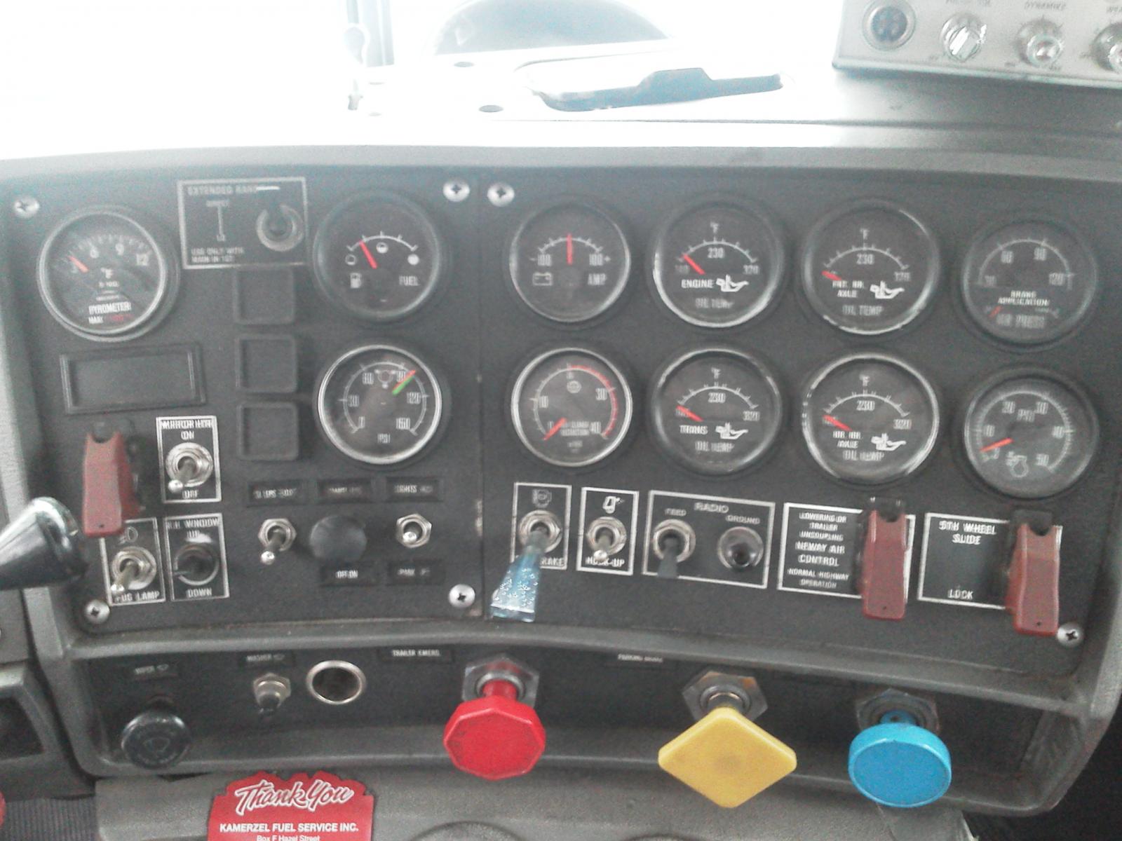

  4. Here's my dash, when I put the 12 speed in, I had a hard time finding a place to put the air switch for the low range, but made it work.

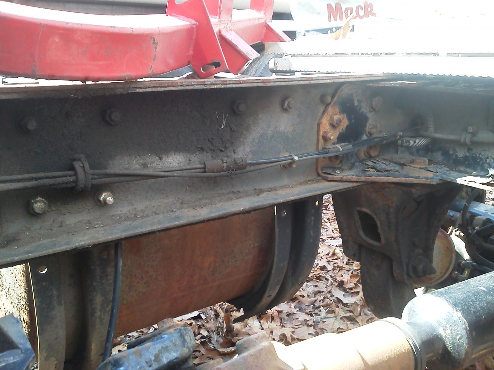

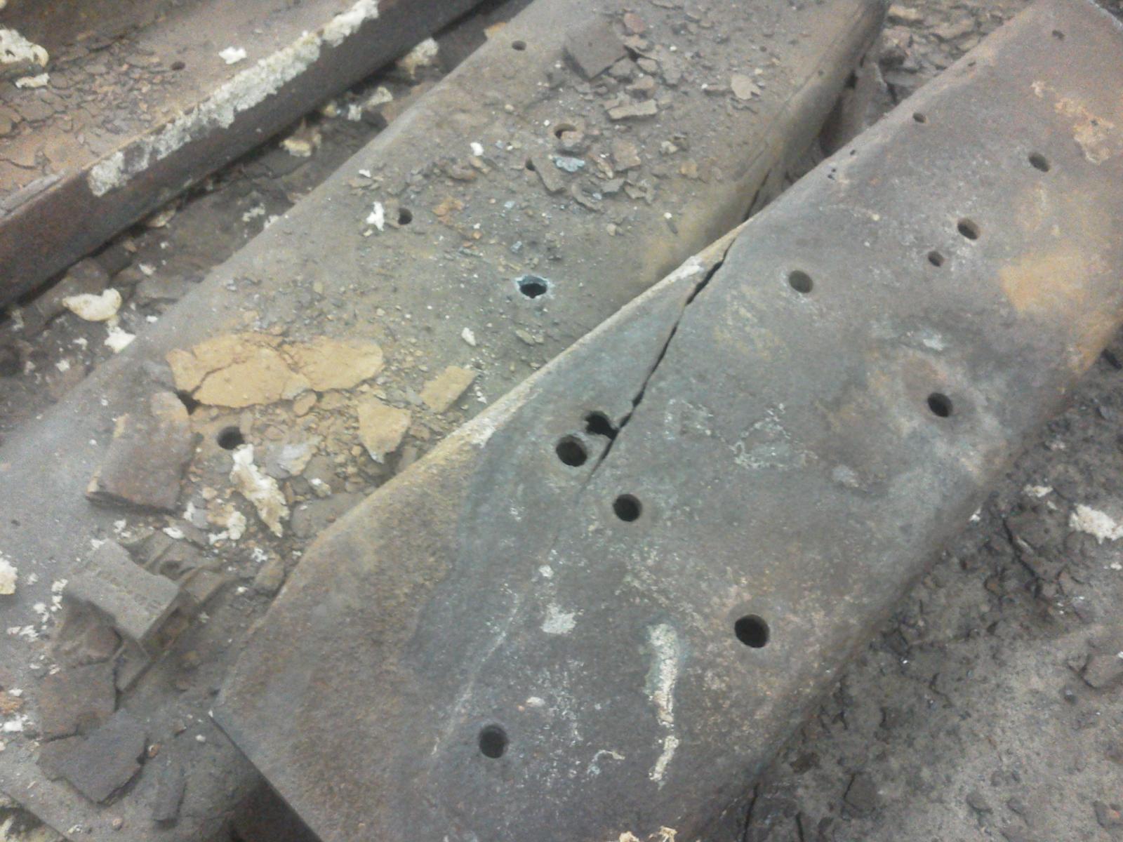

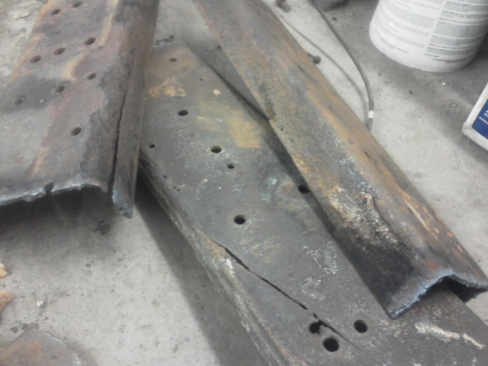

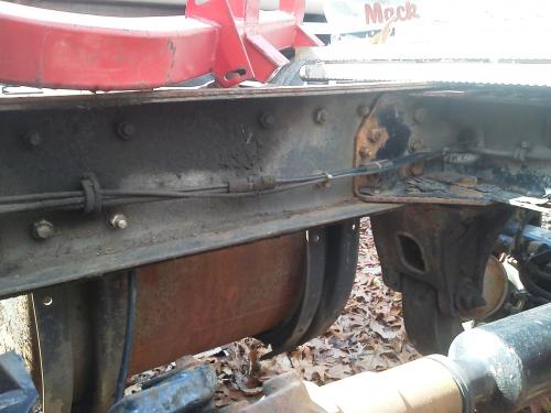

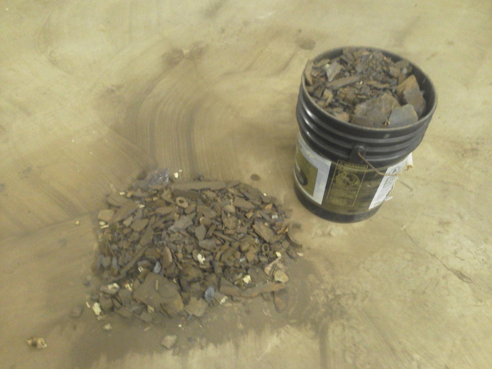

  7. I think the foam was used to try to keep the spreading from getting worse, but as you can see, it didn't work.

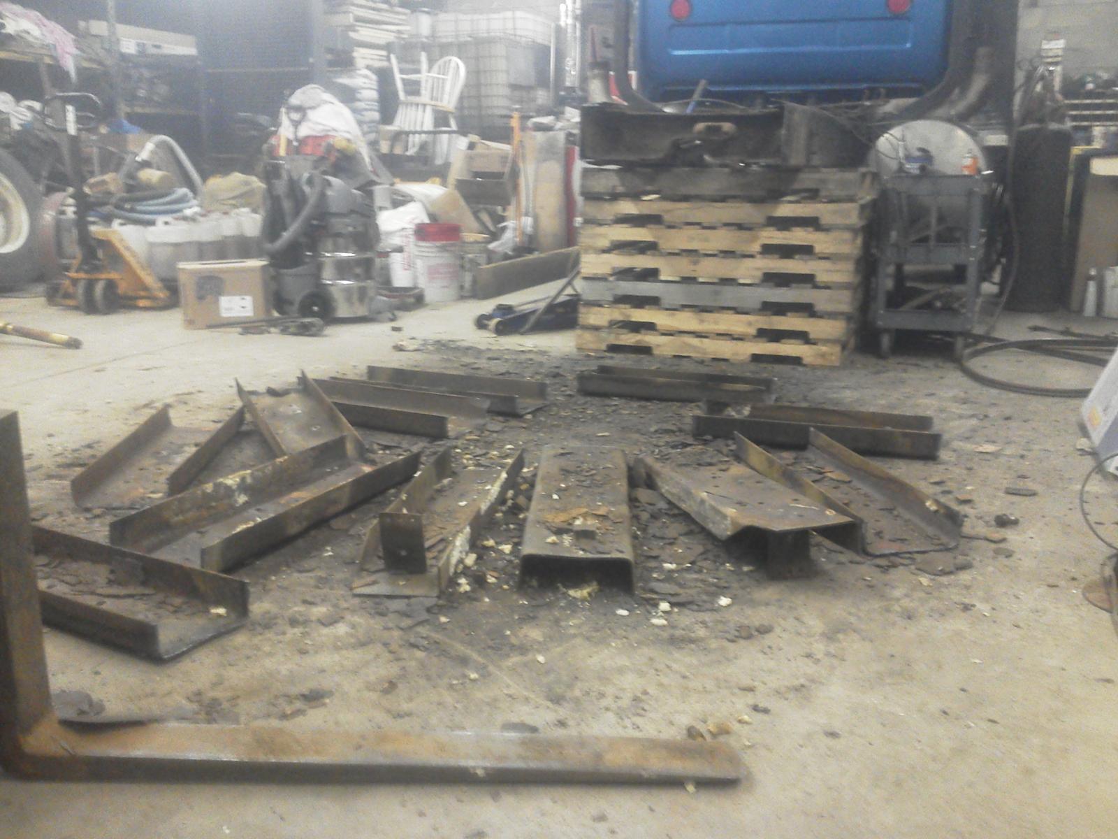

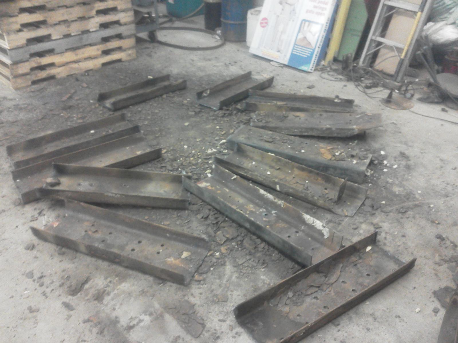

  12. WARNING- DO NOT VIEW PICTURES IF YOU HAVE A HEART CONDITION, WEAK STOMACH, BECOME LIGHT HEADED, DIZZINESS, OR STANDING UP. In my project of "saving super" I had to cut the frame up or should I say what was left of the frame. I know, I know, No one likes to see trucks get cut up but I had to do it. That's my story and I'm sticking to it.
