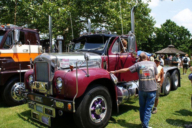

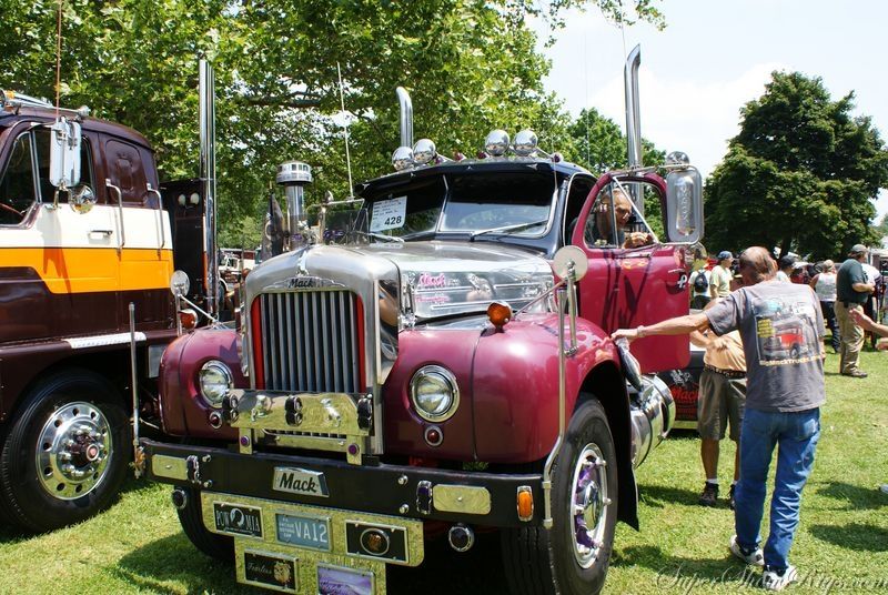

  16. Yes, the pictures of him in his truck were taken June of 2010. When I was talking to him, he said a couple of months before, he had his spleen removed, The doctors told him if they didn't remove it, he would die, if they took it out, he had a 20% chance to live. It was not long after you saw him at Litiz, he decided to get a flu shot and 2 days later, he died. He got sick from the shot and never recovered. His cousin Neal Deblasi drove Bobbys truck in the funeral which was a nice tribute.
  17. Yes it was Bobby's truck. He use to bust me all the time about my big V-8, How's the V-8 running? He loved the V-8's. Sal Merola Jr, from Pardesville bought the truck, so it stayed close to home. I was going to buy the truck, but by the time I got the money together, it was sold. Bobby use to drive for Jude Lonzetta of Hazleton. He still has his V-8, in fact, yesterday I just sold Jude 2 spare V-8 heads from a spare motor I bought off Bobby. His were cracked. My 613LST does not have a aluminum hood but that doesn't mean it wasn't changed at one time or built with one. I just haven't seen many around. Maybe the ones I did see were painted. The b73 and 75 hood would be longer wouldn't they? Yes that was bobby's truck and thanks for the pictures, we all love pictures. I bought alot of parts from Bobby. His truck had 1 NOS fender and I have the other, also 2 NOS inner fenders plus 2 or 3 shelves full of B parts.
  18. A friend of mine passed away last year. He had a B61, that had since been sold, that had a aluminum hood. Does anyone know what trucks had these. I've seen several on B67's but they are shorter. He had it polished and it looked sharp. Maybe someone here has a picture of it from Macungie of 2010. The truck was purple with black fenders. Was a tractor. I looked through all my pictures and just realized that I have no pictures of it.
