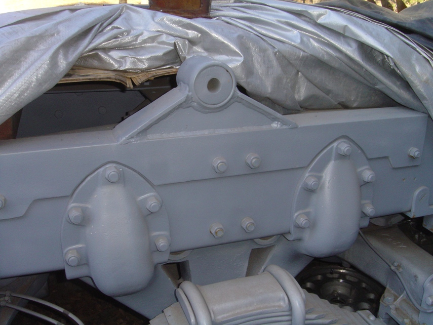

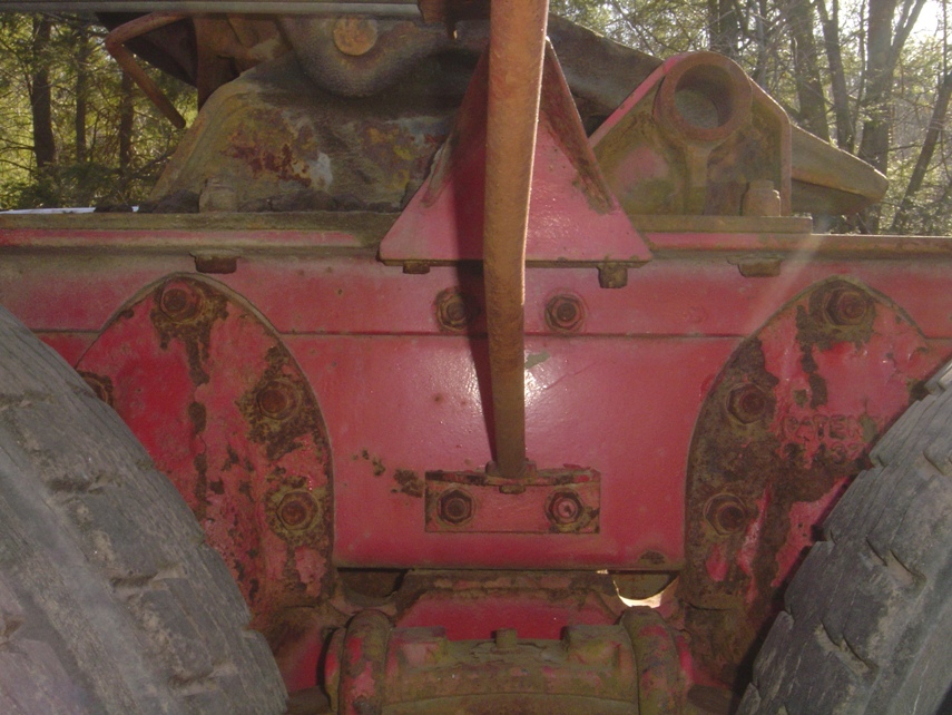

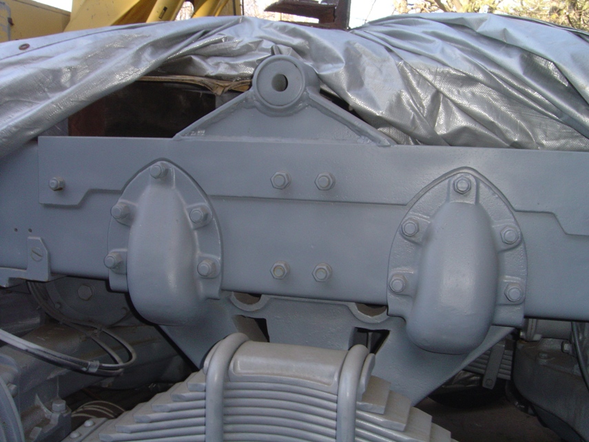

  2. The numbers on the rear of the sumps are the models such as SWD 573, SWD* 574 etc. The carrier housings have the numbers on the right front, model and ratio etc. Most drop-ins will interchange,and I am sure 3.65 is the fastest. And you don't have to go in to check ratio, roll the truck and piece of chalk will do it. Just trying to help. FW

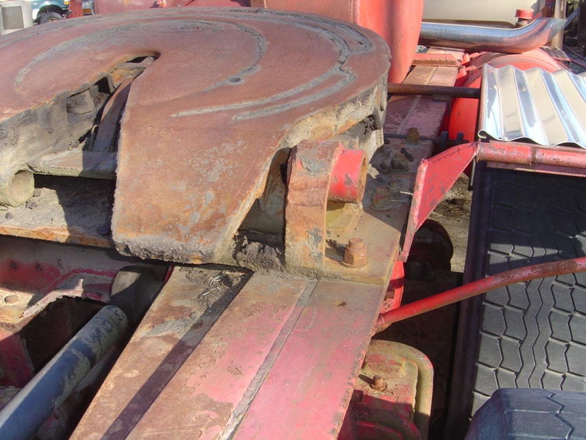

  7. Here are two different ways to mount the angle iron, angle out with plate allows for front to back adjustment, place to make stationary and ease to remove. Angle in is much cleaner look with little or no options for change. I have had good service from the Holland brand. FW

  11. All 92/93 carriers are the same,except a few variations in the power dividers and the torque rod mounting. The driving axle splines are the same for 34k, 38k,and 40k axles. FW
  12. Change the drop-ins, if they have bolted torque rods splice them to your tapered ends. FW
