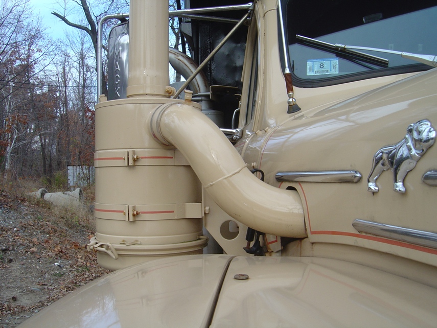

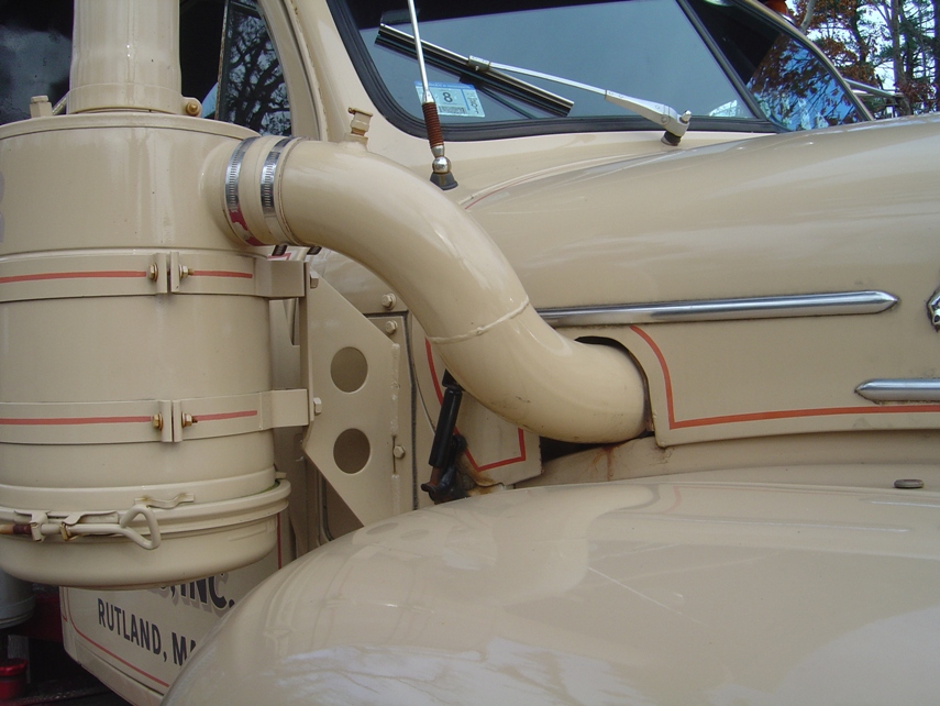

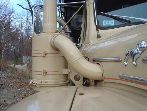

  17. When I changed from a natural to a turbocharged engine, you could hear the turbo scream through the fiberglass tube. I fiberglassed the whole pipe, it helped some. Moving the piping out of the cab solved the problem. I used a B 81 tube.
