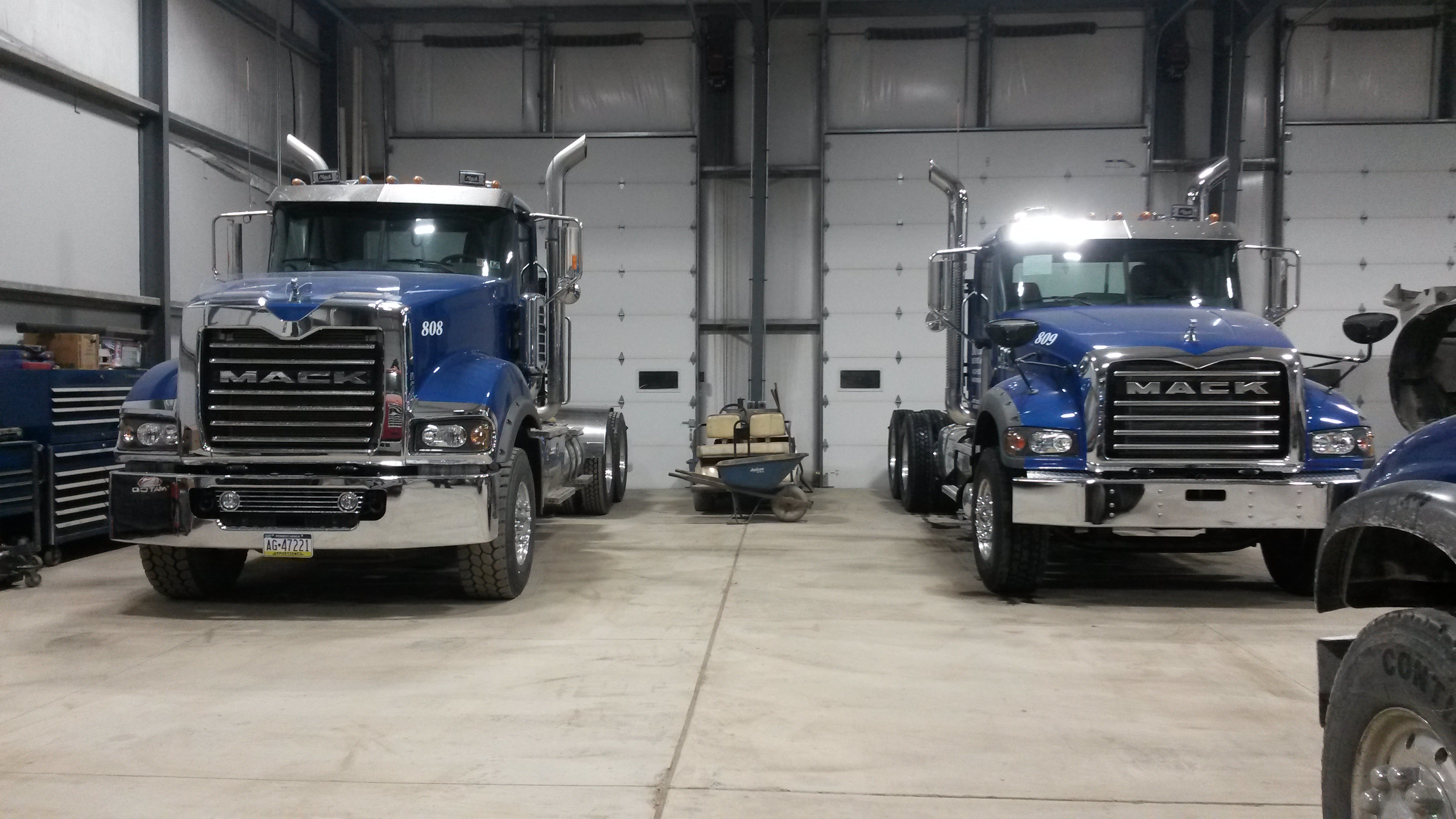

  10. I like a clean shop, not hard to do when you're by yourself. Ya, the owner is a very patient person.
