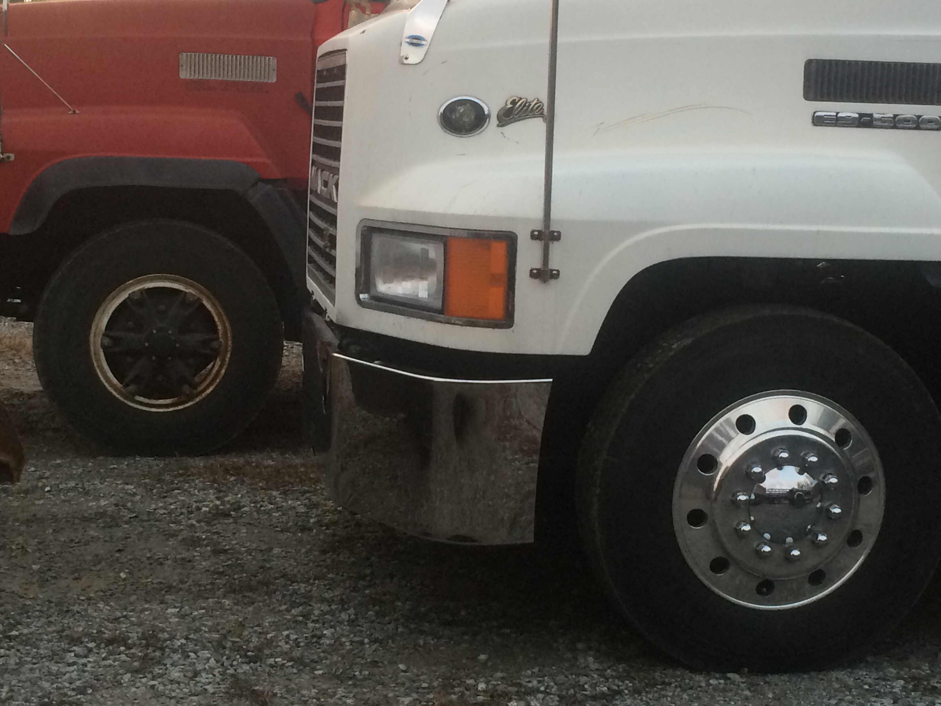

  1. Not a great picture but 12R24.5 on the red one and 11R24.5 on the white one. The 12's are quite a bit heavier than the 11's. Have 12.00x24 on the autocar and they are much heavier. Unfortunately they are getting hard to find in my area. I love the look of a big tired truck but the cost differance is substantial.

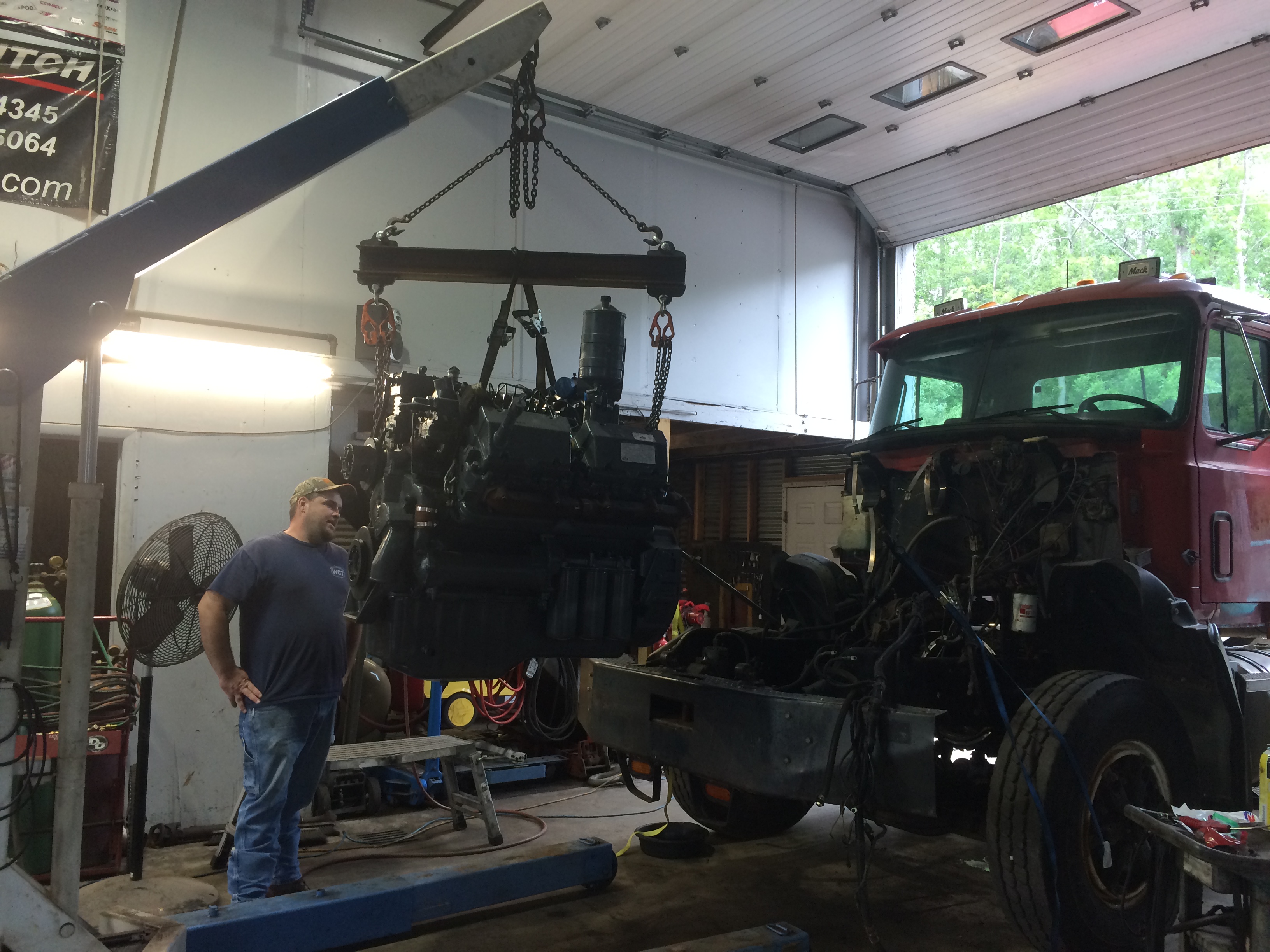

  10. Got the motor back in the truck yesterday. Should have some noise pretty soon! Updates to come.

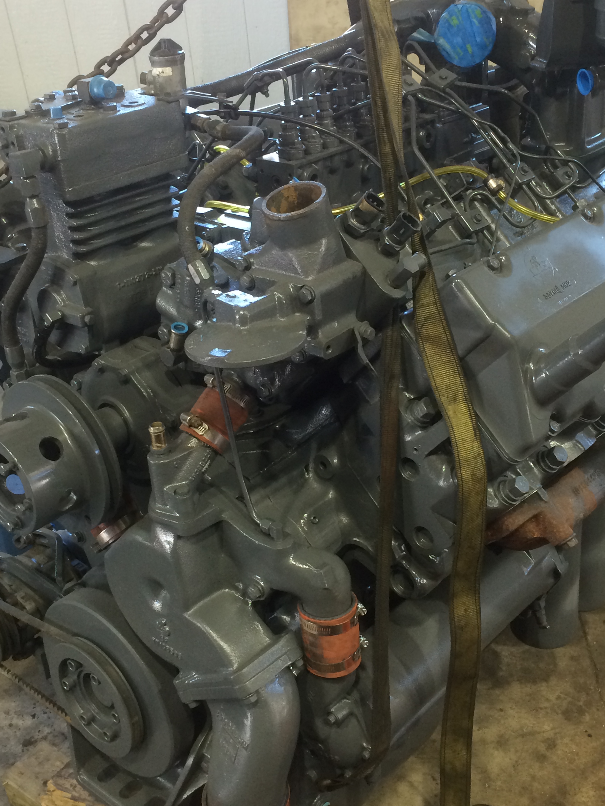

  11. Time to bring this back to life! It took me a while to piece it back together but the engine is just about ready to go back in. Hopefully if my plans all work out i'm going to try to get it back in this Saturday. Ill snap some pics and keep you guys informed.
