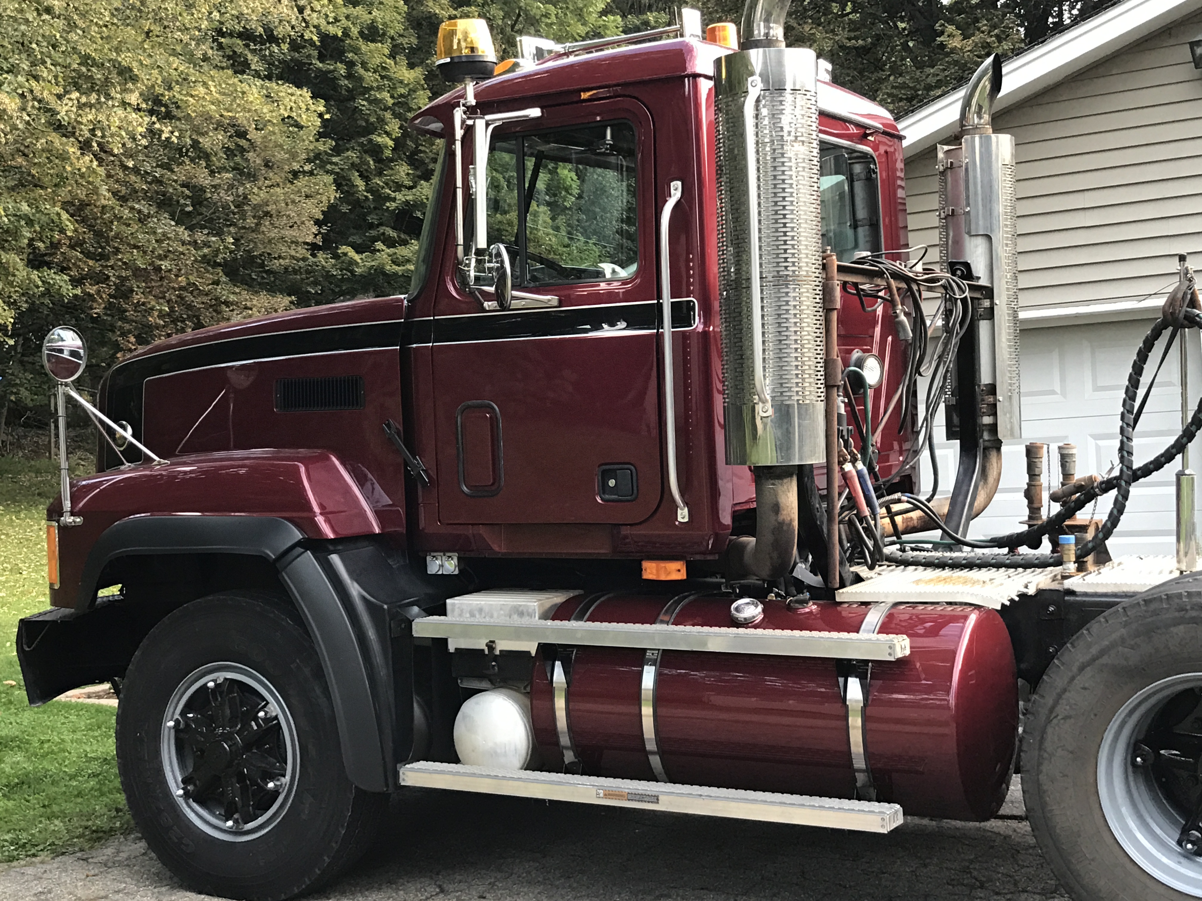

Back from paint shop
BGarofalo replied to BGarofalo's topic in Antique and Classic Mack Trucks General Discussion

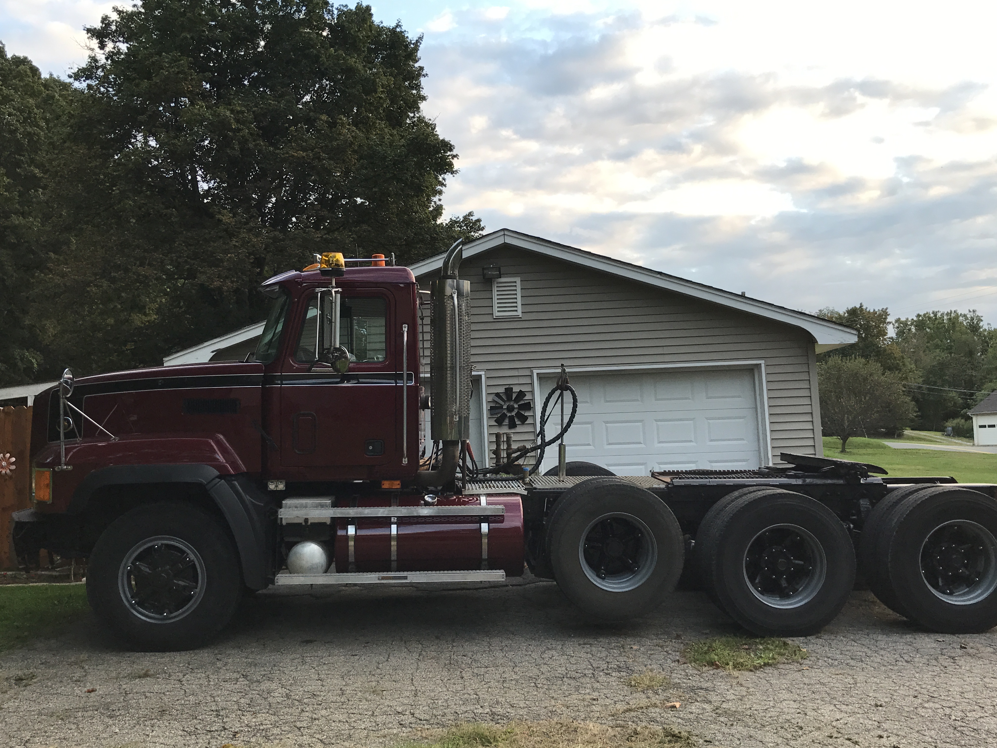

I had to be persuaded by a few friends to get the tanks painted. I've always been a fan of polished tanks but I thought it might be "too much" for the colors of the truck. I like it though. As far as my plans with the truck, I really don't have any. Drive it down to town to get coffees for the guys . Again thanks for the compliments! Its nice to be around guys who share the same passion. -
Well I made a bit more progress today. I got the tanks back from paint and mounted them to the truck. Still have to clean up all the aluminum pieces and get a good coat of paint on the frame. Little by little it's moving along. -

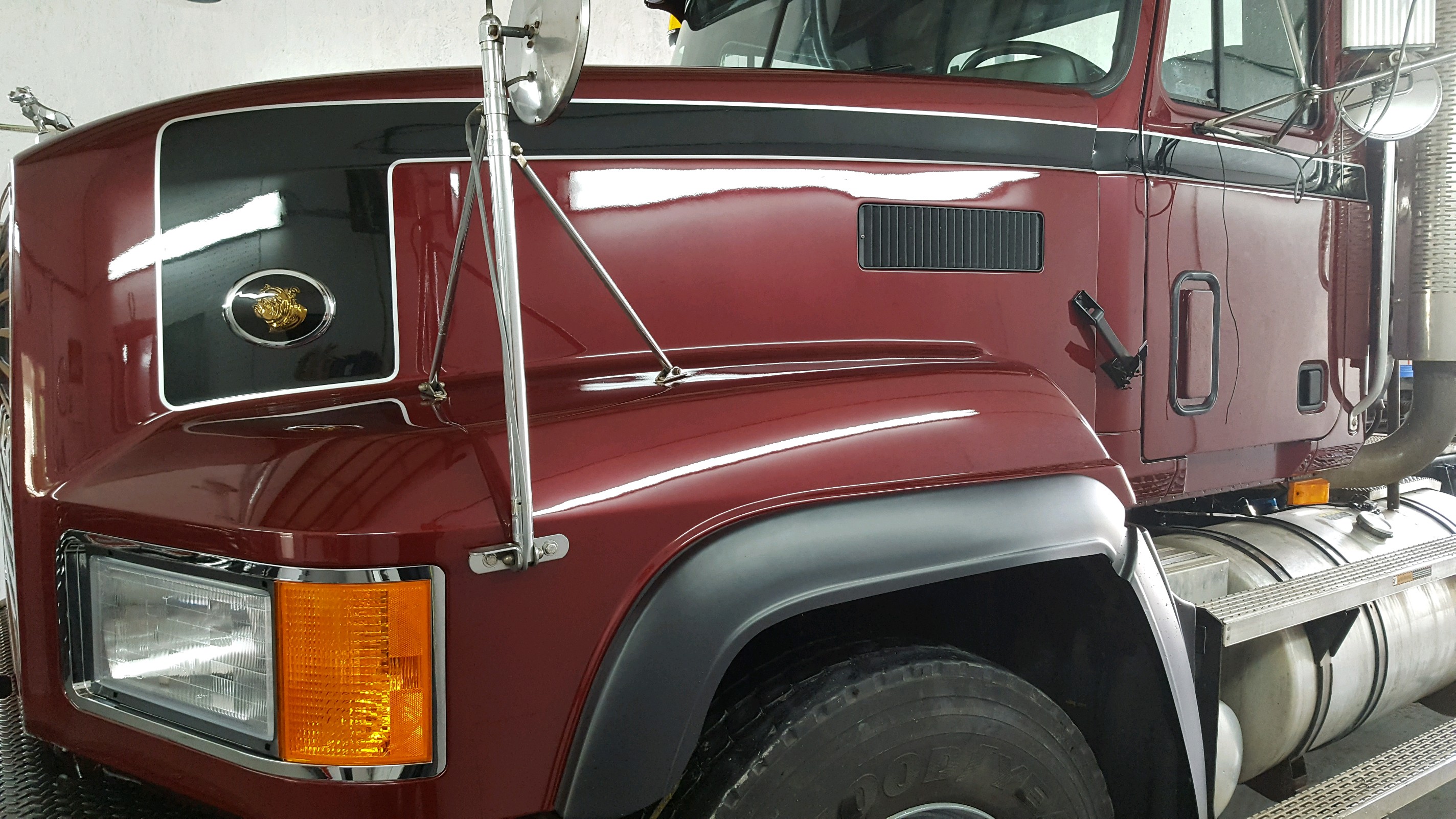

Thanks for the kind words. Instead of polishing the tanks I've decided to paint them. They should be back Thursday so I'll get a few "mostly" finished pictures. -

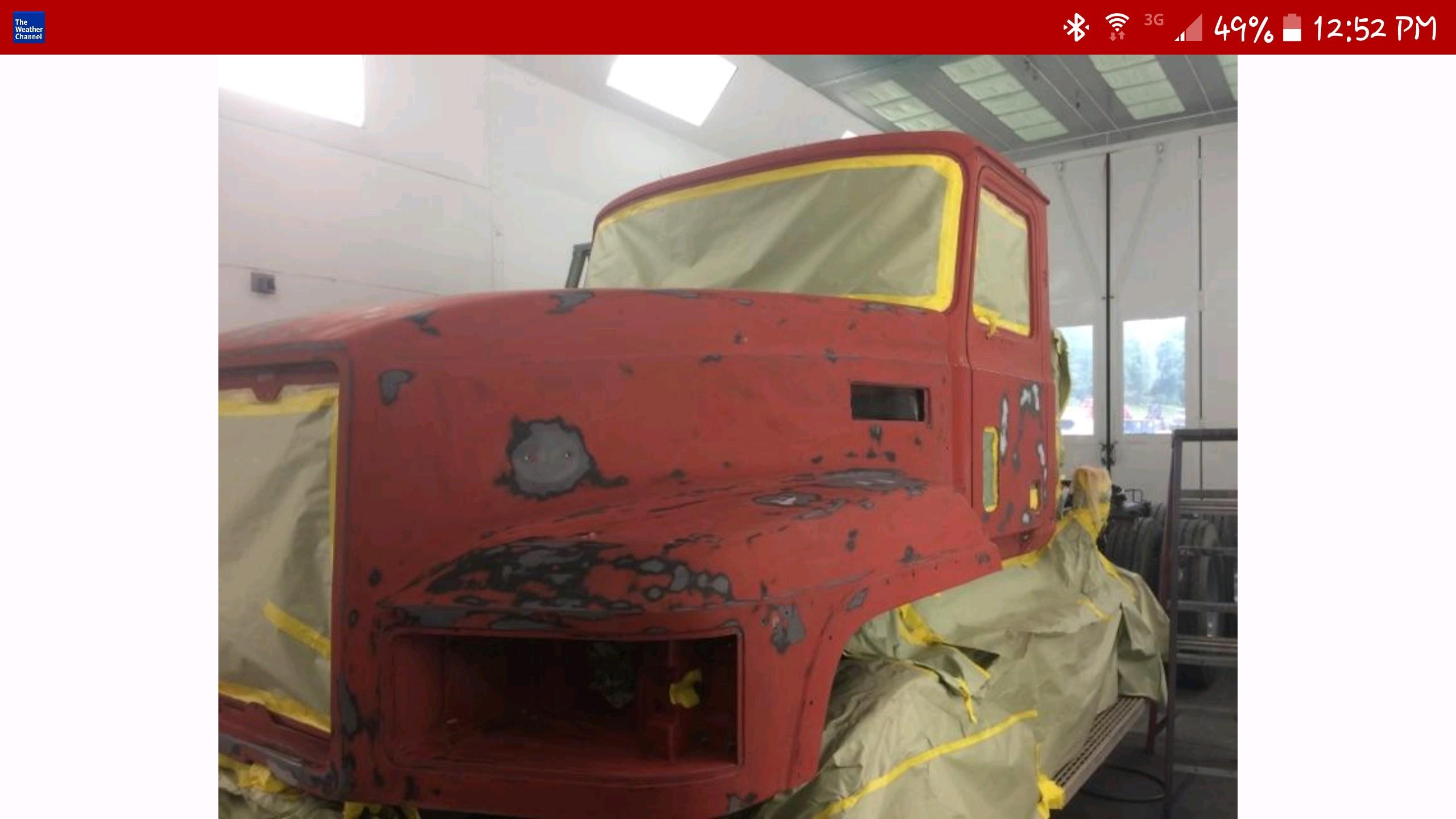

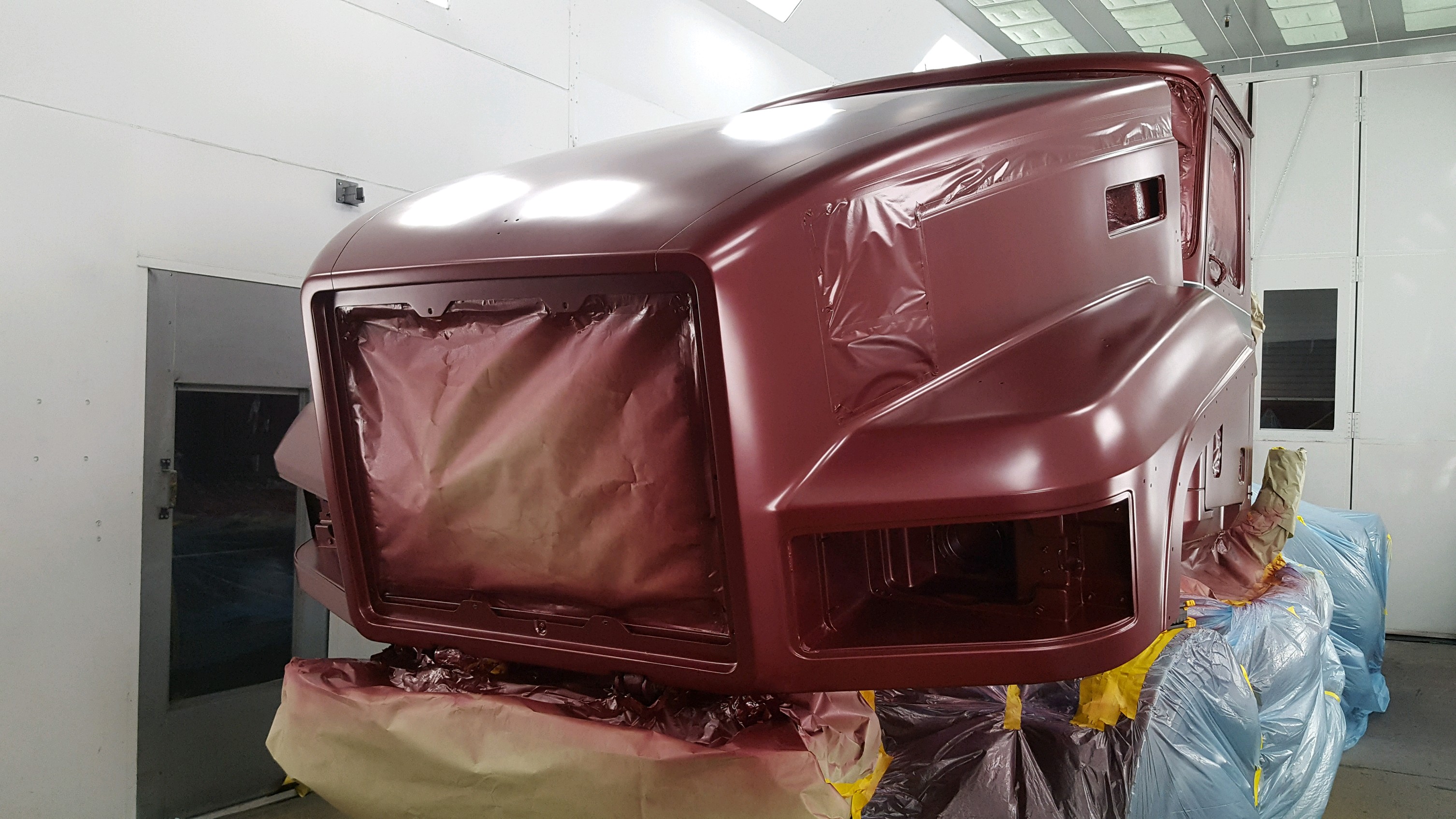

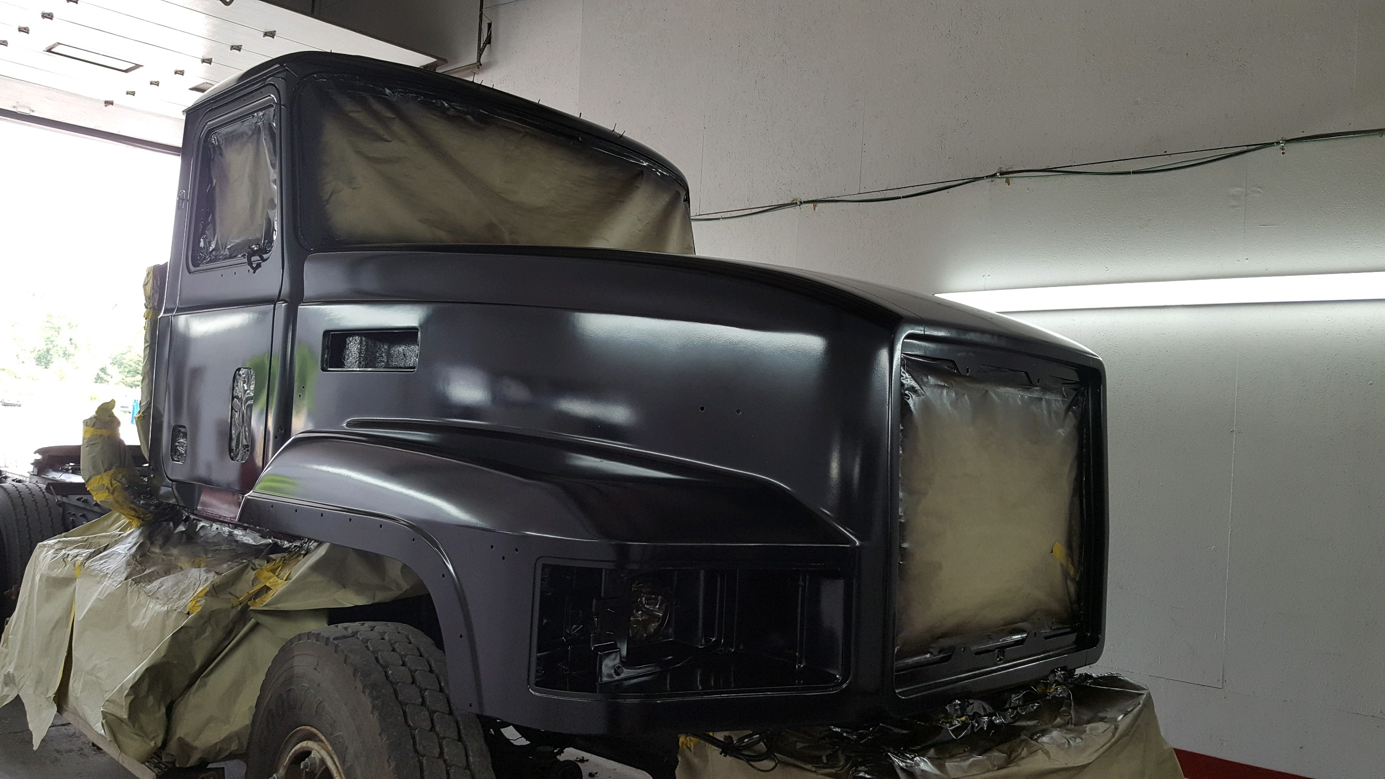

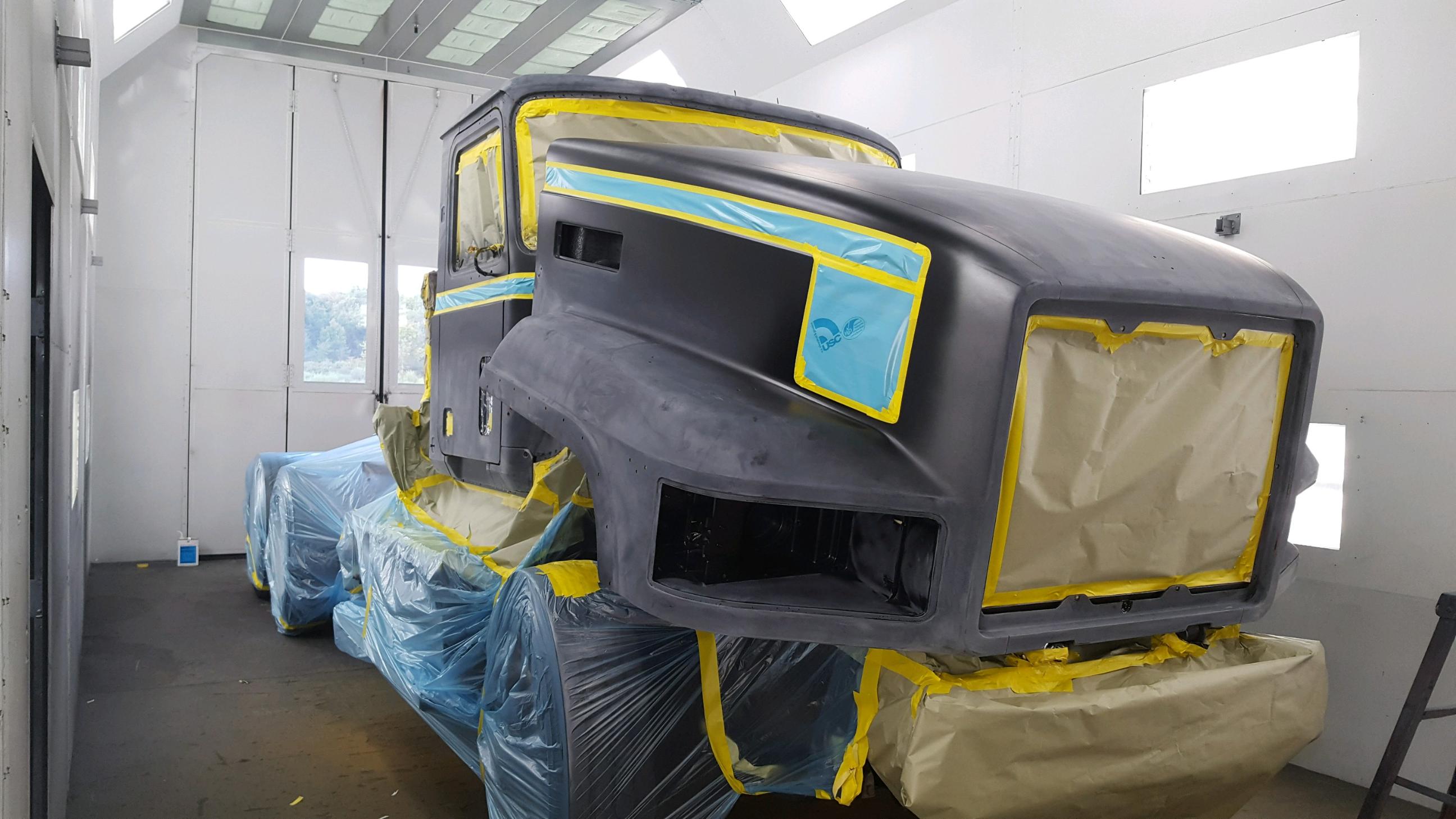

Got my truck back from paint today. It was my first time using this shop and I'm very pleased with the results. Some of you may remember but I saved this truck from the scrap yard. It's a long process but it's coming together nice. Tomorrow I have a smoke test then I'm going to pull the tanks and have them painted to match the cab. The paint is all metal flake with a lot of pearl. I'll have more pictures tomorrow but here are a few teasers.

Wanted good body and paint shop
BGarofalo replied to hicrop10's topic in Antique and Classic Mack Trucks General Discussion
Well I'll let you know in 2 weeks how one of mine comes out. I was in the same boat asking for references and getting quotes. I finally dropped it off for paint on Friday last week. I've seen some really bad paint jobs and wanted to make sure I didn't end up with one. Ultimately I made my decision after checking out his shop and seeing some of the tricks he's done. If your in philly the paint shop is not too far from you. The website is https://www.truckpaintllc.com/ My truck should be ready in about 2 weeks so I'll give you an honest answer. -

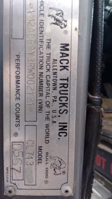

I've noticed that the vin tags sometime have different information. My 2 Macks only have a vin and model. Others i've seen have a date also. I'm looking at a truck and there is other numbers on the tag that I'm not sure what they mean. Could somebody enlighten me? It says D567.
