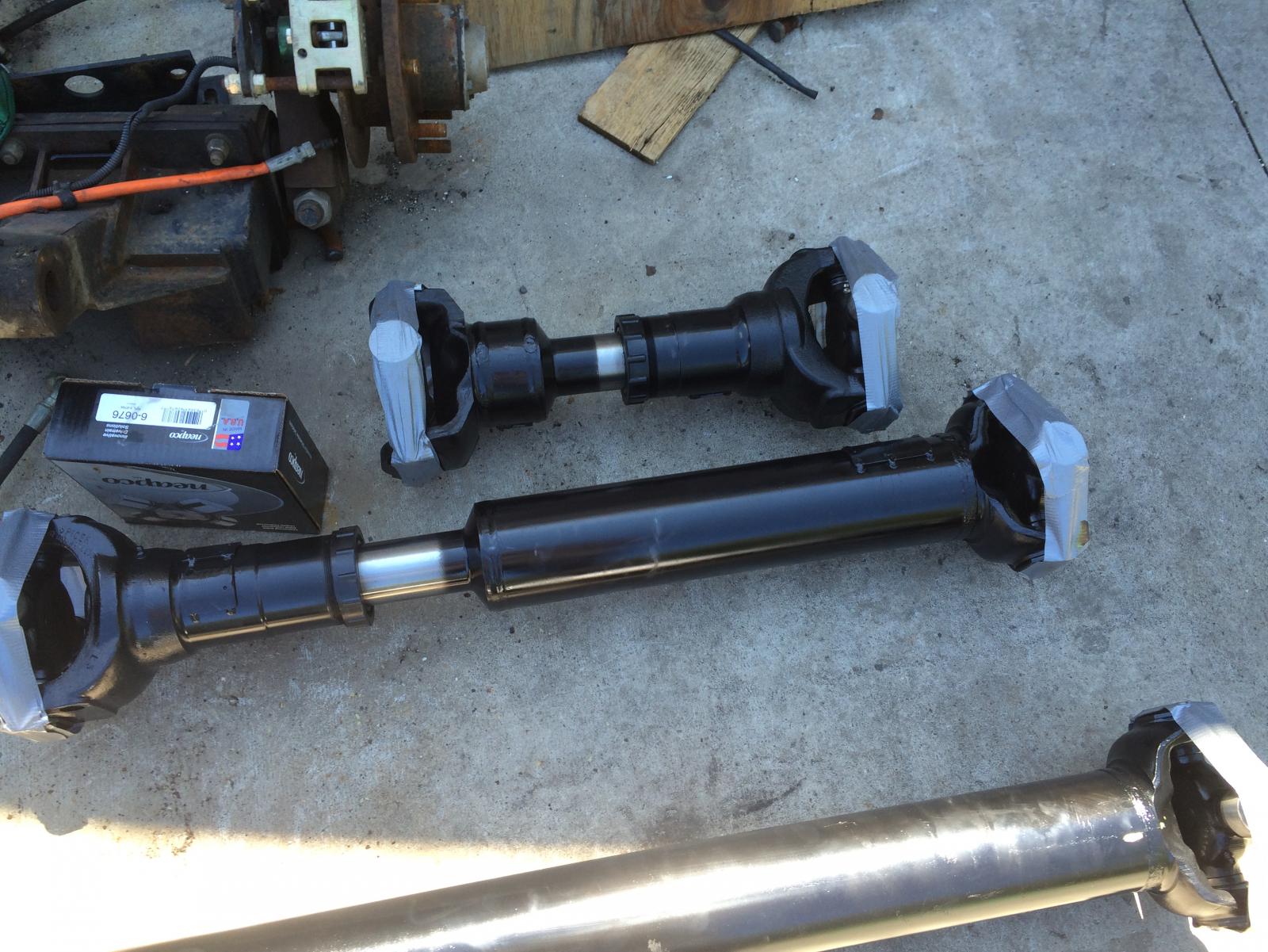

Got the drive shafts in today. I did fresh shafts from the trans back. The first jackshaft is 1810 and only 18". Rear jackshaft is still factory 1710. Didn't test drive yet though. Getting close...

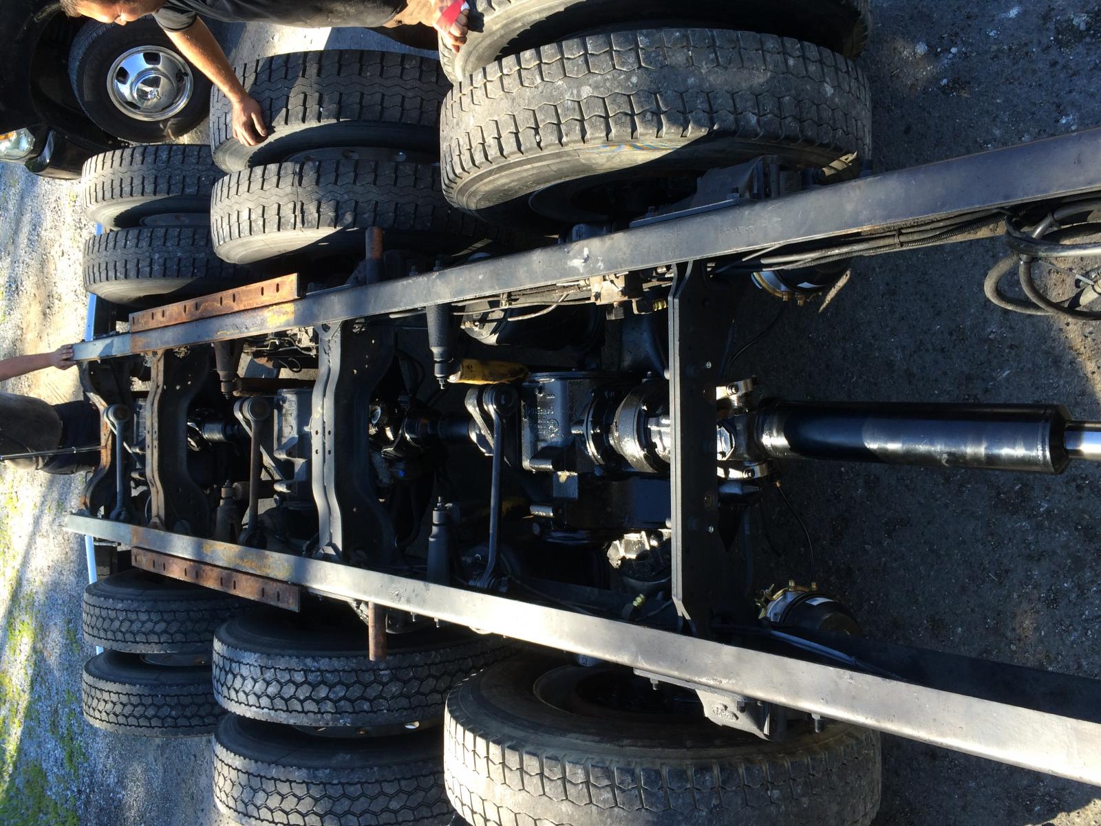

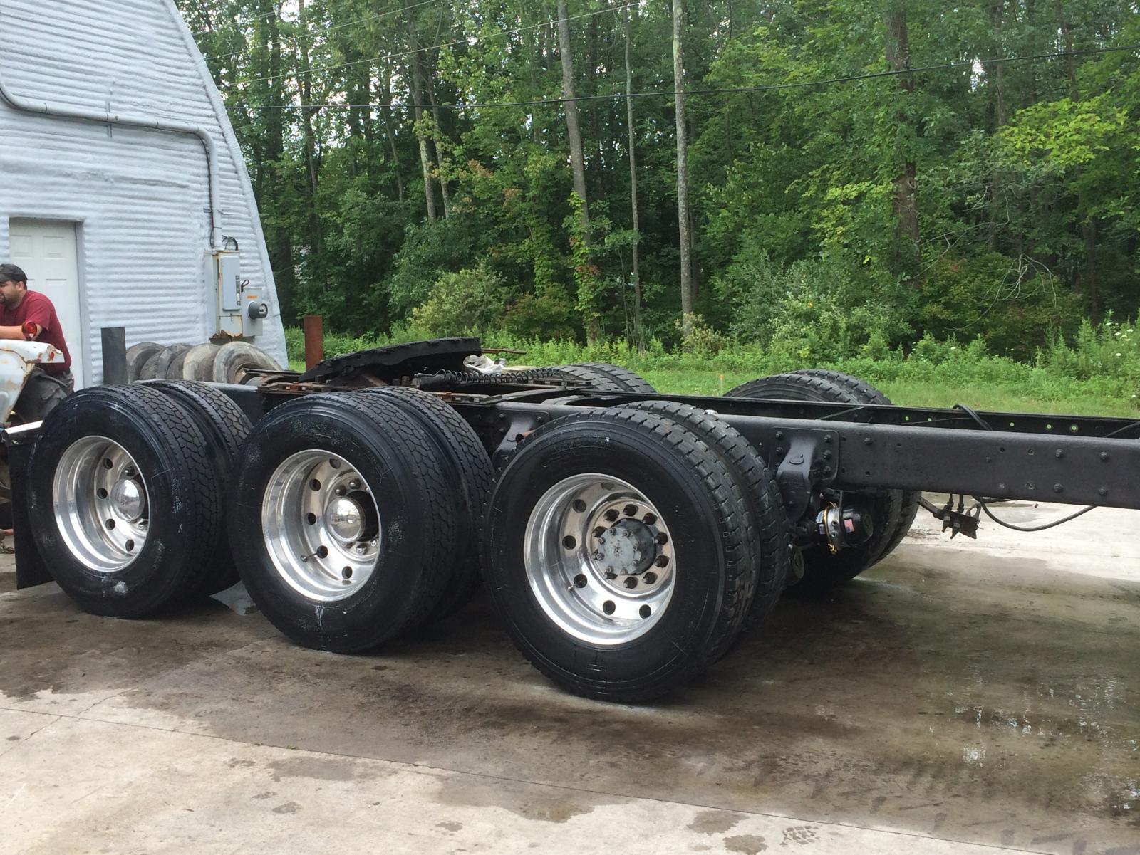

Well, got the air suspension and dump valve all plumbed in. Moved the leveling valve to the mid rear. Lmackattack, that's where I got the idea for using the dump valve on the rear looking at all the newer spread axle trailers. I anticipated that I might loose traction with the rear-rear at no pressure that's why I spent the extra time and money finding an air lock power divider for the new axle. I only use this truck for a hobby so I stuck with 54" axle spread so it looks symmetrical. You would probably have to go to a 60" spread on non-Mack axles. The new rear went in front of the original bogie. Its cheaper and stronger than adding frame to the back.(need to change 2 carriers if adding to the back). Here is a picture from a different angle. Ill update again when the drive shafts are ready. With an air lock power divider feeding another airlock power divider the first jackshaft is just under 19" long

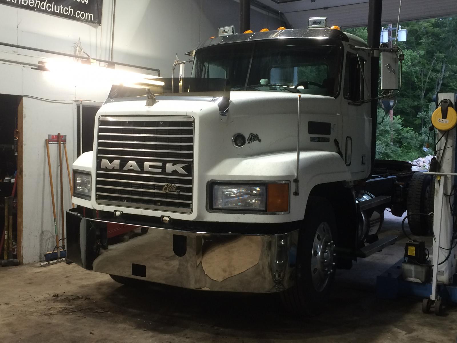

Correct two fronts and a rear. 3.65 ratio with air shift power divider. I don't think turning will be too bad. I am plumbing a dump valve in for the rear most axle to help with tight maneuvering. Should act like a shorter wheelbase. Just patiently waiting for the drive shafts to come back now. Mounted the new bumper a few days before the rear went in.

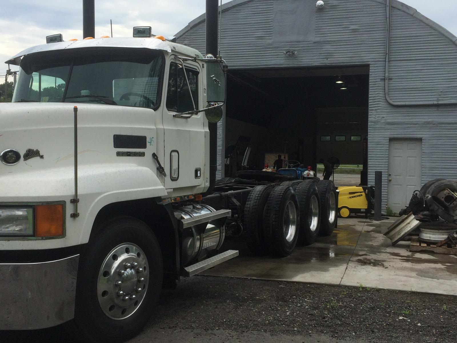

I finally had some time to work on my project truck so I figured I'd share with my progress. Im making my CL into a live tridem. Some may ask the question why? Well, the simple answer is I can and I wanted too! The hardest part is getting all the pieces together so they match the originals. Here is a picture of where i'm at now. I just got the rear mounted. Still have a lot of stuff to do but it finally seems like its moving along.
