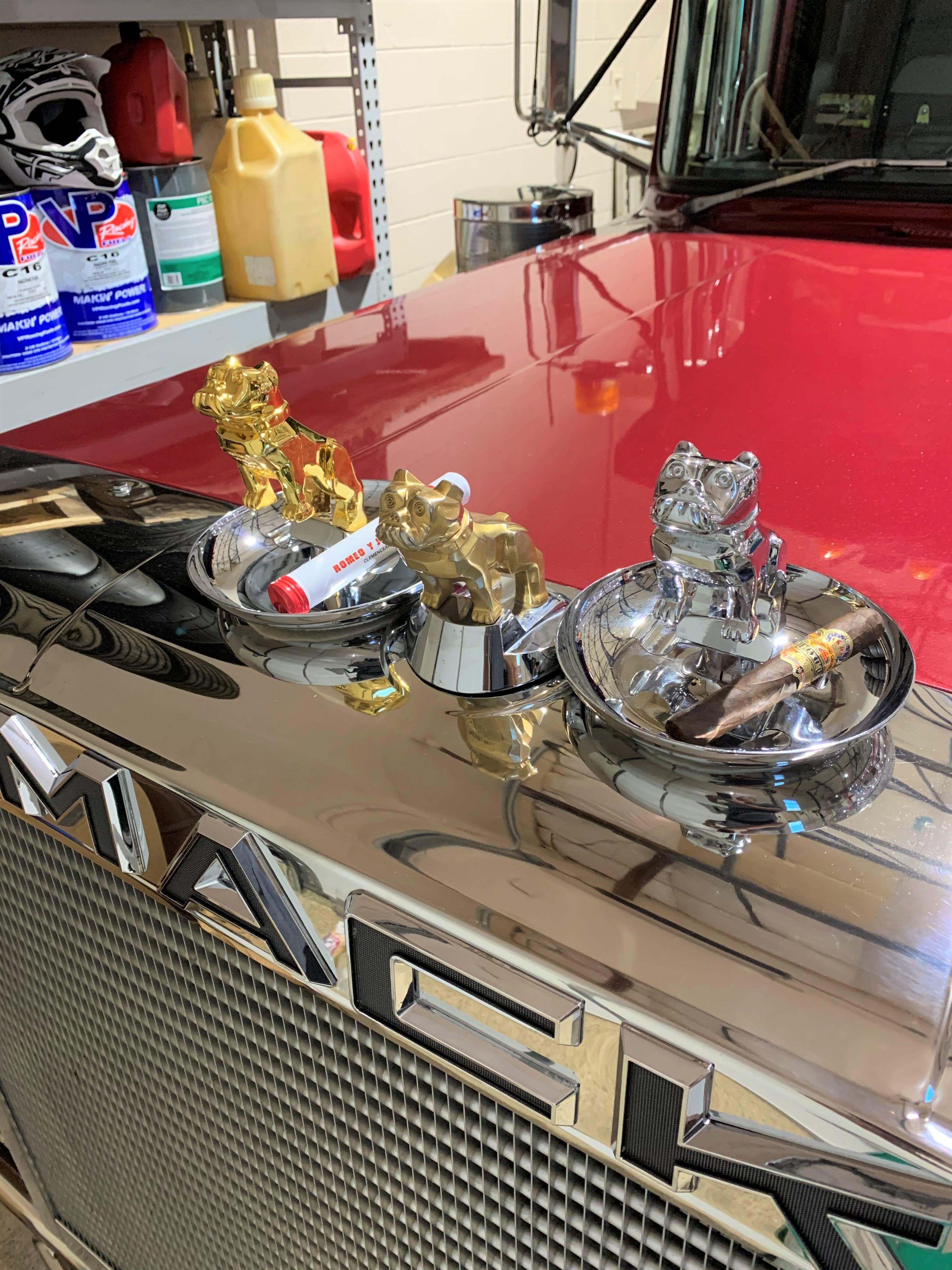

Gold Bulldog
AZB755V8 replied to Brian L Blaylock's topic in Antique and Classic Mack Trucks General Discussion
The bulldog was done both ways, Gold Plated and Painted. The best bet is a perfect one is on an ashtray. Both big and small bulldogs are on the trays. If the finish is shinny it is Gold plated. Brushed or matt finish, Painted -

can someone tell me if the gold bulldogs color was some kind of plating or were they painted gold thanks in advance
