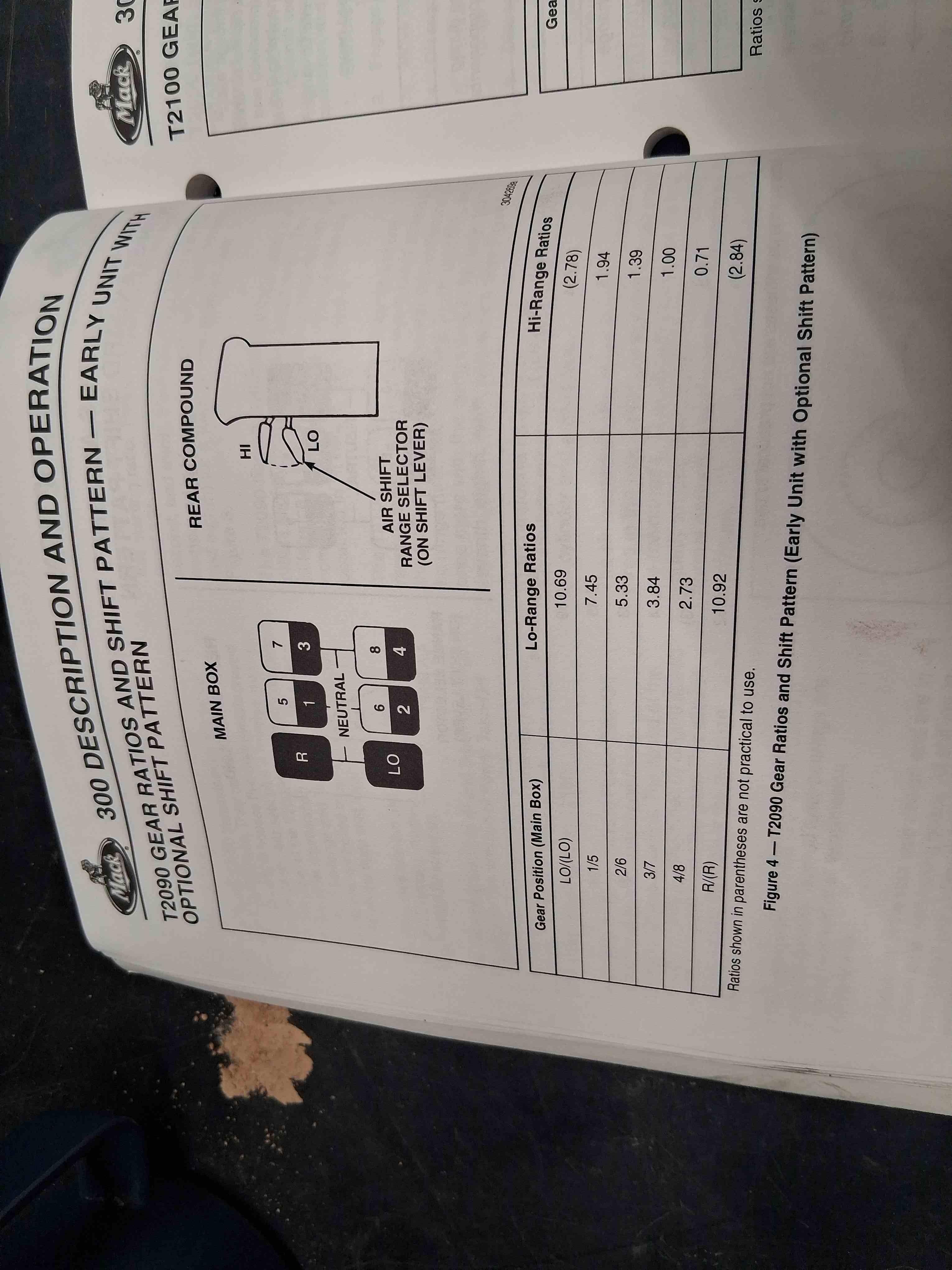

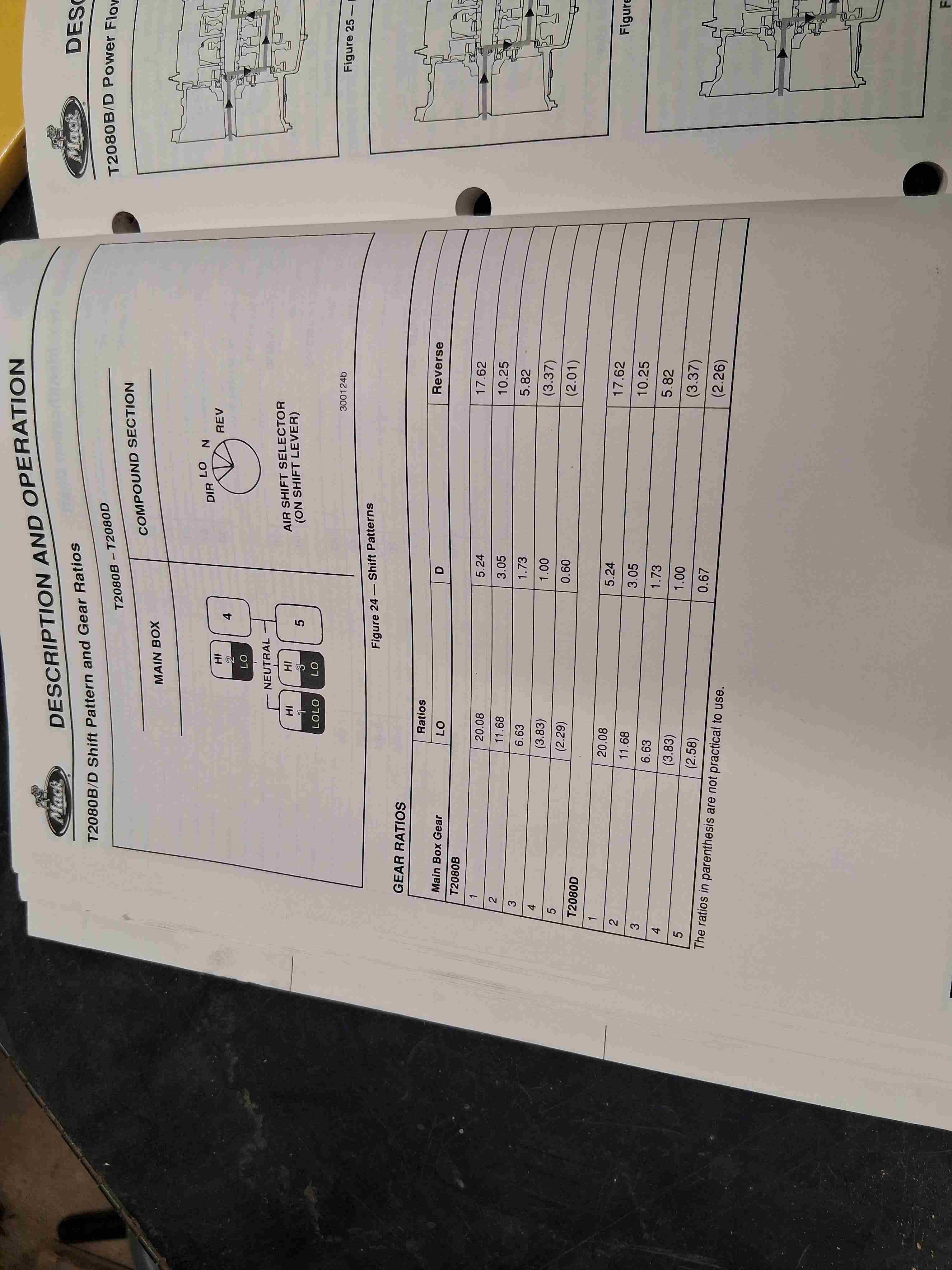

1 hour ago, Joey Mack said:
I thought I would post these to help you know the ratios.
I think what he needs help with is the torque rise of the engine in question, and why some need close ratio steps and others in the Mack family can work with wide ratio steps. The engine torque rise has to work with the steps between gears.
You know Mack engines better than I and can advise.

A 14069B has a low of 12.57 Where as a 15618 has a low of 14.71 so that is not true. However what the low ratio is doesn't tell the whole story, it is the steps between gears and what the power band of the engine is that will make or break the set up.
An Eaton 18 has a low of 14.71 and a top of .85 with 17 steps between
The Mack 2080 B has a low of 20.08 and a top .67 with 7 steps between.  Each step has to be huge to make that spread, and if the engine isn't built to allow that RPM drop between gears it will lug and may not even make enough torque to get to its powerband to be able to use that spread.
