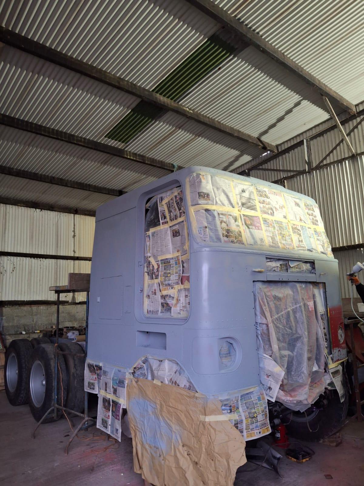

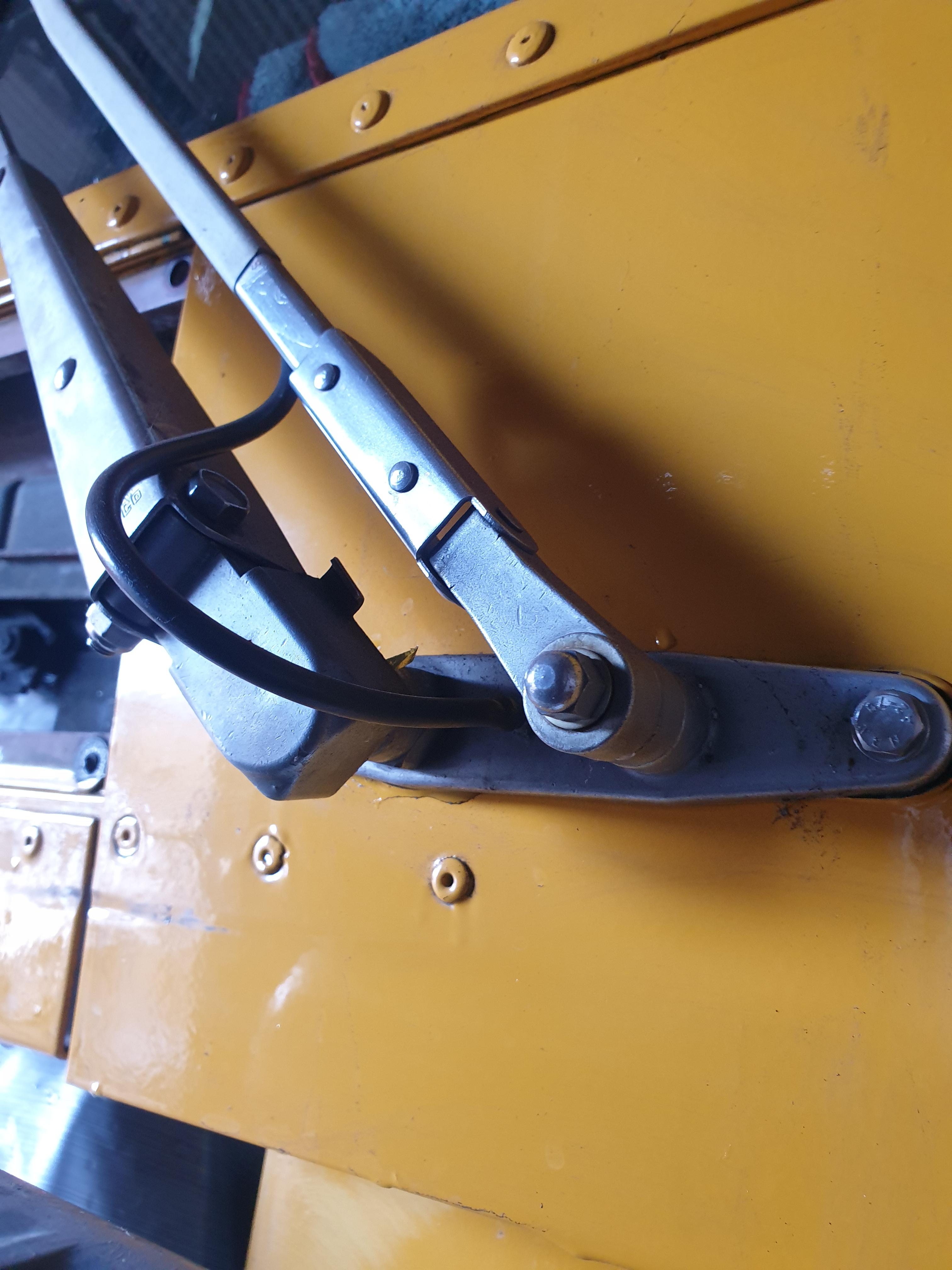

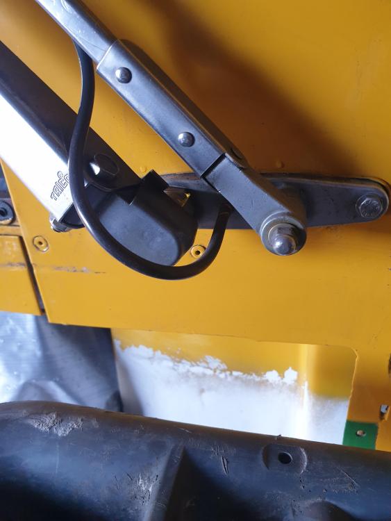

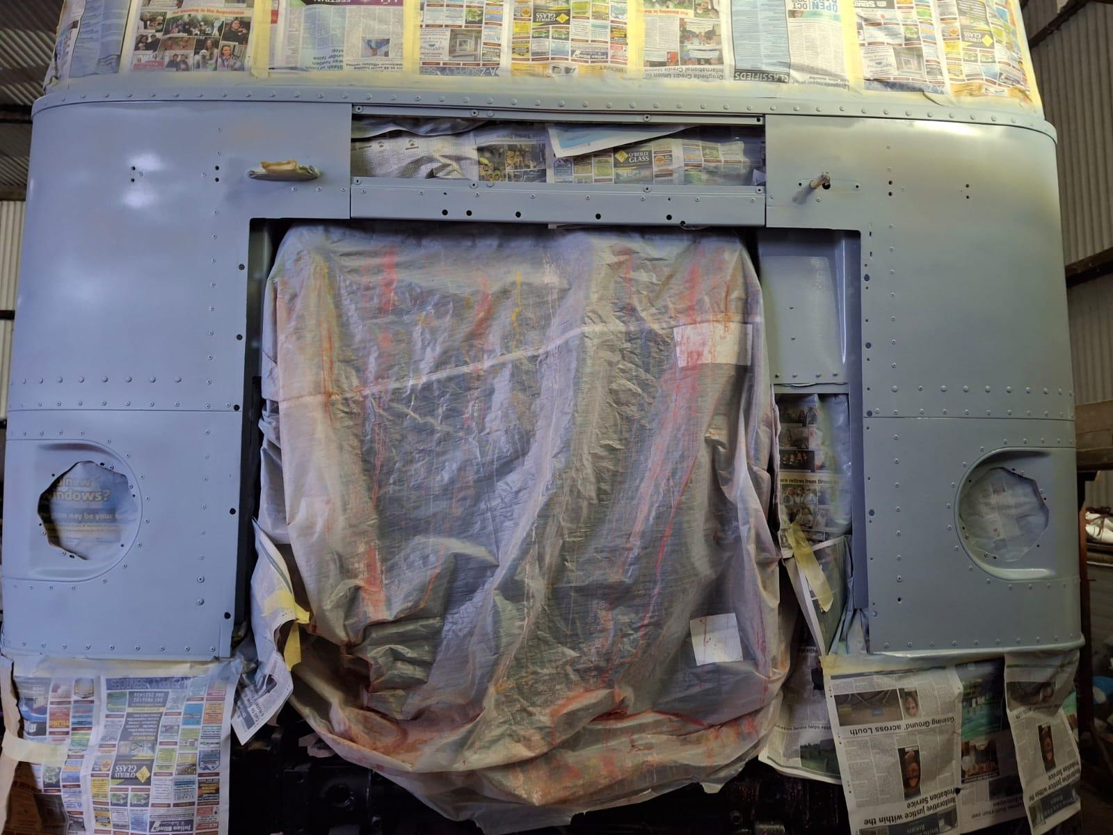

Hi all, work has been progressing on the Cruiseliner but much slower than we hoped.I dont think Iv ever done so much sanding filling sanding and more sanding....sanding around the rivet heads is a real pain!!!! Still hope to have the cab in primer by Friday/Saturday.Now is the time for me to commit a crime as Iv no fingerprints left🤣🤣🤣 Its amazing to put in so many hours then stand back and see little or no change.....A quick question,how are the Trico wiper arms removed? Might seem a dumb question but Im told parts for them are hard to come by so I dont want to break them so Id rather ask.So far they have refused to budge ni matter what Iv tried.Heres a picture of them......
The fat arm has the catch there. Pull the arm away from the windscreen and pull the tan outward to hold the arm out, and the other looks to have an acorn nut . With that nut off, can you pry that arm off?
7 hours ago, Joey Mack said:
Wonder if there are timing marks on the stem and arms ? You may want to mark them somehow.
Thought there might be so iv marked them already....thanks
Paul
Can you get some of those gas heaters like this
0B850294854B09B2574A9F32ECA3C424653726EAF06A1C125B8DC4158A670096.thumb.jpeg.7922f67859d398e6c27463b3dde2b627.jpeg
Might take the chill and moisture out of the air enough to spray
I guess as you head into winter the opportunity to paint is getting less and less

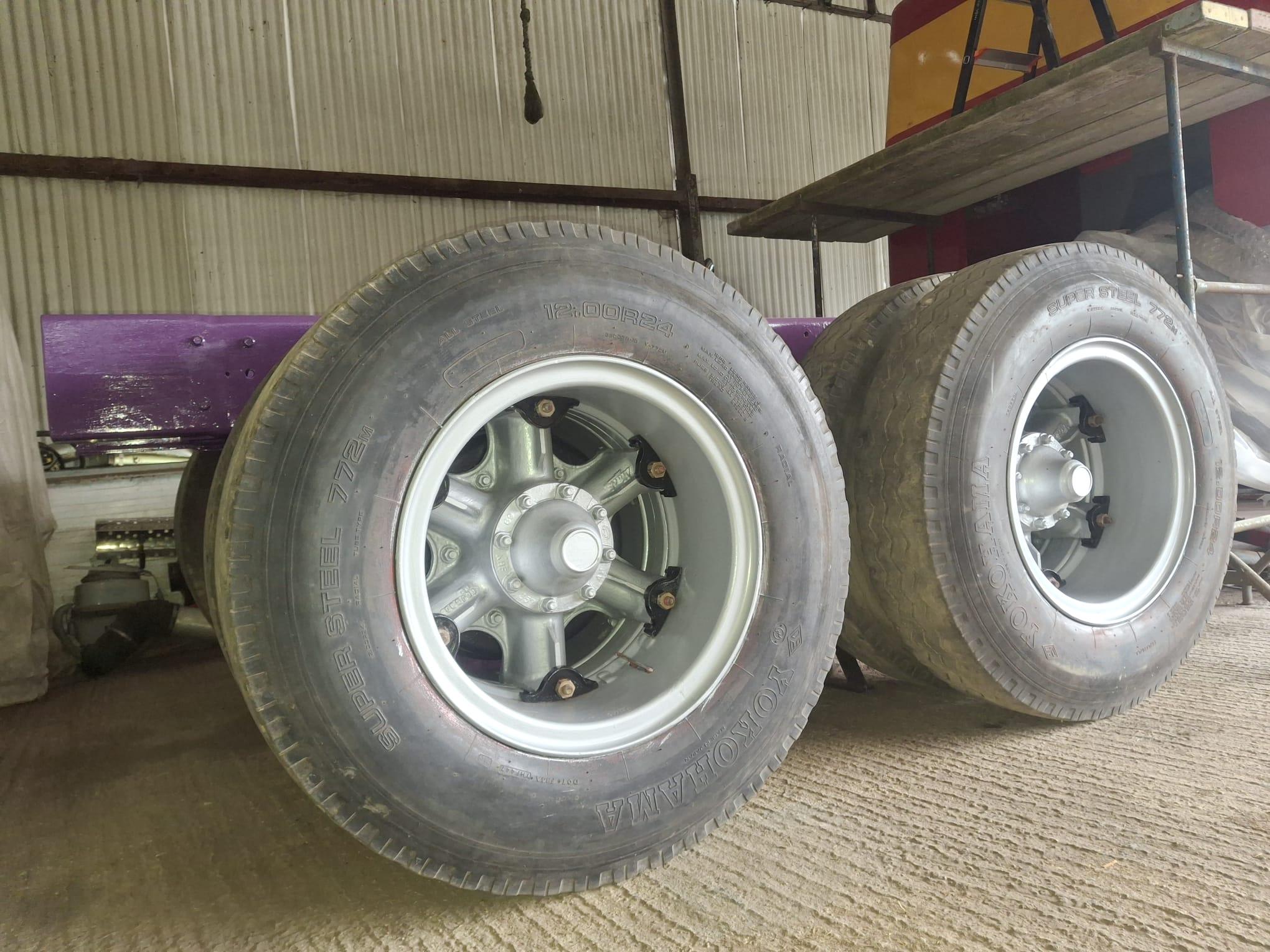

You can still buy tube tyres out here but they aren't very common and probably not in your sizes
10.00 x 20 is the most common then dropping off in size
