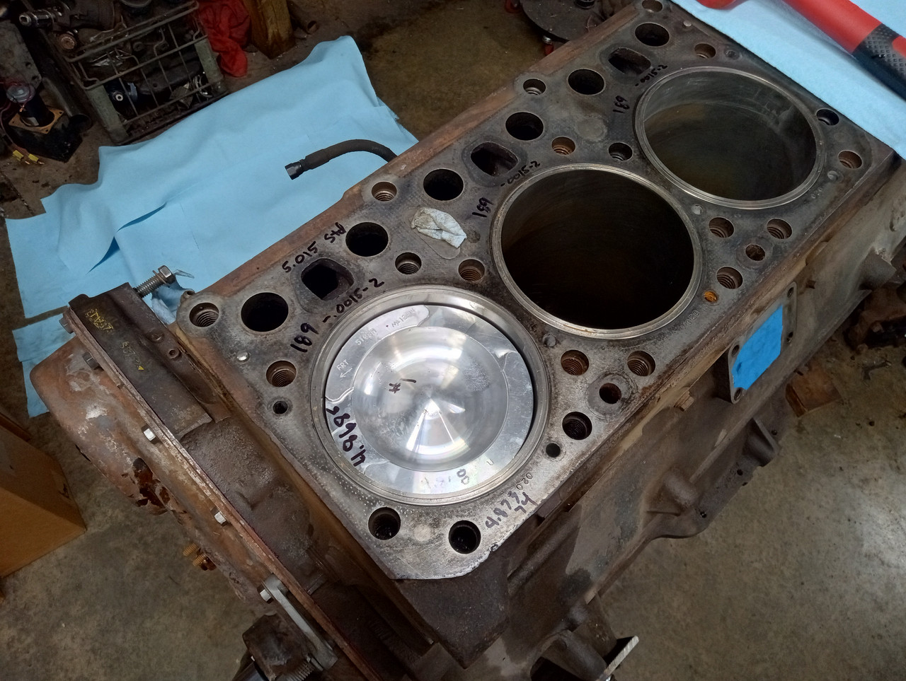

0.jpg.40c3253fa755d0d8b205f49e0e790113.jpgimage.thumb.jpeg.9533e0fc5dc7108e9a1f56b7aac7b68a.jpeg
Paul,  here is one I did in my modest shop a few years ago.  A BMT brother needed an engine, so I went and picked one up that he bought and did a full build.
Love to have the tools and knowledge to turn out an engine like that.I know where there is a 350 tip turbine about an hours drive from me.I was thinking of getting it and doing a rebuild on it but dont know if I have the guts to take it on.....
Paul
https://www.bigmacktrucks.com/topic/75768-300-rebuild/page/20/#findComment-589115
I may be repeating myself here, but I have the tools because when I was with Mack for 10 years, i became one of the Go-To Engine guys. I would buy tools or make tools for my personal use. As well as buying books. Fast forward 15 more years, and all of the tools and books afforded me the ability to build these engines and a couple others at home in my modest shop. I am not a machinist so that work is done outside. The only machining I can do is cut counter bore shelves in mid stop bores, like E-6+E-7's.
Paul,   I think you would like to do that engine job. And yes tools get expensive quick.
