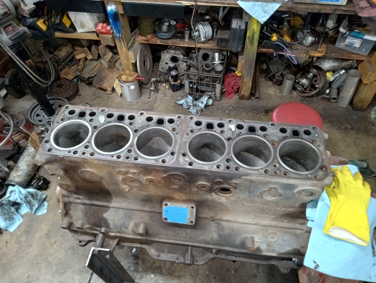

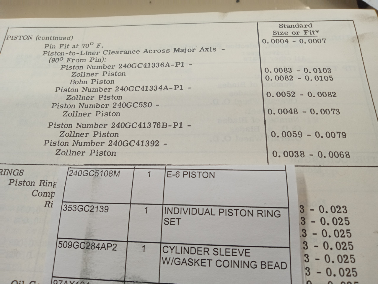

So here's a technical question.
Book calls for bore to be 4.875.  My liners had a bit more shrink then then needed and it tightened the bore a touch.  4.8735-4.873 (almost .002).
Bottom of pistons are 4.865-4.866.   The book lists like 4 different pistons and 4 different tolerances.  From .0045 to .009 clearance depending on piston.  None are what my part number is on my piston.  So, is .007 clearance good?  It's in the middle.  I'm not familiar with big diesels, so I'm guessing it would be fine.
Going by my mics, the wrist pins have about .0003 extra clearance.  I think .0004-0007 is what it calls for.  Just a quick check on pin bores all were right at .001.  Something this big I don't see it as a huge issue.  The rod bushing look near new.  No odd wear patterns like the rods are bent.  Those tapered  bushings would be a PITA to replace and hone.
Thoughts?

One thing I remember is that liners have a .002" crush when installed. That said, i never measured the pistons, when I had correct part numbers. As far as wrist pin bushings go,  i do slide the wrist pin in the bushing with light coating of oil. I guess i developed 'the feel' for the fitment. I beleive the clearence fro them is .0015" .
I hope some of this helps,
https://www.bigmacktrucks.com/topic/75768-300-rebuild/page/18/#findComment-588794
I'm just measuring because I can just to see what it is.
Talking with my friend at motor shop, he says a 2" pin should have about .0015 clearance.  It does.  Piston is in range also in general terms.  A thou one way or another shouldn't make a huge difference.  I'm not "racing it" or turning excessive RPM.

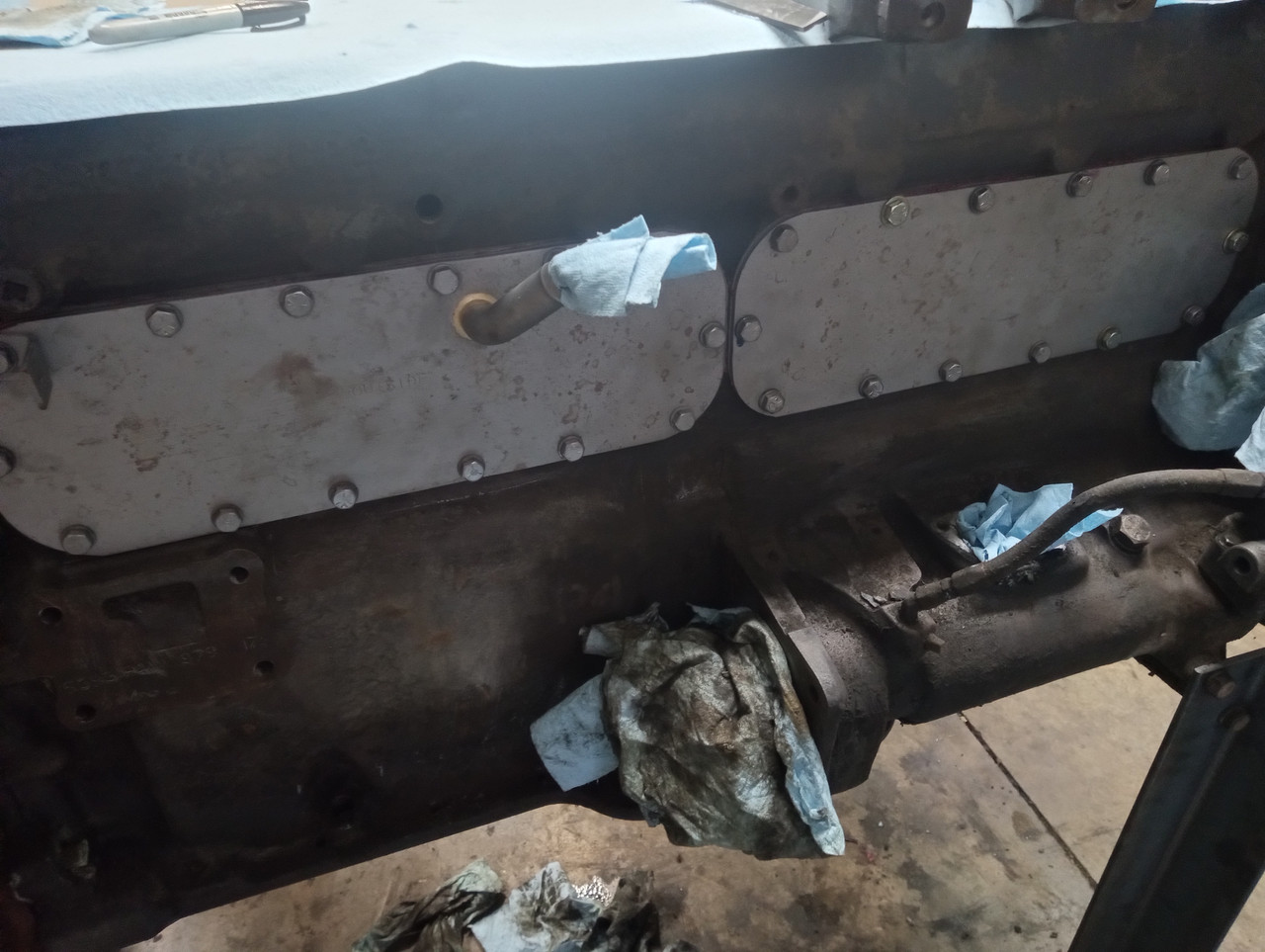

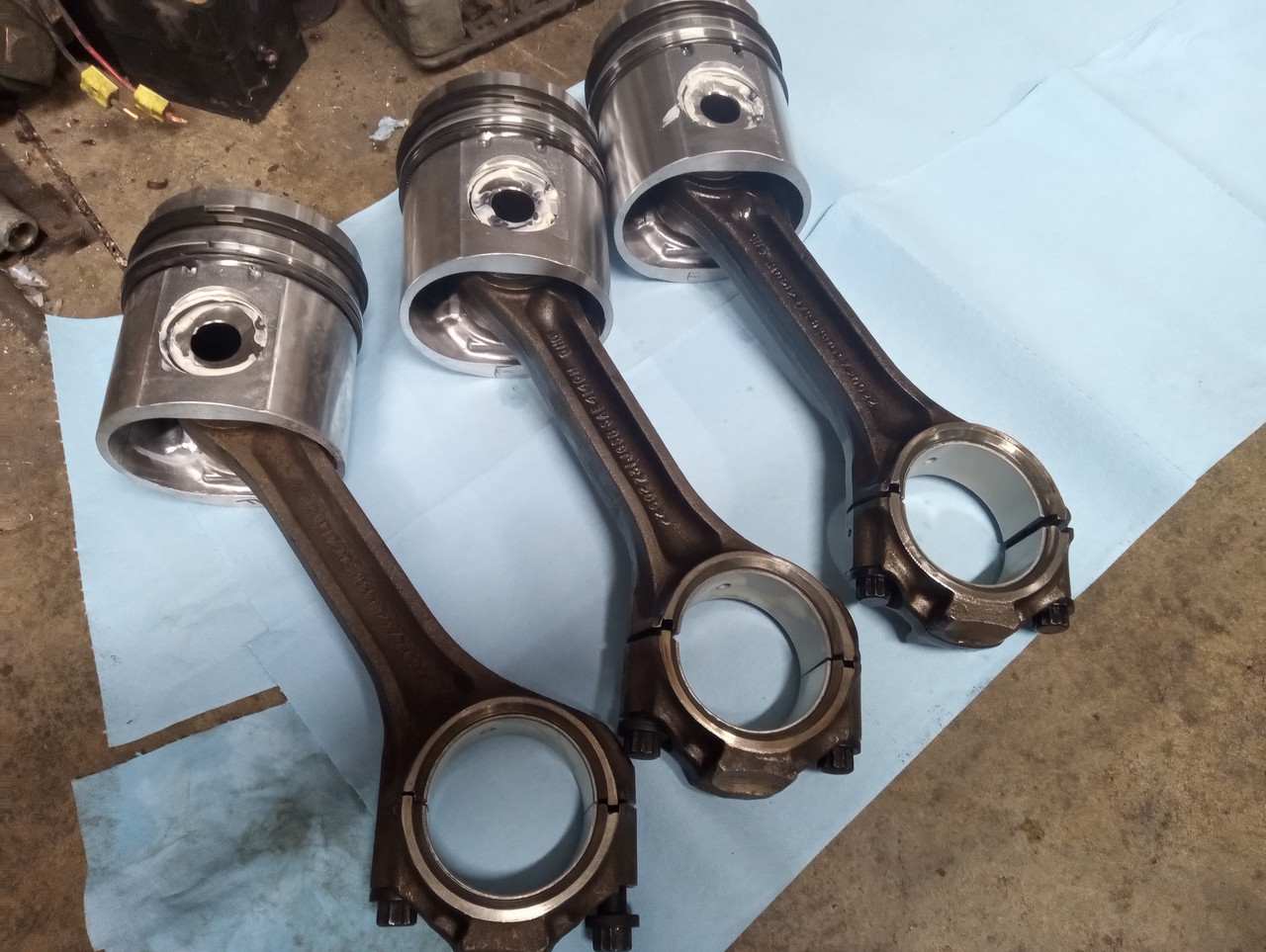

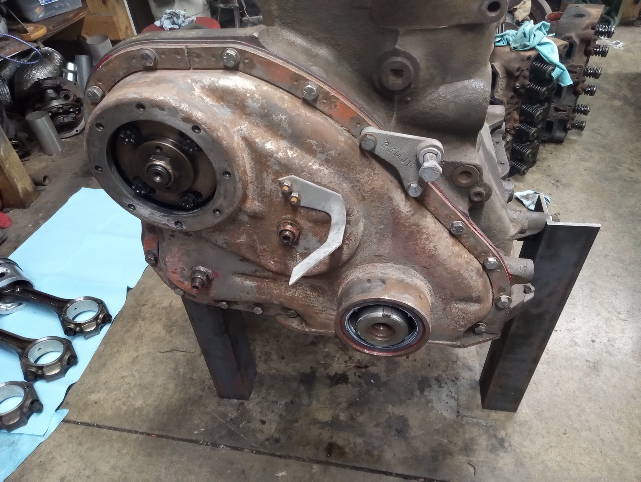

Chipping away.  Have three rod assemblies ready for install.  I had to file a few rings to get to minimal .013 ring gap.  Might have been "ok" but I gave it a few more.  Tolerance is .013-025.  Last thing I need is to break a ring due to closure of gap.  Yikes.
Got front cover and side covers glued on.
All bolts call for "nylon", so they got blue loktite.  They had blue residue on the threads when I cleaned them.  Using High tack on gaskets so they should never leak!
Will finish cleaning the side of the block below the covers and around accy drive.

Ok, can anyone tell me what piston I am using compared to chart in book?
I am still questioning the clearances.
I am in the .005-.006 range.  Hate to find out I need .010!
Larry
https://www.bigmacktrucks.com/topic/75768-300-rebuild/page/18/#findComment-588848
I dont know, but it looks like the range is .0025" avg.  Does measuring the new bore and the new pistons give you the answer?  I should assume you did that.  Sorry, scratching my head too..  I hope another guy sees this to answer you.  Maybe, fjh, or mechohaulic, MarkT,  ....
https://www.bigmacktrucks.com/topic/75768-300-rebuild/page/18/#findComment-588852
I'm just concerned because the bores are -.0015/.002 undersize currently.   It would have another .002 clearance if the bores were "on size".
The new piston number doesn't mean anything to me and of course it doesn't match the 50 yr old book.
