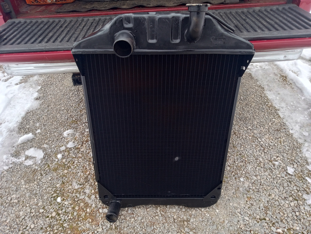

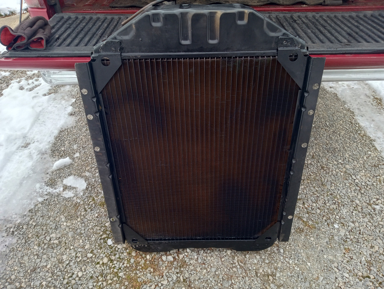

I am not holding my breath until I get a price.  It won't surprise me if it is crazy.  But this is a very small radiator compared to an R model.
The original has worked flawless for 25 yrs.  Even on the biggest, longest grade I run it just gets to 200* and just holds it.  It is a 9* grade in Pennsylvania.

6 hours ago, mrsmackpaul said:
I reckon it's cheap insurance on a good motor
I got the R model done, it was crazy expensive, I think all Australian Macks of that era came with the biggest radiator you could get
I can't remember the exact price, but it was over $5000 Australian
Back then, with the exchange rate it was about $3600 US
You probably felt the earth tremor when my jaw hit the ground
But compared to the cost of a motor it is cheap
Paul
Late 2000 teens, I had a recore on my 9670, and it cost $2150.00so not at all surprised by your figure. It wasn't the biggest radiator IHC put in that truck either. I'm sure the biggest would be close to what you paid.
add $400 to that price for the used radiator I bought to start the project.

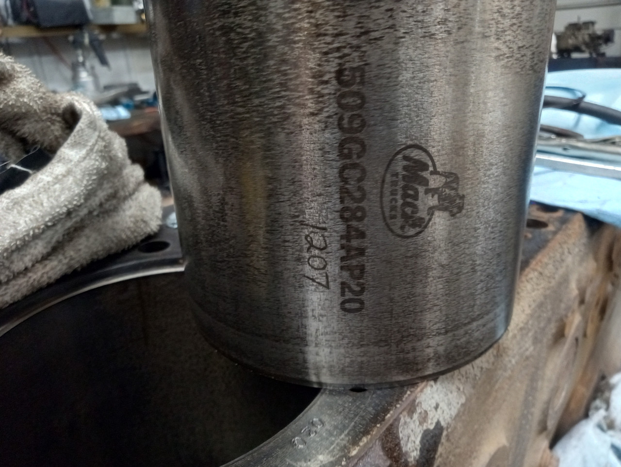

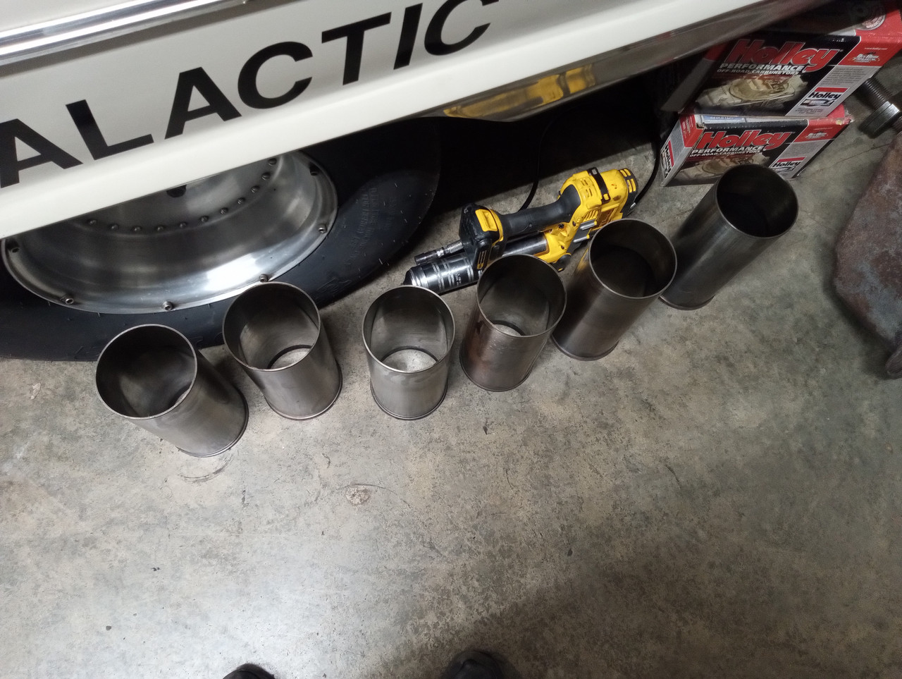

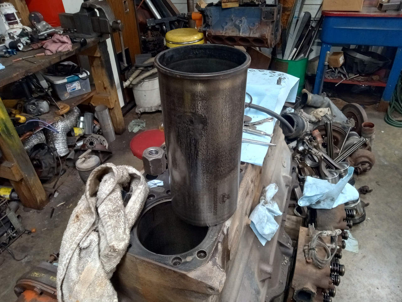

You can buy 20 thou over sleeves in Australia off the shelf
So I reckon it won't be a drama in the U.S. as ours probably come from the same supplier
If the link works in Yanky land you'll see STD, 6, 12 and 20 thou sleeves
Cylinder Sleeve For Mack Engine E-6 2VH/4VH - MaxiTrucks https://share.google/H24bIClcGFfCC1rKZ
Paul

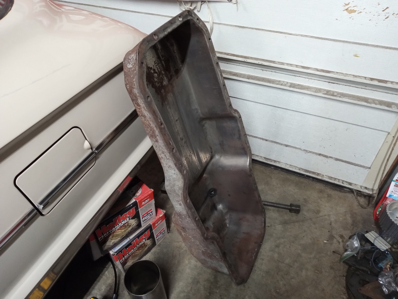

21 hours ago, mrsmackpaul said:
I assume the oil pickup is different on the bigger sump ?
Might be worth looking into
Paul
The sump pickup is the same.  Unlike a car engine where a deep pan usually takes a longer pickup these engines use the same.  It just has more volume to pull from.
Larry
