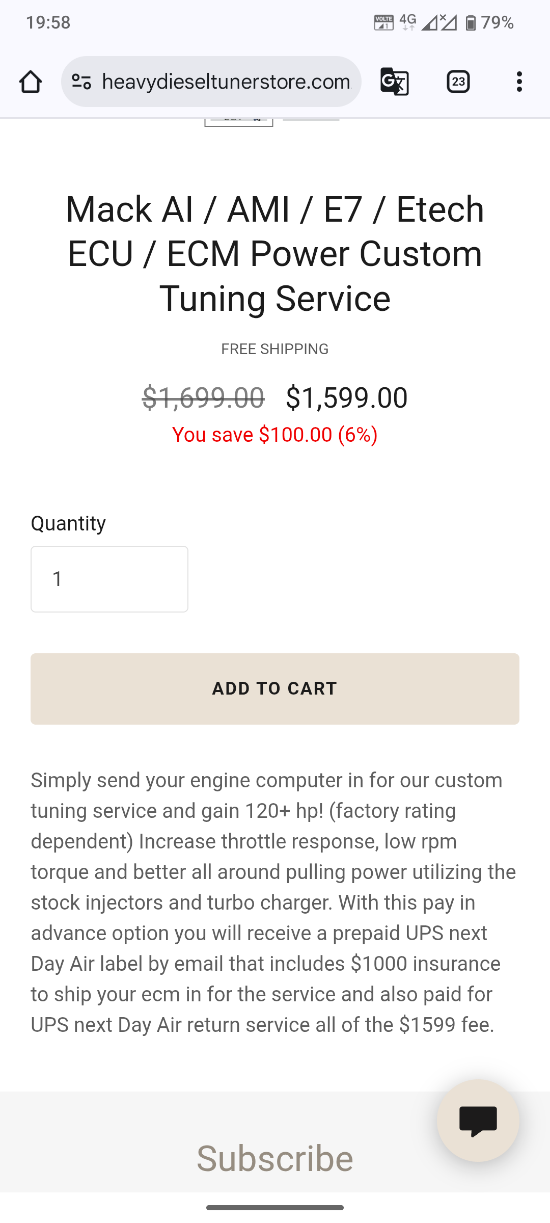

dieseltuner out of Tennessee says he can reprogram my ECM to 525hp with no mechanical upgrades needed.
is this realistic and has anyone here done that?

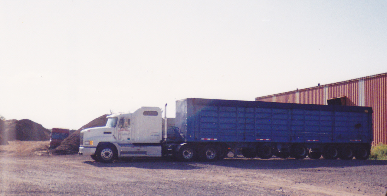

@Shadyacresmack Is it the truck in the pic? It has 460 on the door. Engine or door swap, or did you mean 460? 460 to 525 with ECM tuning is possible, maybe. 400 to 525 with no hardware upgrades isn't.
 Is this old mate who's told you he can tune it 120hp+ with no hardware upgrades?
Personally, all I can see happening from a copy and paste tune, is that it'll burn up your engine, and your wallet. If he said " bring your truck in and we'll tune it on the dyno" then maybe you'll have half a chance at a decent result.
