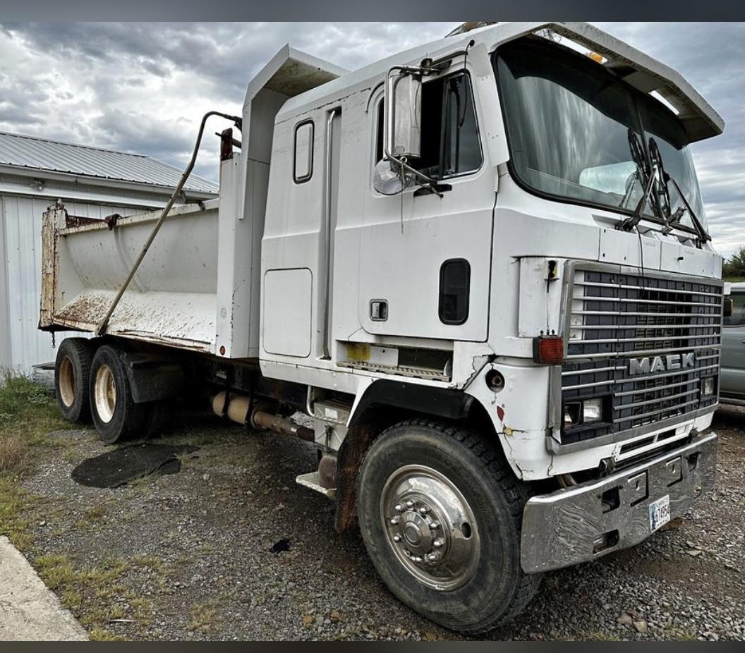

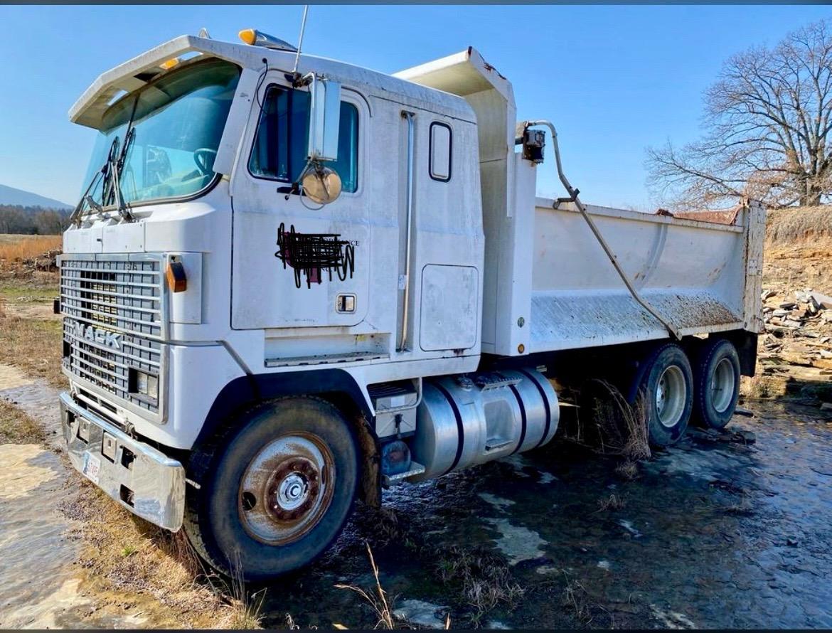

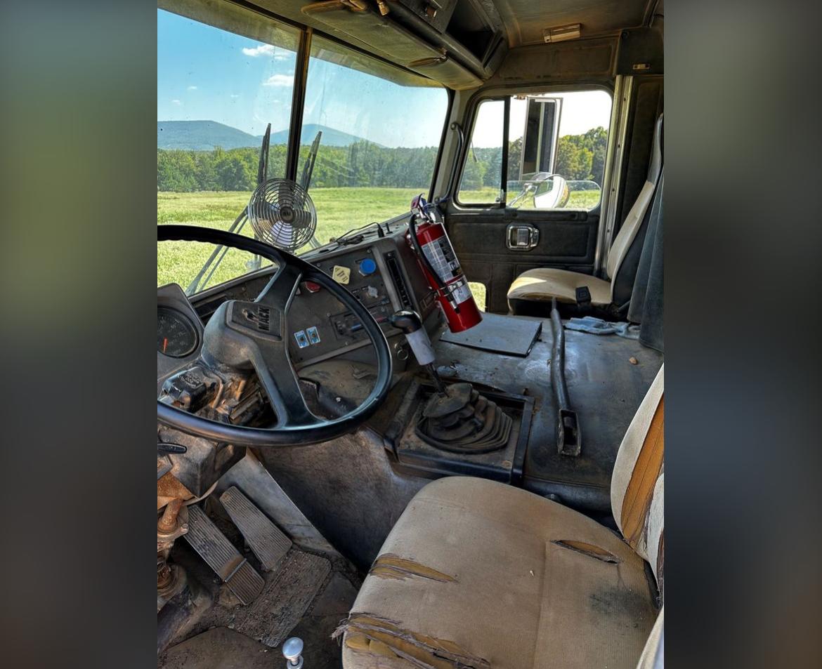

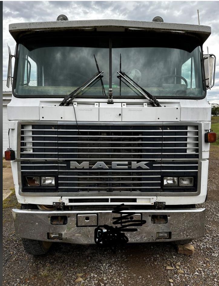

Got some pics today. Its on facebook but I don’t have facebook so a friend sent me pictures. Ill post some for all to get a look at. The front turn Signal/marker lights are broken out of the body or cab panels and hanging by the wires. That concerns me about the condition of the fiberglass cab as a whole. Im not worried about making repairs and fixing tge signal mounts really but is it an indication that the fiberglass cab as a whole is too old and brittle or bad and is going to break apart somewhere or everywhere else?  It says its an MH-613. Is this what is called an ultraliner? It does say runs and drives good. Thanks again
Josh. IMG_3890.thumb.jpeg.0a9d04a97c0ee8cbba74a6aacfb021f3.jpegIMG_3889.thumb.jpeg.a6e89c863d3a786a1121935139ba01fc.jpegIMG_3891.thumb.jpeg.25be212713a74a1dd87a27f564ac4446.jpeg

1 hour ago, 70mackMB said:
The picture that is straight onto the front. What is wrong with the drivers side steer wheel? lt looks to be up and back as thou it has been hit.    .....Hippy
Looks like someone has a brick or something in front of the tire, like a wheel chock.   That old girl don't look too bad.
I wonder if those panels where the front signal lights mount are replaceable or could be found? If the fiberglass or plastic the cab is made from is good for many years? Been hoping some MH pros would stop by. Lol. Im negotiating tge sale of an old pete project truck i have and if it goes through I’ll go see this truck with cash in pocket.

That body looks kinda nice. I'd think whoever put it on that truck must have figured the truck was in good enough shape to do it.  The more I look at it, it looks to be in way more than fair shape.  I'd imagine some parts will be a challenge to locate. There wasn't a real lot of those even when they made them compared to CHs or CLs .

27 minutes ago, Macktruckman said:
Looks like a filler cap missing for something right in front of the right steer tire?
Thats the windshield washer bottle, most of the time the tanks are cracked on those.
Might look into how to fix some of the fiberglass stuff on this rig. I've repaired some fiberglass pieces on a Corvette that didn't turn out too badly and some shops might be able to remold or 3D print any part you might need.
