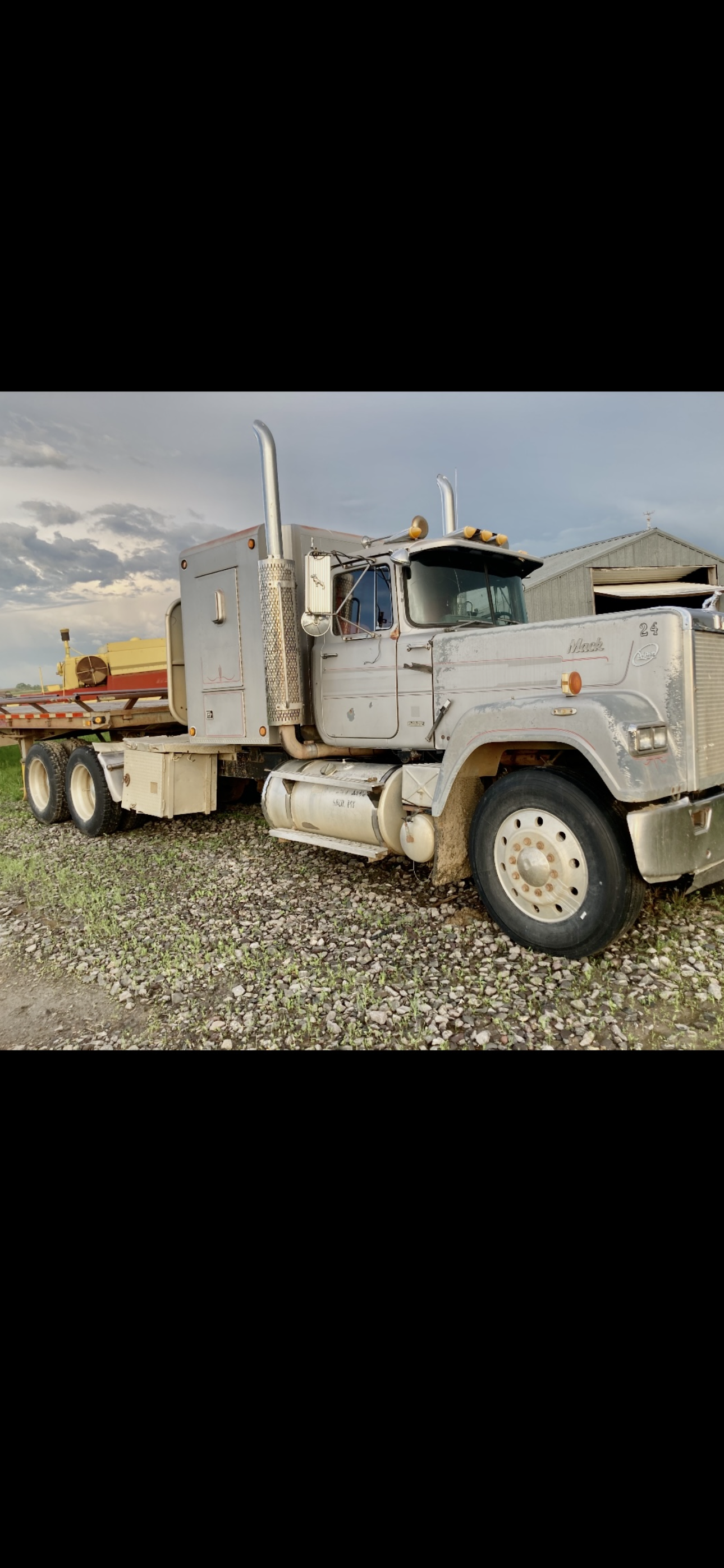

1985 Superliner
after the 70's they were aluminum from behind the cab and back.. I think they were 7/16'' thick...  I have only been around a few of them, certainly not a guru on these..
  • Thanks 1
just proves the fact ;; never tooo old to learn .  possibly why I wasn't aware of combo rails, also back in the day Mack westerns on the east coast were an extremely rare Dog. did prep for delivery a F-700 western having the 866 v-8 and alum rails = full front to back alum
