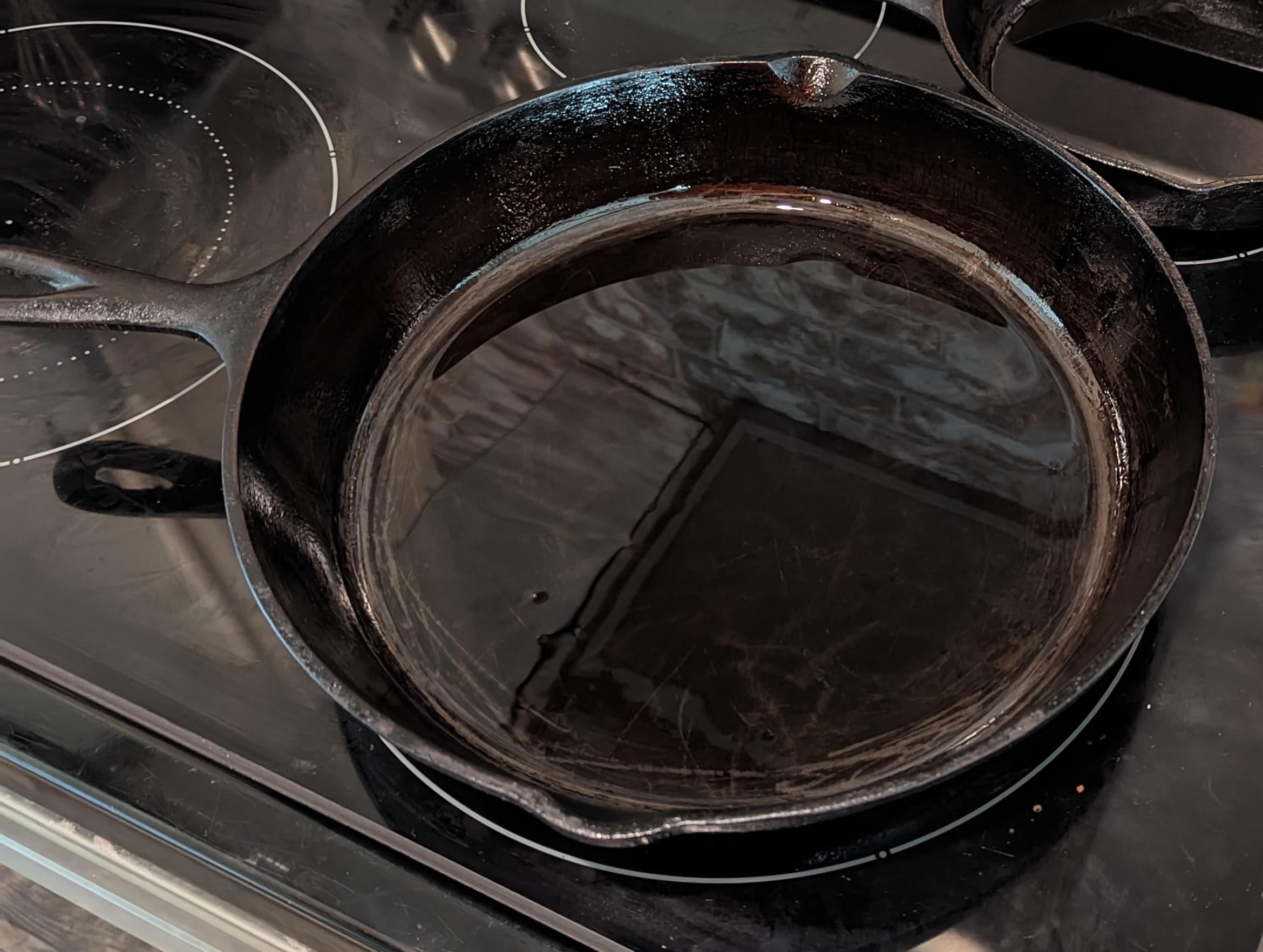

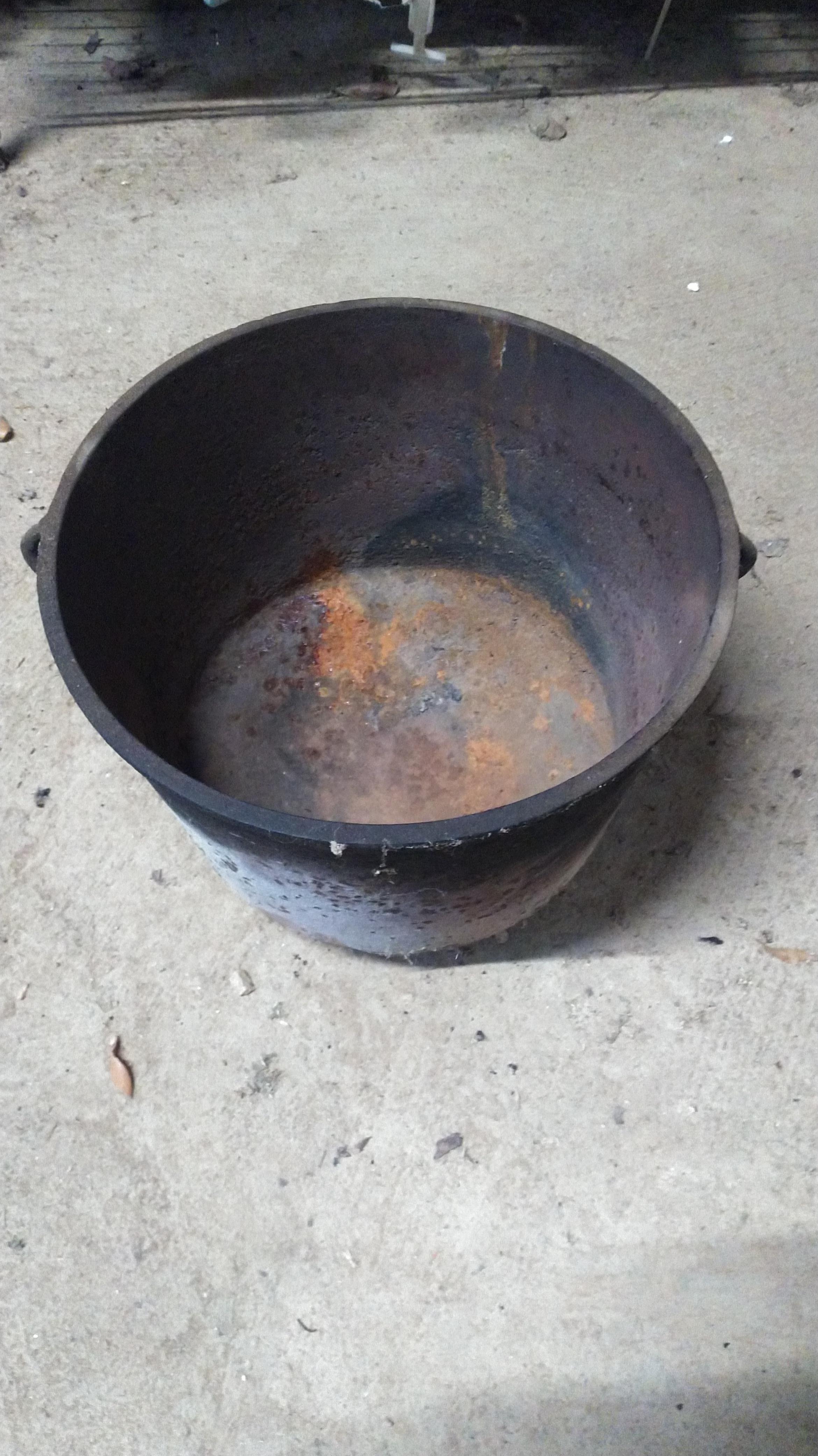

O.D.,,,  I have a few OLD cast iron pots that are rusty..  I was thinking about using my blasting cabinet to clean them, then start over and season them... What are your thoughts on using the blasting cabinet... I was thinking about doing one of my Chinese pans first, as a tester..

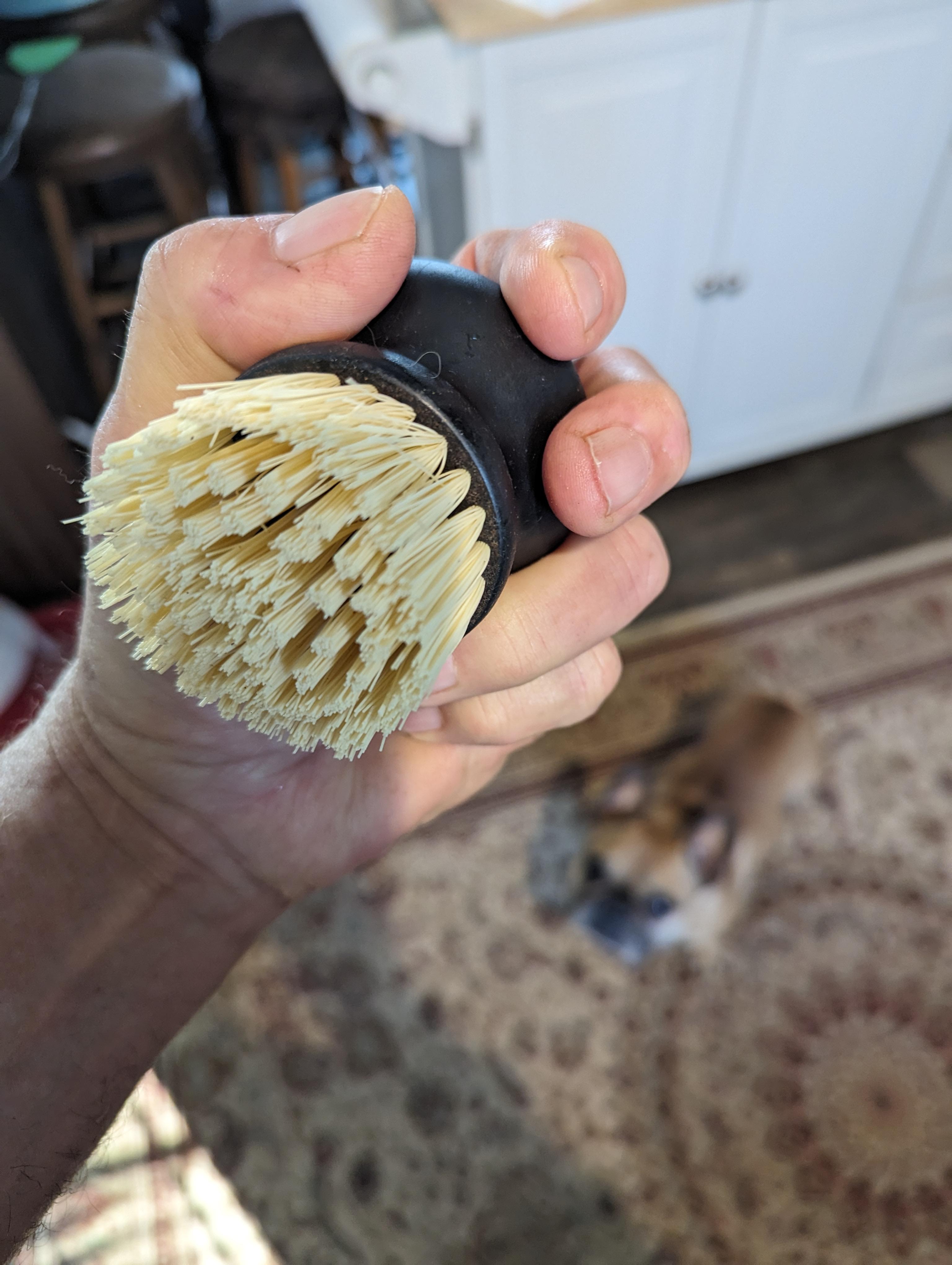

This is what I'm going to wipe it out with first, easy to grip and hold too.
tjc think jojo is under the impression you are joking. I know the walnut shells are used a lot. never heard of the baking soda . would the two be used separate  or together??  that would be a lot of baking soda . fine grit blast sand  maybe depending how bad pots are. and size /pressure of blaster.
No,  I know what hes saying..  Its just that my cabinet is large and the sand hopper is as well.  I would have to flush out the cabinet and replace the media, then do it again when Its time to do my typical work..  Its all good,,  yes the sand will leave some residue..  my thought was to blast them, wipe them out will corn oil then bake them on the grill for an hour, then re-season them..   Just having a little fun here..   :) jojo

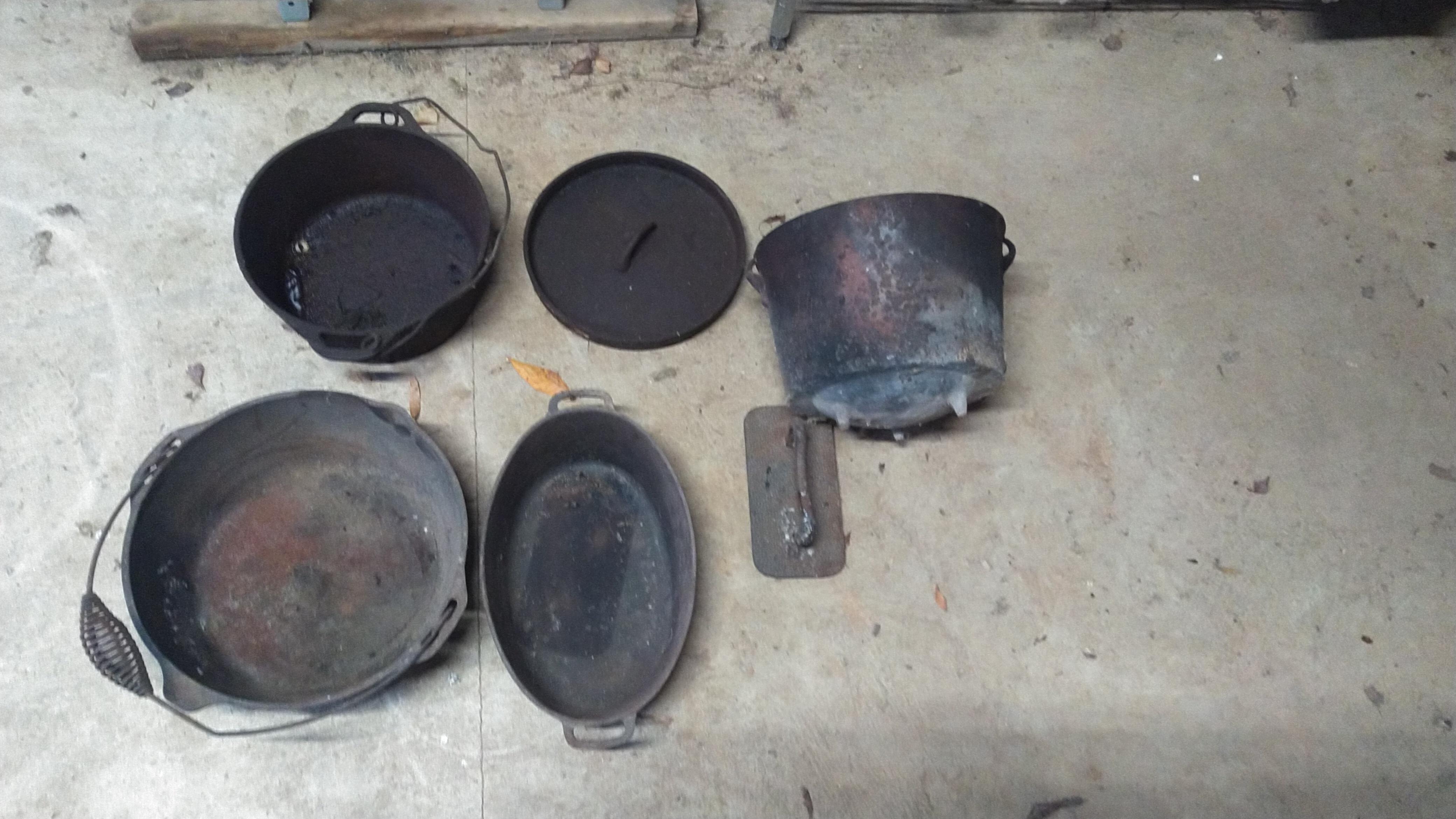

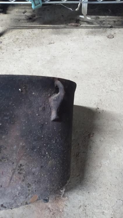

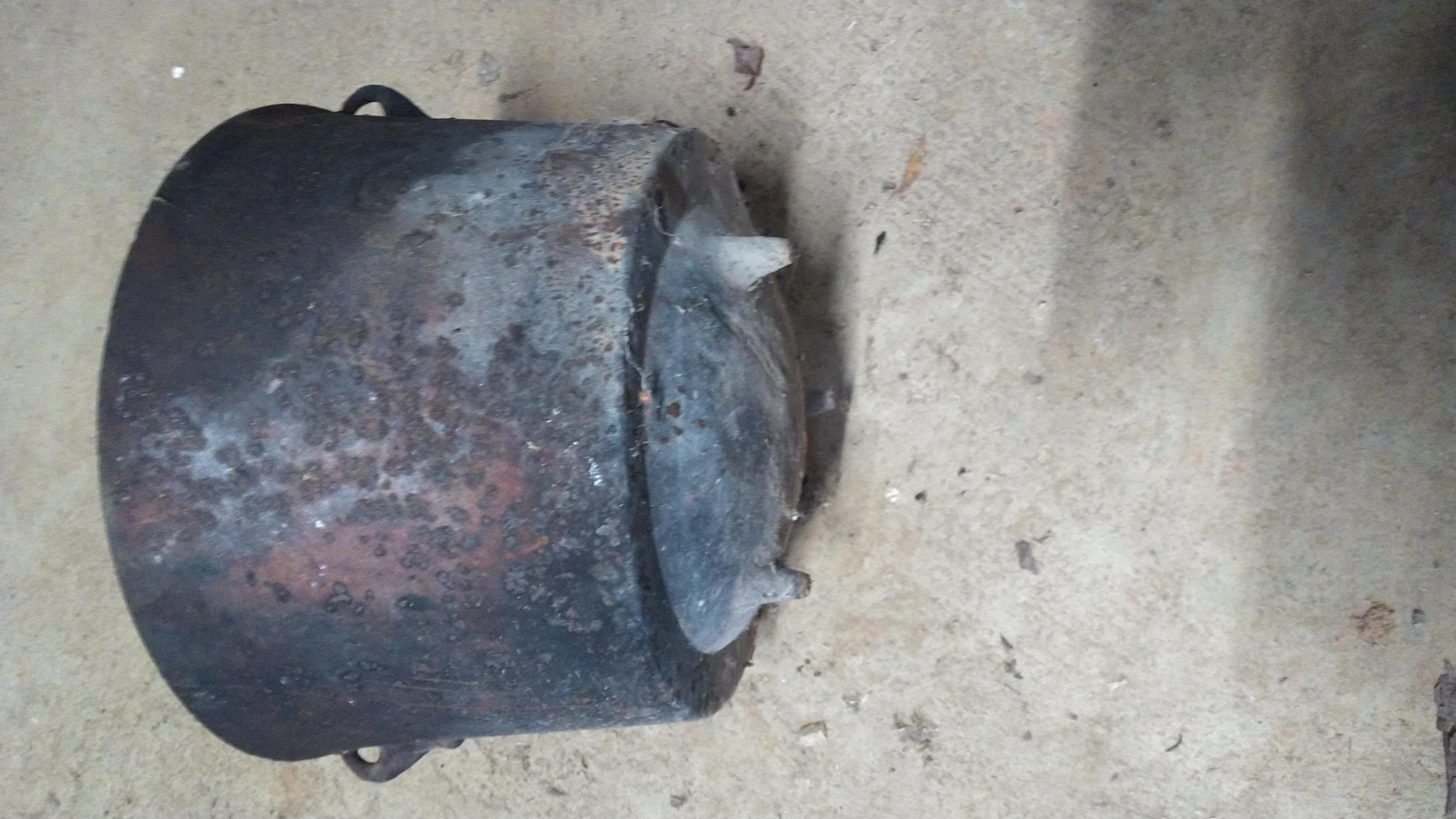

pots will be dry Paul,,  For Sure..  here they are..  One is supposed to be really Old..  if I have time this weekend I will do 1 or 2 of the modern ones...  I think it will be fine..
you have me curious TJC...  I just see cast iron..  I guess I dont see a negative for blasting the inside and wiping it clean then baking them...   Thank you for chiming in...

because the sand will get in places it will be almost impossible to get out of, just like blasting a car.
and than 6 months later you will be cooking something and still have sand grains showing up in the food.
walnut shells, baking soda, or even dry ice as 70mackmb said will not have any effect of food days, or even months later.
