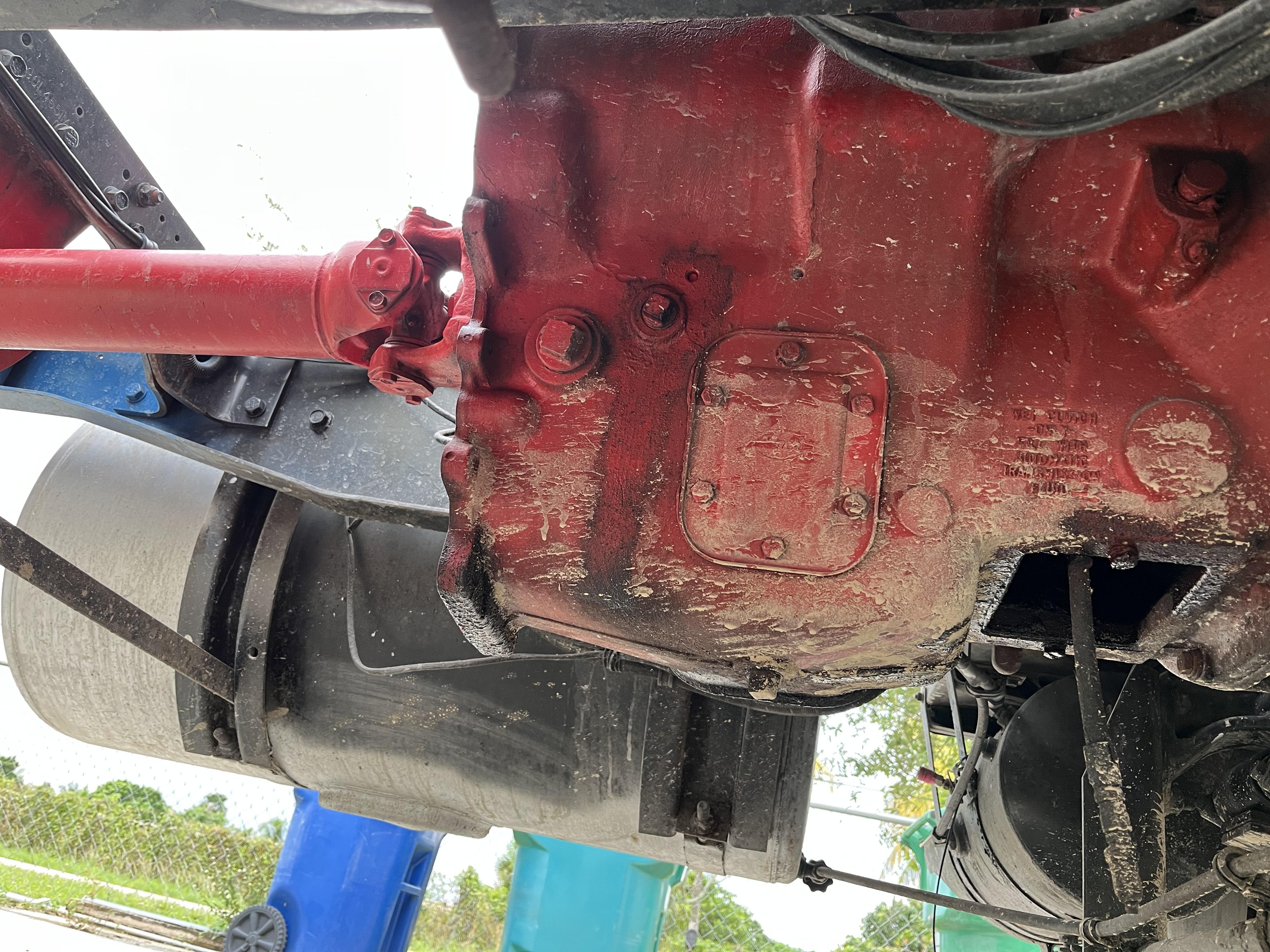

P.s. what the heck is that hose hanging out?
hose hanging down is an extension hose going to the throw out bearing for grease,  depending on the maintenance schedule/ operation, i would take them off. history has found ; units with the hose and improper Maintenace program , the throw out bearing got sooo much grease(cause it's easy to get to) the grease spilled out to the clutch brake causing it to malfunction. if a "mechanic " had to reach up into bellhousing for greasing , less excess grease on clutch brake.

looks like  there is a grease zerk on the end.
