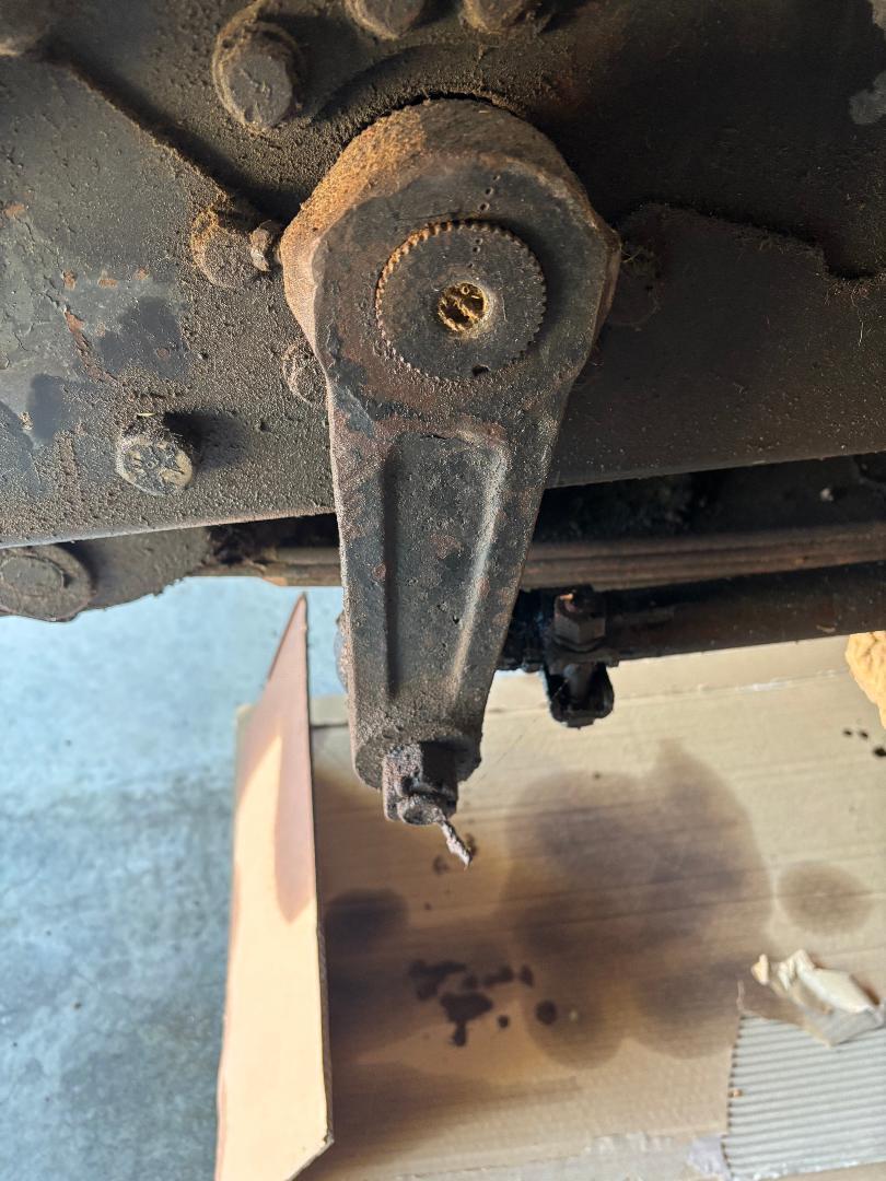

Bob.. take a close up picture of where the pitman arm is on the sector shaft, please... I am needing to learn what Mech is saying.  Just because.. 🍻
also it depends on the box the DM has. a sheppard outside frame pitman  had the two screws. inside frame ?? closing in on 74 I was still able to keep up with the youngsters loading hay and shaving on flatbed today after all day of sanding/grinding!! so maybe mind cells are off a little.
6 minutes ago, Geoff Weeks said:
THANK YOU  for the service manual. two set screws were more common(early) ; the large (5/8th ? allen ) did wake some brain cells, don't remember exact application.
14 minutes ago, Geoff Weeks said:
Sheppard used three different pitman arm retaining methods, you have to know which of the three you are dealing with.
Oldest had no nut and two set screws angled out from the box side of the arm.
the next style has a hex nut (allen head) and a star washer/retaining tab behind the nut.
The last style has a big hex nut that is split half way through and has a small bolt to "squeeze" the nut so it can't back off
thought Bob's DM was a '66 which would make it the two set screw version. can't place the "last style" ;; but that's OK - don't expect to be involved with one.
Check, if it is held on with set screws there will be 2 about 180 deg apart.  They can be hard to find after many years of rust and dirt. My "39" box truck has the two set screws (and still has the pitman arm on!) and the box will likely be scrapped with it on! No one wants a "39" box!

thumbnail.thumb.jpg.d89f273d1768d36b827180488ec2cea6.jpgDoesn’t that style have the two set screws that come in from the backside?  Terry:MackLogo:
That looks like the head of a bolt angled into the pitman arm at a 45 degree angle at 10 oclock in your picture?????
Brocky
Should be one on both sides, the other will be 180 deg from the 1st. If I am seeing what you are, it looks like someone replaced the set screw with a bolt.
If you are really interested , I can take a picture of mine, as there is no cab on the frame to get in the way. Just 2 allen head set screws preventing the pitman arm from working out on the shaft.
some one lost the original set screws or couldn't find proper allen wrench for install. some where under all the rust there should be a small arrow on the arm and steering output shaft. easier to just mark arm to shaft location , mis alignment the truck will  steer one way more then other.
after enlarging the picture, can see the double dibit  marks some one put on towards top right side. realigning is important.
