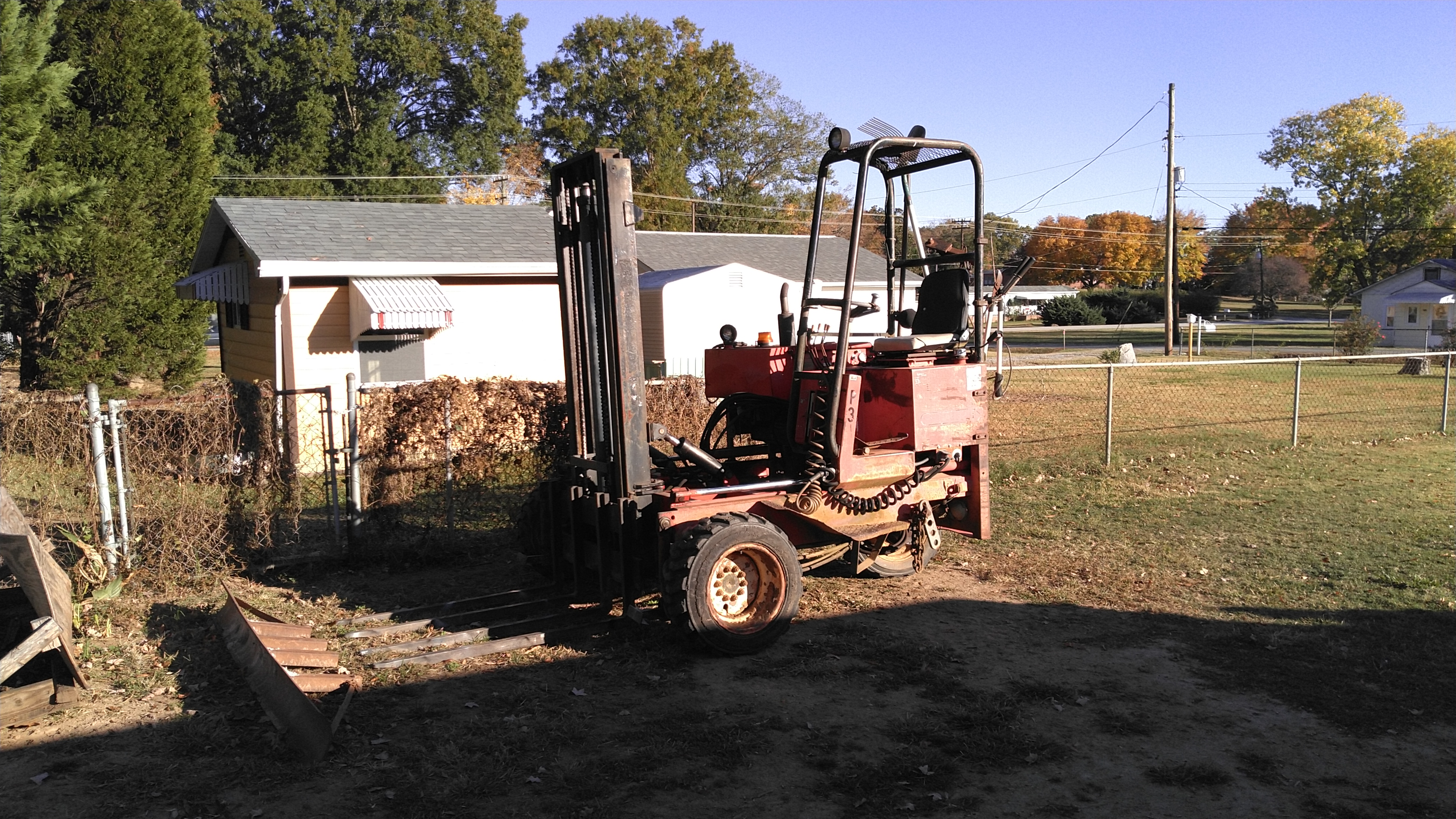

Good deal D.C.W. Can I get Opti-lube at NAPA?  I have a diesel fork lift that could you a little love.  It Has been my best employee for the last 12 years...   :)  Its full mechanical... jojo
