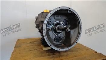

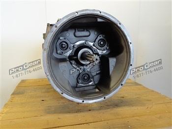

BEF75AD8-9553-4ACF-B46A-7C71CBBB2464_4_5005_c.jpeg.c576d882f1bfb8775be4d1ea2e25ce8b.jpeg4C937FA8-11DD-4A8F-A971-CA29E596A89D_4_5005_c.jpeg.0a38d2967219d98554582e1ae17db293.jpeg
Both the 9 and 13 speed have the same 11 hole bolt pattern but I would check your transmission to see. I think the 11 hole pattern is a SAE standard but I am not sure. The input shafts might be different but I can't tell
