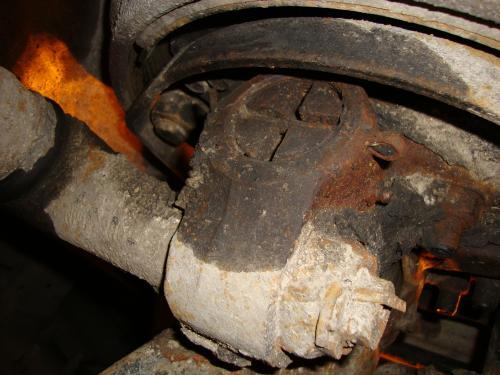

Nope.   Here's some pics.  Had to scrape the grease and crud off of it to see what it looks like.  Spent the better part of the day getting rid of the auto greaser, lines and putting regular grease fittings in everywhere.  The auto greaser wires were cut so my guess is they just disconnected and not lubed anything at PM time.  King pins are definitely wore out.  Jacked it up and pried on it with a bar.  Seems like the tie rods/drag link are good.
You familiar with this front end?  I'm hoping aftermarket parts are available as everything at the dealer is stupid money.  Doubt I'm going to do the job myself as it seems like it's a big job and never done them before.  Probably requires some special tools.  Any idea what this will cost?  Going to call around tomorrow.
looks like shit all over it.. that one is the adjustable one, but given the dirt all around it.... you need to clean it real good and check it again... if you are sure that its bad,  the repair is not hard to do..  when you take it apart,  take the king pin and put it back into the axle beam boss to see if it is worn out.. if it is, you can get the beam reamed and re-bushed to accept the new king pin set...  jojo
That style you take backing plate off, take cotter pin out of bottom, then there is a cross slot on botton, screw that out, the top is pressed in, pop that out and knock pin out to the bottom , once you break the taper loose it will fall out, alot of the replacements are nylon bushings.

After doing some research online, I'm pretty sure it's a Mack front end.  Actually found a couple of complete used axles on online dating back to 1997, so they've been using that axle awhile.
I imagine you still have to take the brakes and backing plate to do the the job.  Never done it before.  How long to these usually take to do at a shop?

steam cleaner is best, if you can use one anymore.  i  had one so packed with old grease/dirt  used an air hose to clean between spindle and axle . worn out was twice as bad without the packed dirt in there.
that is so true Mech..  good point.  once the dirt and hard grease is out, it can be loosy goosy...  so true..  I hope his beam is good.. i expect it is..  not a hard job,  the hard part is the anticipation of the cost..  jojo

So there's a possibility the beam is bad and needs to be replaced?  That would be just my luck.  The drivers side is pretty bad.  There's no telling how long they ran the truck without the auto greaser working.  I can't imagine replacing the beam is going to be cheap. :(
