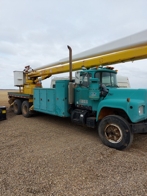

Picked up my parts truck
Picked up a donor truck for one of my B-61's. Problem is, as usual, I'm on the fence as to whether or not to part it out. I bought it mostly for the tires, mirrors, cab lights, engine/trans, and power steering box (and maybe the air ride seat) but it could be a pretty handy rig the way it is with the boom/basket. Maybe I can find someone that wants the boom/turret/down rigger assembly to put on another truck, otherwise i have no idea what to do with it. I'm not good at throwing stuff away. It runs sweet (237) and has the 6spd maxi torque.
Dual inlet air cleaner?  Is that a canadian cold air set up, eh?
Looks like a pretty decent truck.  That boom would get you as high as about anyone would need to get!(not me...I like watching from the ground)

The thought of transferring the cab to the R frame occurred to me for a nano-second but for me, to accomplish what i want that would be WAY more work. The boom trucks frame is WAY to long and would need to be shortened. The biggest possible challenge that I see is adapting the power steering box from the R into the B since the steering is completely different between the two. The steering box on the R is down by the axle while the steering box on the B is about half way between the axle and the firewall. This will require main g a  mount of some sort either where the B box is to accommodate the R box or down by the axle and changing out the drag link/pitman arm ETC to accommodate. As far as mounting the engine /trans in the B frame, I don't expect that to be a big deal. I put a 1984 mercedes diesel/4spd into a 1931 Ford model A with a little bit of creative engineering so I doubt that putting an '84 Mack into a '58 Mack will be too bad. Besides, from what i understand, it's been done 1000 times before so how hard a can it be?.
