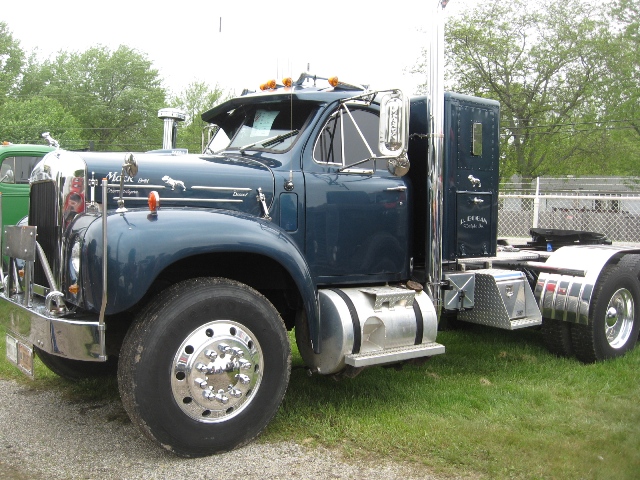

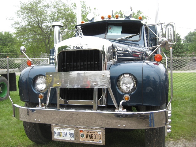

A 237 and triplex is perfect in my B.  I dont split until 4th gear, even pulling my trailer.   Now there may be different flavors of 237 but mine runs up to 2100(heard some don't). Having the option to drop 1/2 a gear works well for my towing.  It runs through PA hills with the cruise set at 65 mph.
Would love to have a 300!  Why?  Just because you can't have enough power!
BTW, my local shop wanted $2500+ to recalibrate the pump and they needed specific numbers as they had nothing to go by.  I quickly decided to leave it alone.
