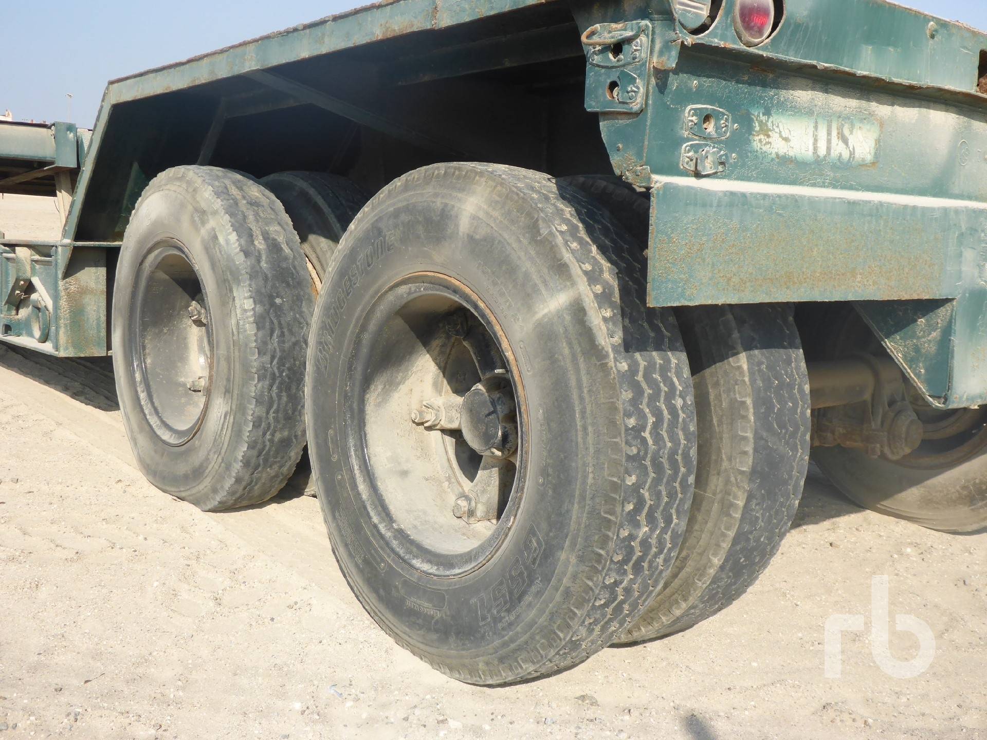

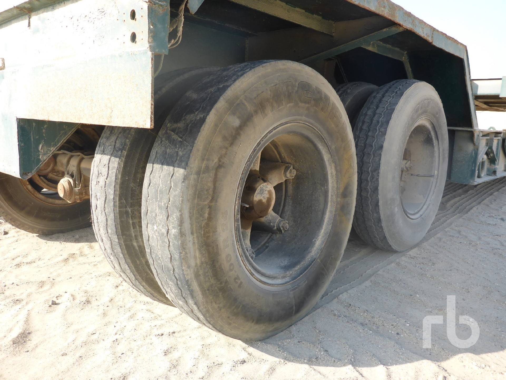

6 spoke dayton type wheels rims
nathanyel
friends,
what is the correct name for this type of wheels/rims ? please
and would anyone happen to know the brand name?
i am looking for details and if possible drawings of the same
thank you
[img]https://i.imgur.com/wxqqmvV.jpg[/img]
[img]https://i.imgur.com/GfDB3BR.jpg[/img]
Dayton Spoke wheels. Kind of generic now like Xerox for copies
Edited by 41chevy
We always just called them "spoke wheels", or "Daytons", because they were one of the manufacturers.
But, I believe the technically correct term is "demountable rims".
See Southwest Wheel or Accuride for examples.
https://www.southwestwheel.com/c-855-tubeless-demountable-rims.aspx
https://www.accuridecorp.com/sites/default/files/resources/2019-07/W1.000 Rev. 4 Accuride Wheels Product Catalog_0.pdf
Edited by doubleclutchinweasel

Yep, I believe they are called demountable
They are called spiders out here in Australia
Paul
On 11/29/2020 at 11:45 PM, carlotpilot said:
those pictured on trailer are for tube type tires either with the single or two piece lock rings
Single lock rings and the spiders are cut down OEM wood spokes.
Artillery wheels are the steel style that replaced wooden spoke wheels in the late 1920s on  light and medium truck and passenger cars. This one is off a Dodge Brothers early 30's pick up.
