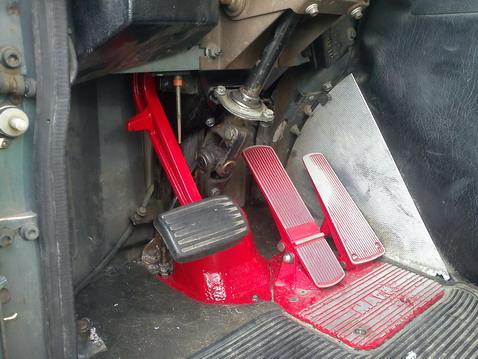

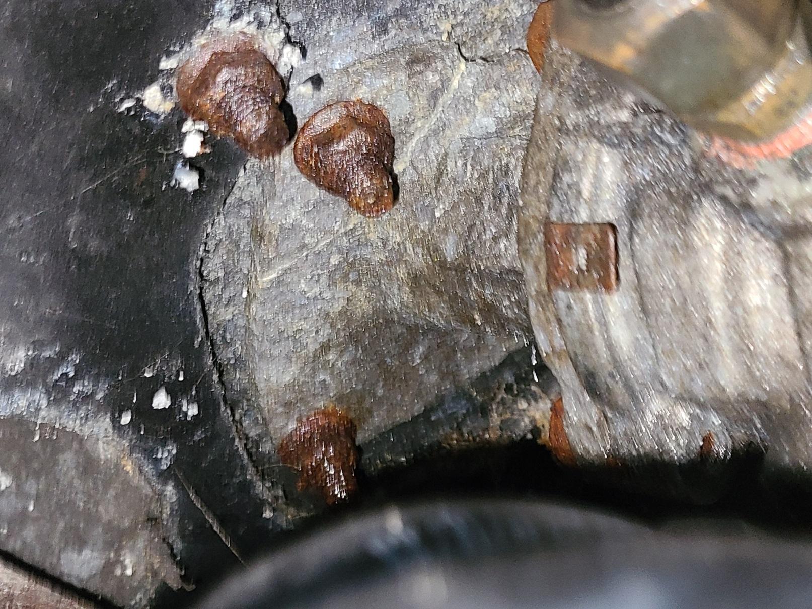

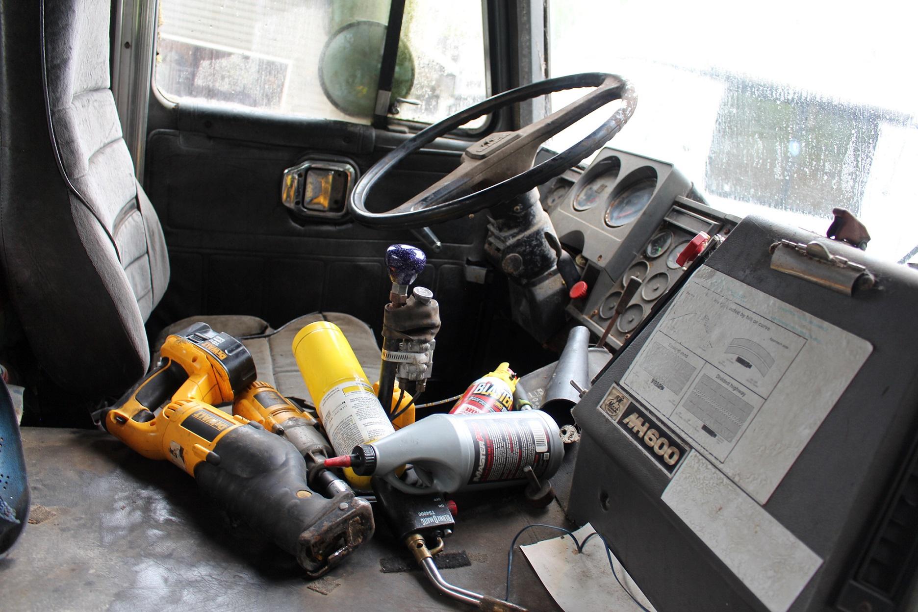

I am concerned about the Turbo though, it takes a few minutes to start to spin up when the truck is started. I am still looking for the "reason" it was parked other than electrical. There is clearly a problem there. Sadly it has been pouring here for the the last 2 days so I have not gotten much done except getting the roll pin out of the brake pedal. Which Was a giant PITA...
I ended up cutting it and even then it was a chore to remove it. My whole assembly is junk anyway so I did not feel too badly but I need to source a new one.

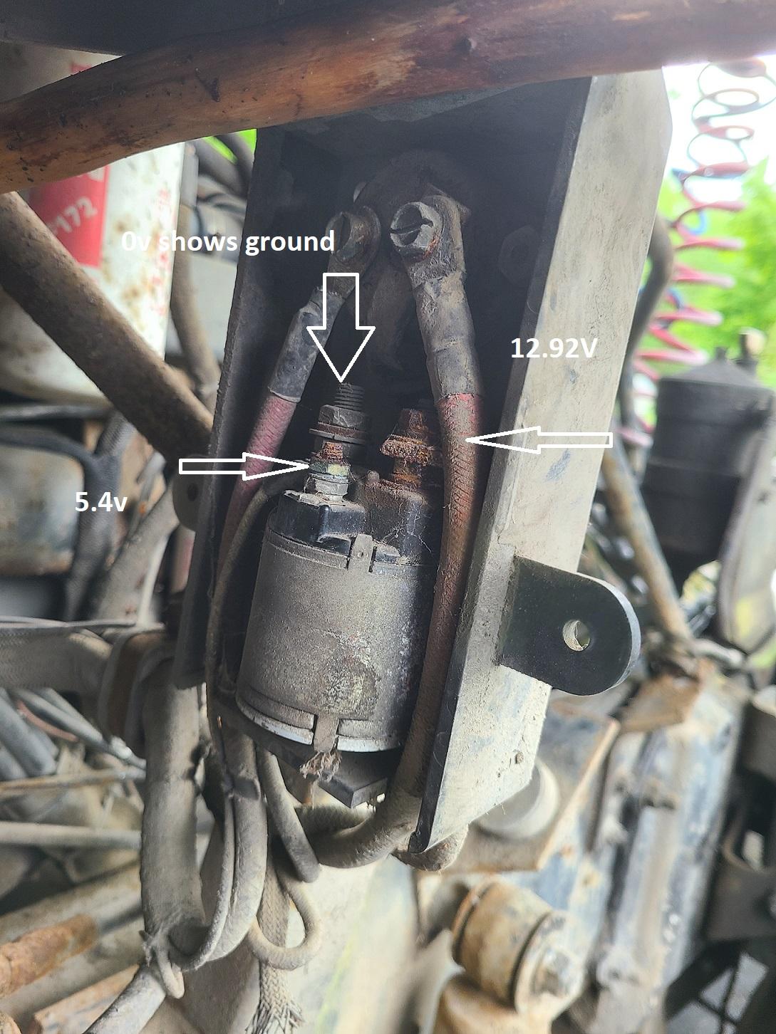

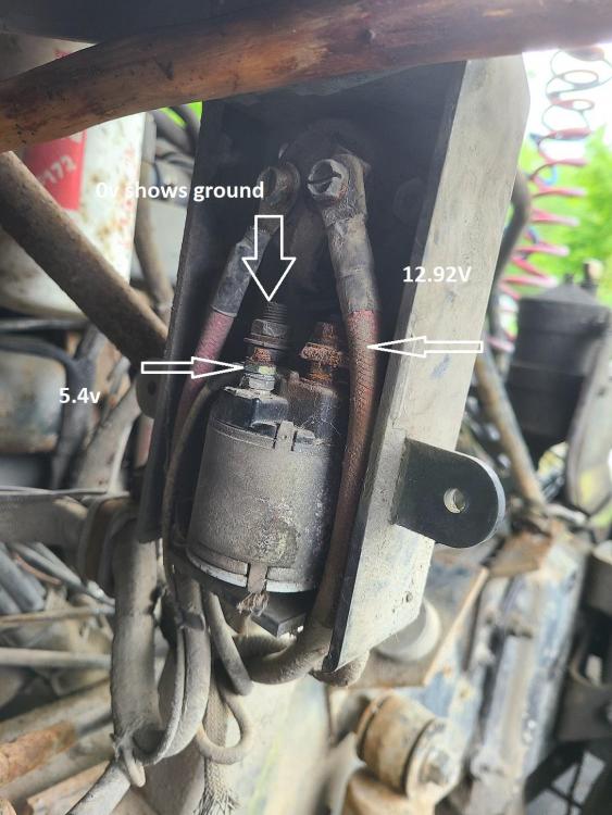

I do have a question, Does this truck have a fuse block somewhere for the cab?
When I run a test light to the second pole of the solenoid under the cab it shows ground so I guessing it has a huge short somewhere and if I could pull fuses to isolate it would help.
Thanks

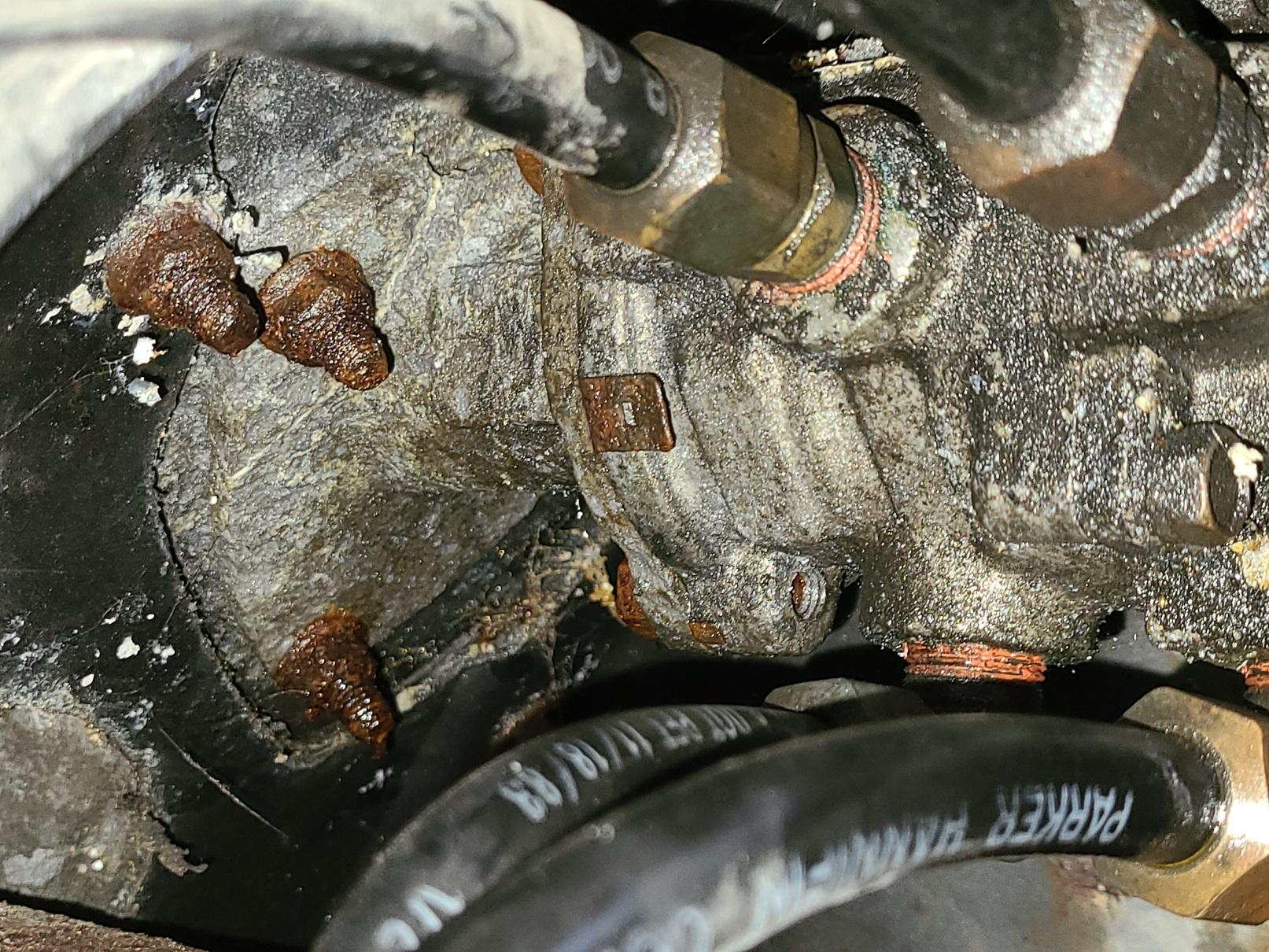

The brake pin housing and the threaddle valve are two different parts. The lower part (valve) is a standart Bendix valve. The top part is a housing with the pin (or plunger) inside and it's special to a MH. R-model has similar part but it's much shorter with shorter pin (and easier to get moving when stuck). The matter is those two parts are connected with 3 screws. You should take them loose or cut. This would allow you to get the upper part off the truck with access to the bottom side of the plunger.
As i remember those two parts are connected to each other having the cab floor in between. So the threadle valve is below the floor and the pin housing inside the cab. i might be wrong on that since we fought this issue already 6 years ago and my helper fixed the truck not me.
On 5/18/2020 at 12:36 PM, Vladislav said:
The brake pin housing and the treadle valve are two different parts. The lower part (valve) is a standard Bendix valve. The top part is a housing with the pin (or plunger) inside and it's special to a MH. R-model has similar part but it's much shorter with shorter pin (and easier to get moving when stuck). The matter is those two parts are connected with 3 screws. You should take them loose or cut. This would allow you to get the upper part off the truck with access to the bottom side of the plunger.
I can see what you are referring to, getting that big "pin" to move is not happening so I am debating sep the Bendix valve from the housing or the housing from the floor of the truck....

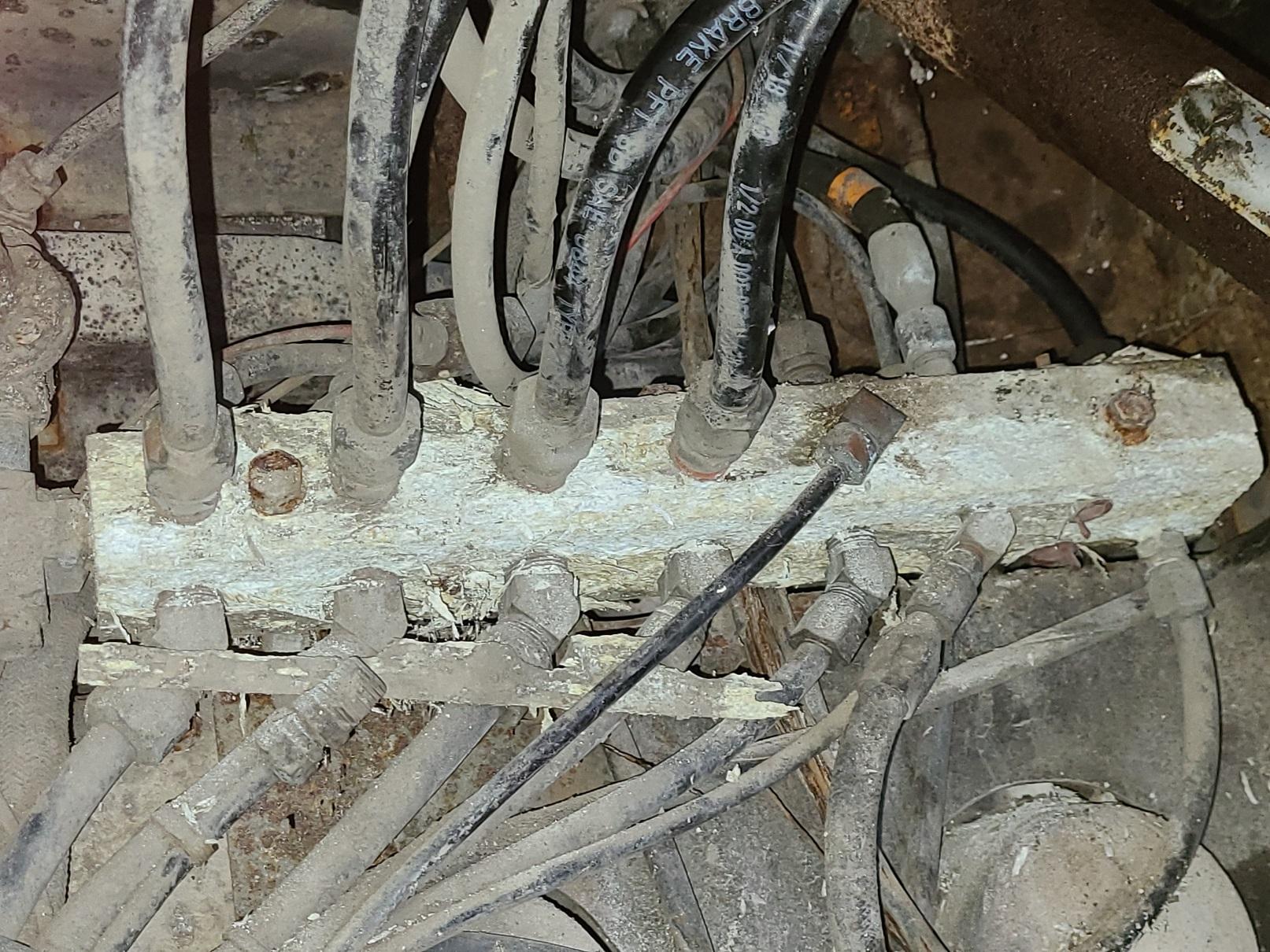

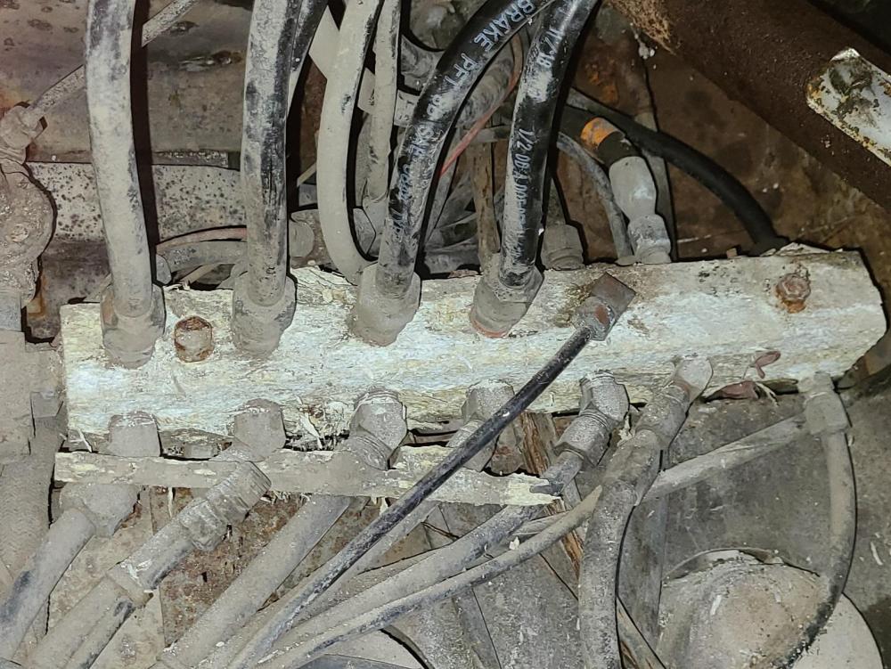

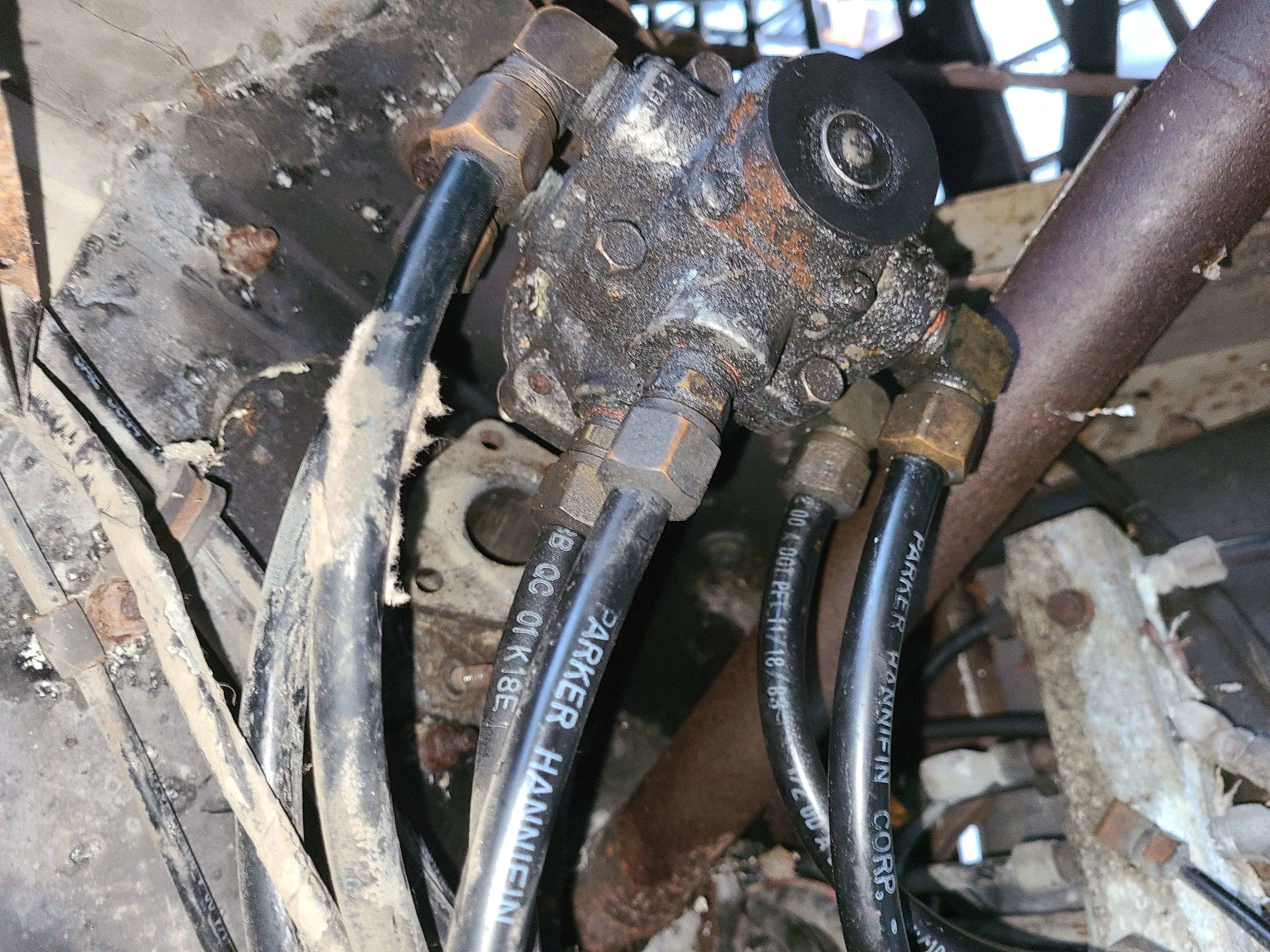

anyone know what this is called? as you can see, mine is perished.
Seems to be an air distribution block and is probably a standard Bendix part but I can not seem to find anything on it.

Awesome, thanks that helps
Do you happen to know if the smaller wire to the 3rd pole (usually the activating pole) is key switched 12v? Mine has a constant 5v but I am thinking that is a short somewhere.
It does not activate when I put 12v to it though so it might have a bad ground as well. IDK
Thanks though

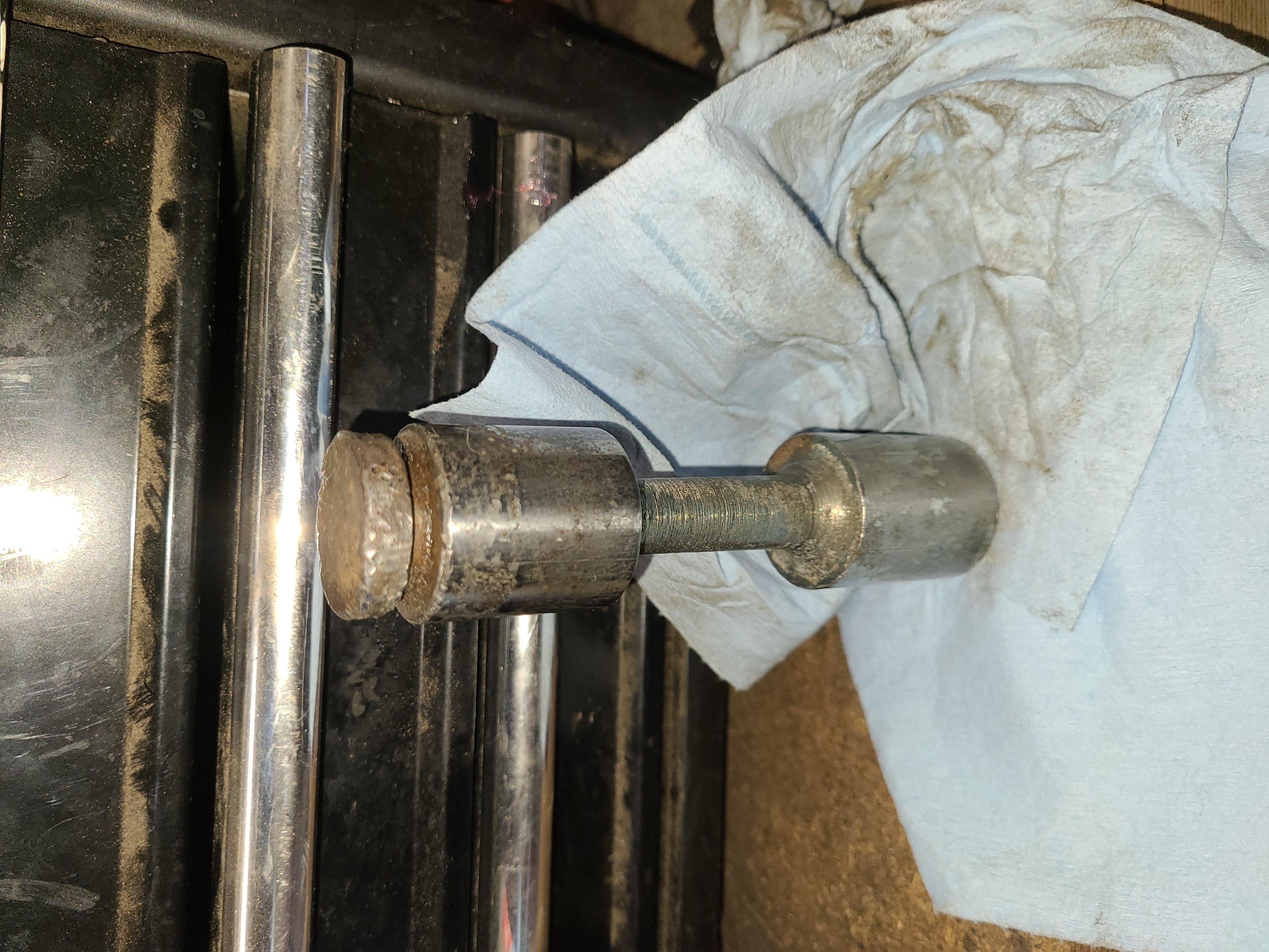

The threadle valve - now your pictures brings my memories back. What we did was cutting off the nuts from below the floor (seen on your pictures) and remove the valve assembly downwards. Had to disconnect air lines off it so draw a scheme and marked the lines. After the assembly got on a bench we cut or turn loose 3 bolts which connected upper part (with the plunger - tappet) to the brake valve. Hitted the plunger both ends with a hammer, got it free, sanded, greased, put back in. And than assembled everything back together using new hardware.  At the time we also cut the rest of bolts which connected all the pedal plate to the floor. So I was able to sandblast and paint the plate and two pedals in a hope to prolongate their good days.
The big relay - of what i recall we had an issue with power supply in the cab. Turned out there was a big wire which went from below the cab and supposed to power up the fuse panel and it had no voltage. So we reconnect it elsewhere or revised its power sourse or something else, not ready to tell now. The point I wanted to let you know there should be one big wire below or behind the dash at the passenger side which supplys everything in the cab. So it would or could be a point you use checking out electric functioning.
Sorry no advice on sourcing the air line connector (manifold?) Excepting looking for good used one or fabricating in a machine shop.
I am quite certain the disconnect is manually operated only by the red knob on mine. I would find the fuses or circuit breakers and check for voltage. You never did show the back side of your solenoid. What is there?
Well great news.
After beating the stuffing out of it, I got smart and removed the bendix valve from the housing. Leaving the air hoses attached and tapped the piston up through the floor. Should have done that 2 days ago.
The irony is the bolts on the top of the valve were the ones I was avoiding because you can not see them. The funny part is from years of grease dripping on them and protecting them, they were little more than finger tight and actually easy to remove. The valve fell off and exposed the bottom of the piston. A couple taps and I was free.

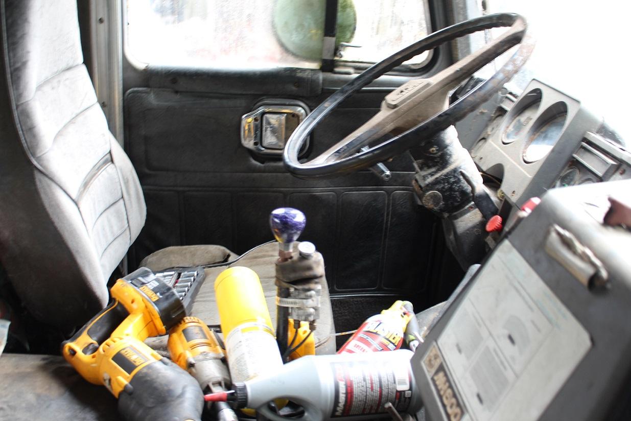

I have hi-low and seem to have all forward gears but I can not grab reverse. I am in low but it is not picking it up. Is there a secret I am missing?
Think the u joints are perished in the shift linkage Any clue where to get those or a part number for them? The look small so I am thinking they are automotive?
Usually some holes in the shifter housing get worn where axles pass them through. In fact it could be required (or might worth) to remove all the shifter (bolted to the cab doghouse) and revise all the joints. I personally would be likely to get just a used spare shifter assembly to revise and have as a spare but seems not easy to put your hand on one. I mean finding a perfect cond shifter is a hen's tooth entertainment To figure the truck has operational reverse or not you can use someone's help. Put the guy in the cab and show how to put the lewer into the reverse. Than get yourself near the linkage (being sitting on the frame rails or so) and try to force the shifter on the top cover of tranny to end up the way it would go when the helper operates the lever in the cab. Than tell him to try releasaing the clutch and see the truck moving or not. Pretty sure extreme caution must be provided during such actions including plan B instructions to the helper if anything would go out of line..
