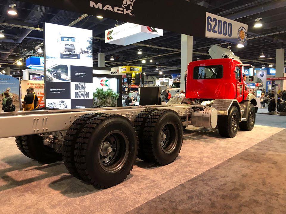

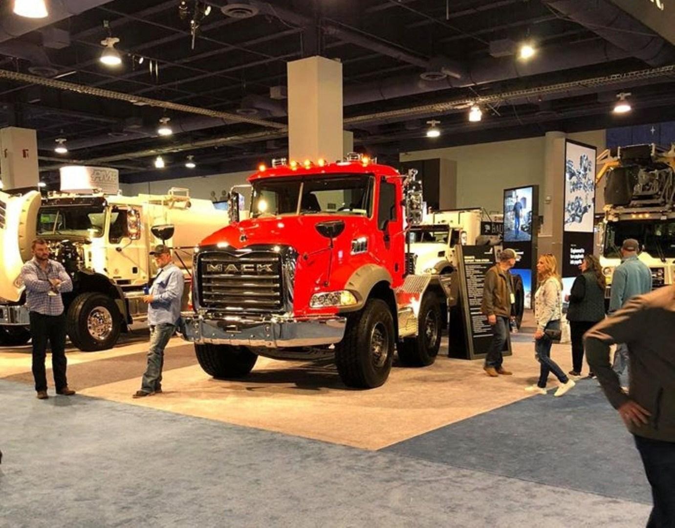

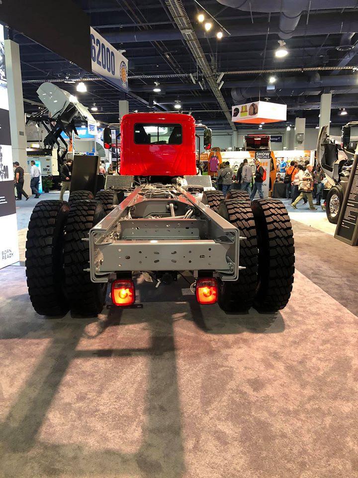

Here's one installation from Con-Expo. Not my pics. Were sent to me.

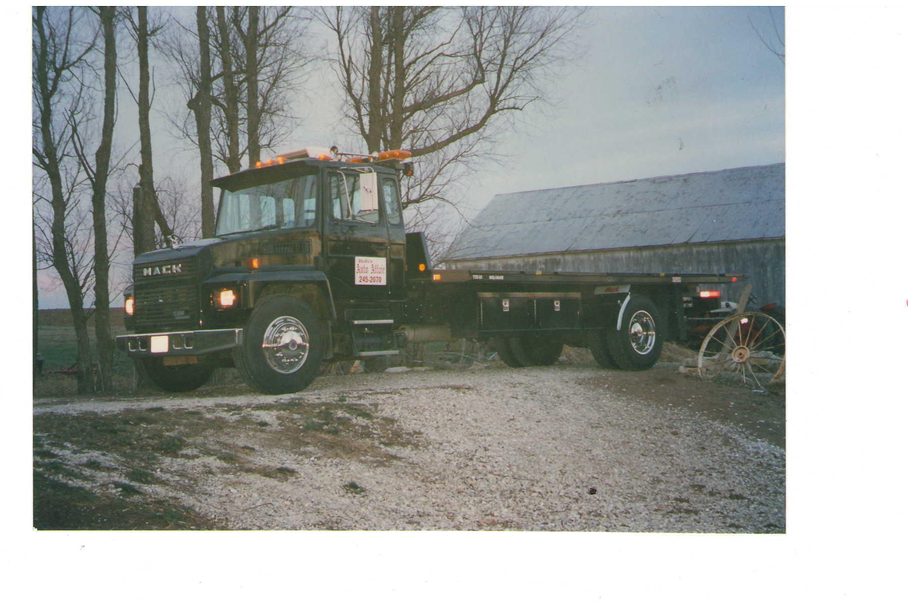

This was my personal one which I kept pretty much local unless another was in for service:
OK thanks. I would have never guessed that would be a planetary on that. Nice little truck. That would be handy as hell. I always wanted a rollback, but I had enough nightmares just trying to insure my F550 here in Ontario let alone a true medium duty. All the insurance companies told me "we can't insure it for personal use because it is a commercial vehicle, and we can't insure it commercial under your business because you are driving it for personal use." ????????????? LOL

I hauled insurance salvage vehicles out of Chicago for years with two of the Midliners, a GMC 7500, and and two IH S1900, 4900, and S1700, 4700 series. Exited that business in 2005 when the industry collapsed and haven't looked back. Never had loans on equipment and sold everything clear and clean.
The Midliners were full air brake systems and besides the occasional air compressor problem, were trouble free. The rear axle housings were funny looking in those trucks and the cap had the planetary gears with the Sun being mouted to the drive axle shaft. Only ever seen photos and never actually had one broken open myself as didn't have leaks, or broken parts to deal with.
That black one was a 1989. The white one was a 2000, and the blue one was a 1994, or 1995. All the axles were the same and the engines were 210hp with BDSL-181 six speed transmissions. In my memories of running them they were absolute "Gems" to own being very comfortable and smooth. They were however maintained very well during my tenure.
I'll have to look for Polaroid photos of the blue one as it had a drop axle, 28' bed, and stinger to haul three cars. That scan of the black one is from a Polaroid photo originally too. Didn't get a digital camera till 2000.
