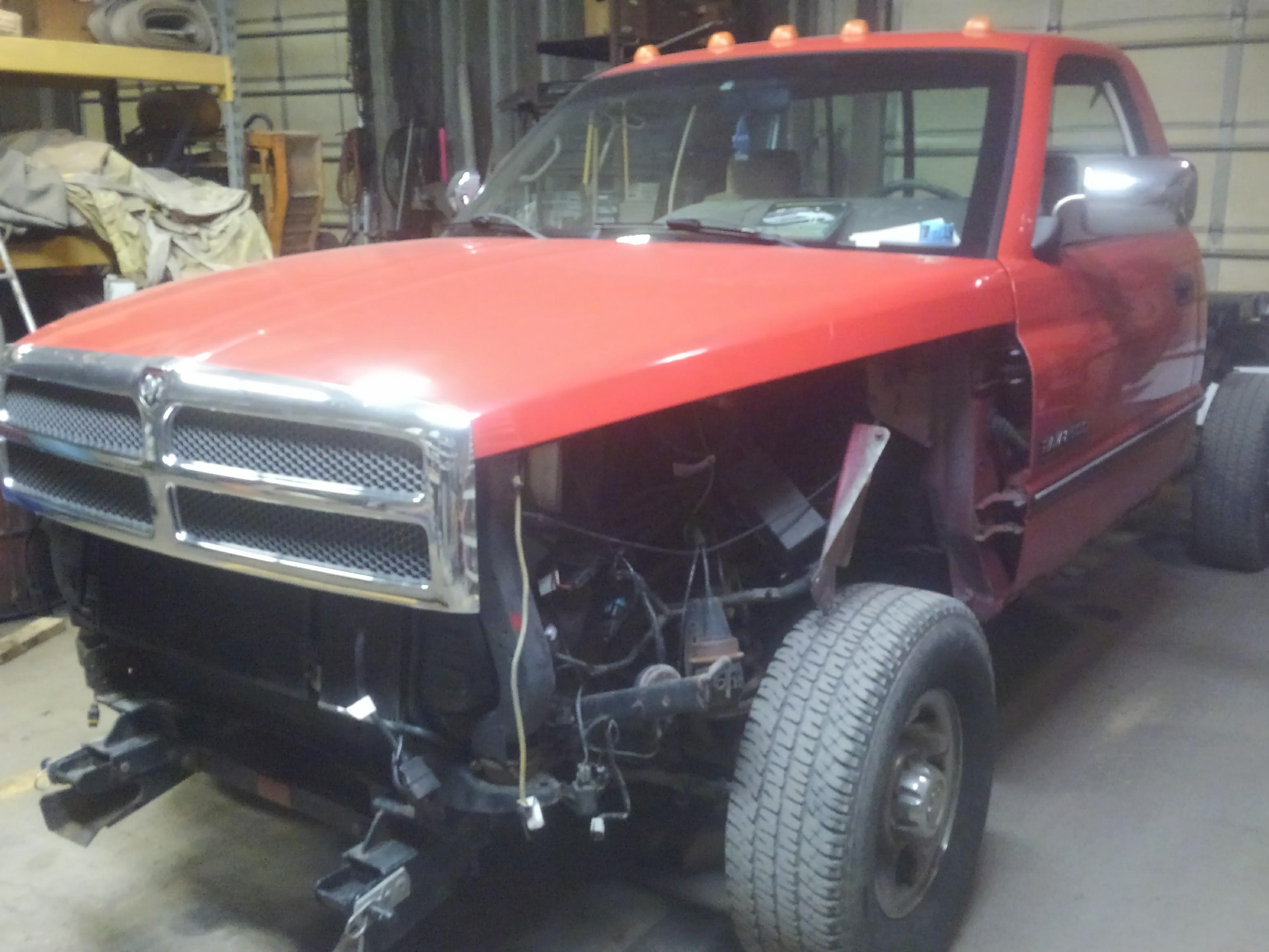

This is what I just started in my other bay.  Gotta finish it for snow season!
It's getting new fenders, rockers, doors, cab corners, bed skins and I'll be sandblasting/painting the frame and axles too. It's treated me very well since I got it, now I'm just replacing rot so I can get another few years out of it.  (It's a 12v)

This truck is a 97 also. It's up to 220k miles, original trans. Lots of towing and plowing.  Left fender fit well, next I'm putting the left door on before doing g the rocker and cab corner. Gotta do it all just right to get it all to blend together.
My panels came from LMC truck, which gets them from Taiwan.  So far their metal seems good, but I bought plastic parts from them once. Never again. It's brittle and really cheap, as low quality as anything I've ever seen.

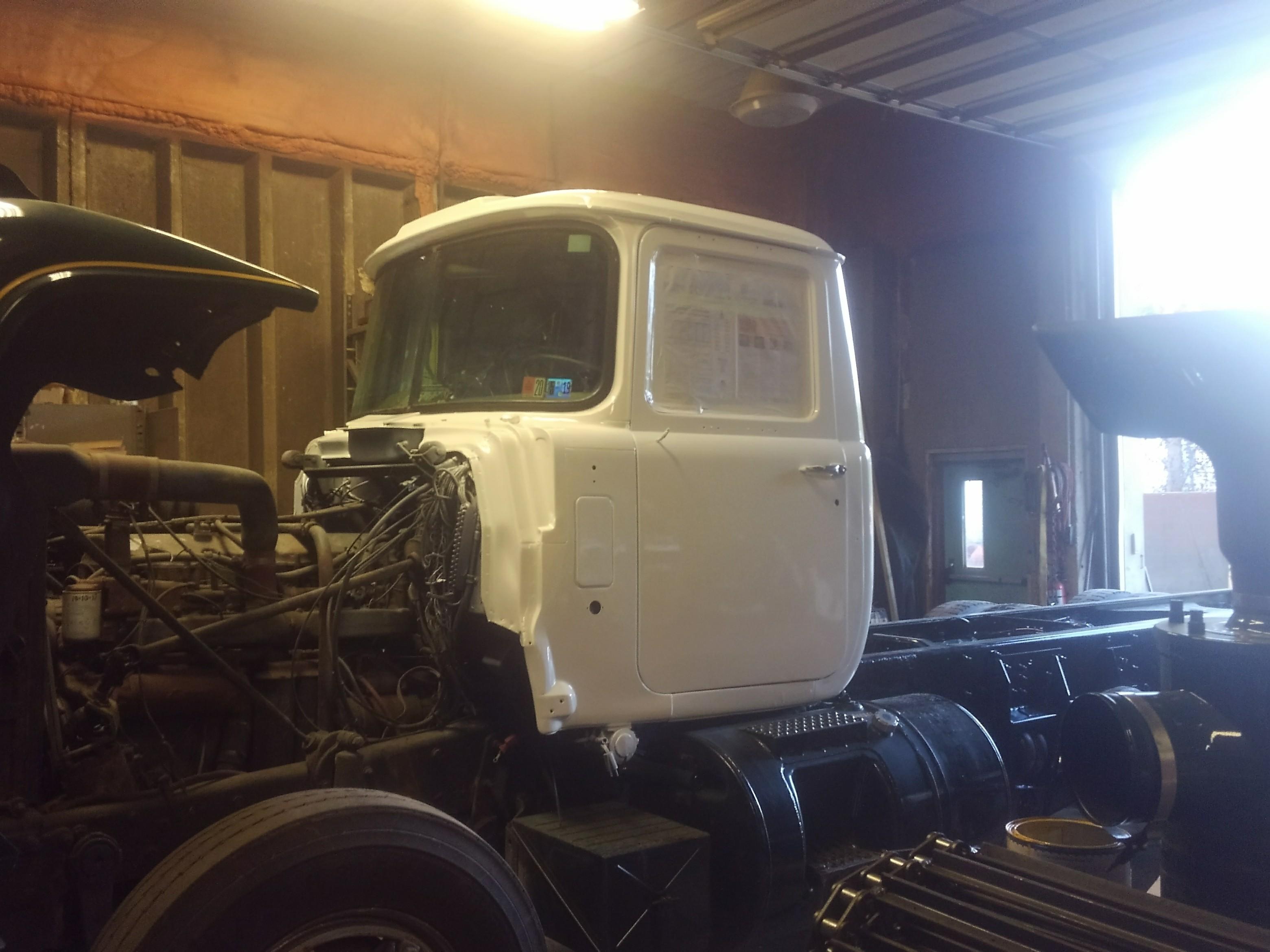

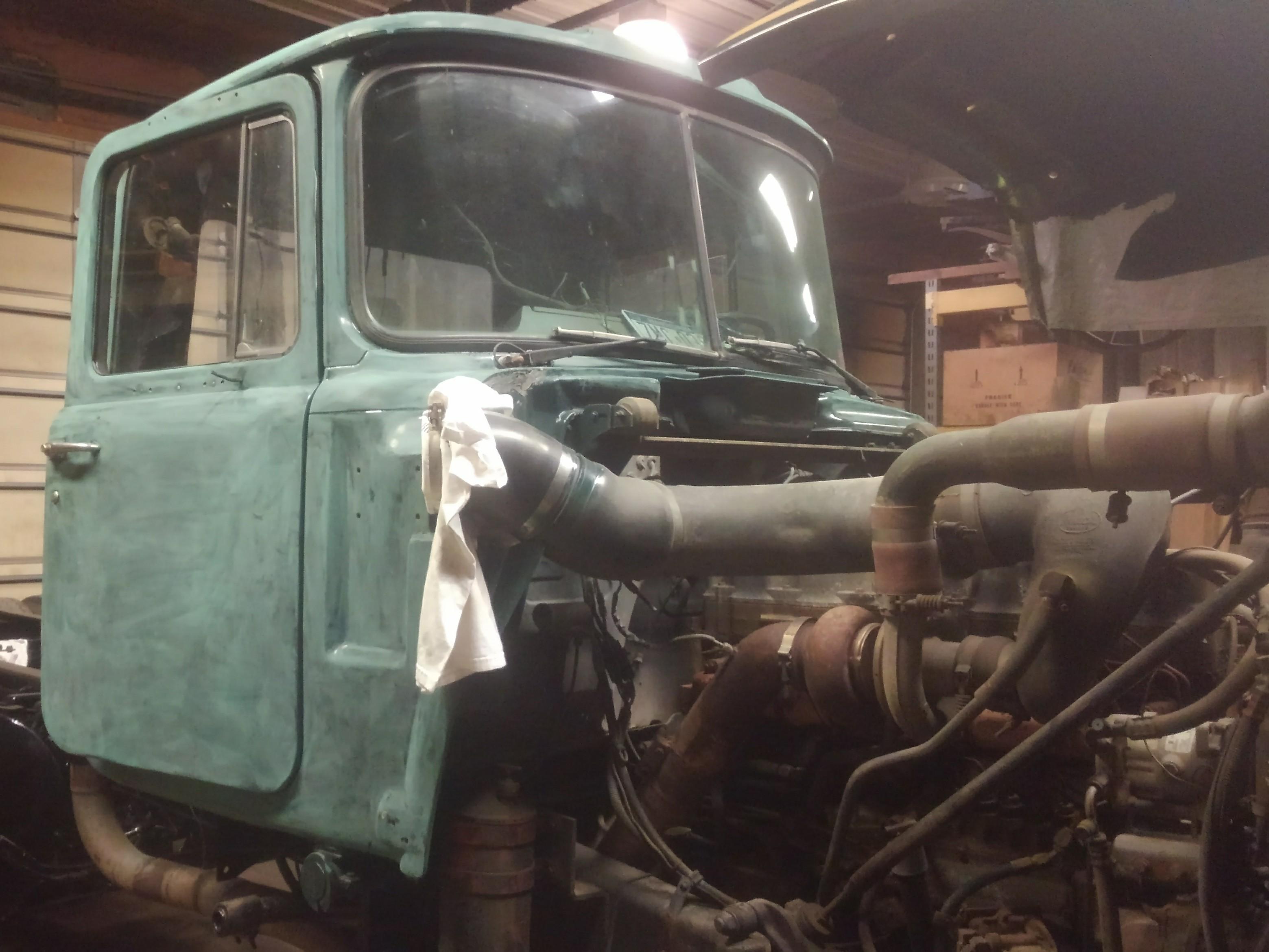

Lots of runs on the back of the cab, and the roof didn't get sanded down well enough so I expect to see some paint flaking on the roof at some point, but it is a work truck so it just needs to look nice driving by and run like a Mack.
Yep; a little supervision from my dad.  (helps to have someone help pour paint for refills)
I like to have the cab stripped down as much as possible to paint. Lights, horns, mirrors, roof vent... I want it all off. Hood is off right now, dad's gonna repair the fiberglass cracks and we'll sand it down and paint it before it goes on.
