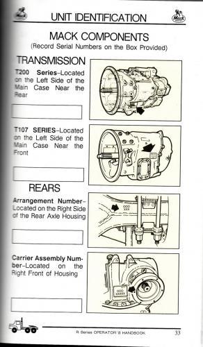

Thank you j, this was helpful.  I found the numbers are depicted in the tech sheet but it doesn't tell me much.  The carrier says CRDP 92.161.66, what does this mean?
ron
It should be right next to the stuff you found, sometimes stamped, or numbers made by a center punch, sometimes real light.     terry:MackLogo:
Look more over that square spot on the carrier front. Usually at the right side at the the bottom are numbers indicating the ratio. They're standing apart from the rest. Something like 5.02 or 4.46 or 5.73 etc.
