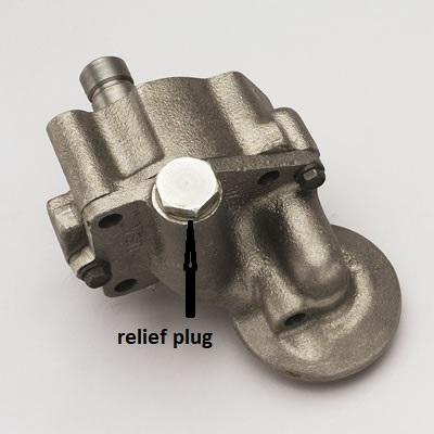

wonder if there`s a way to unstick the regulator without taking the pump off and tearing it apart   this one so far has just blown the rubber seal out .i`m going to try about a hundred lbs. air pressure into the feed back hole and see if that works before i pull the pump

You can do it on the engine fairly easy. Remove the large "NUT" on the pump and pull out the relief spring , spray in the port where the spring is and the oil filter side with solvent  a few times and let soak, reassemble and fire it up.

Doesn't the valve come out the side of the pump?  It's been ages since I've looked at one closely.
there is a plug pointing to the back of the motor that i think is the pressure relief valve`  can get to it from under the car but i believe there are  two valves in that mess              we`ll figure it out     one or the other methods will work

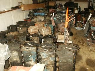

I got 70 or 80 413, 426 wedges and 440 TNT engines plus 2 dozen or so Hemi drag engines. 425 to 2500 h.p.  we could find one for you.
Edited by 41chevy
And here I thought I had several B/RB engines, I had eleven B/RB engines. I sold the last one a 383 two years ago.
