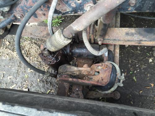

Yup.  Swiped this picture from "Out behind the Barn".
You can see the box mounted to the axle with the steering shaft and the fluid lines.

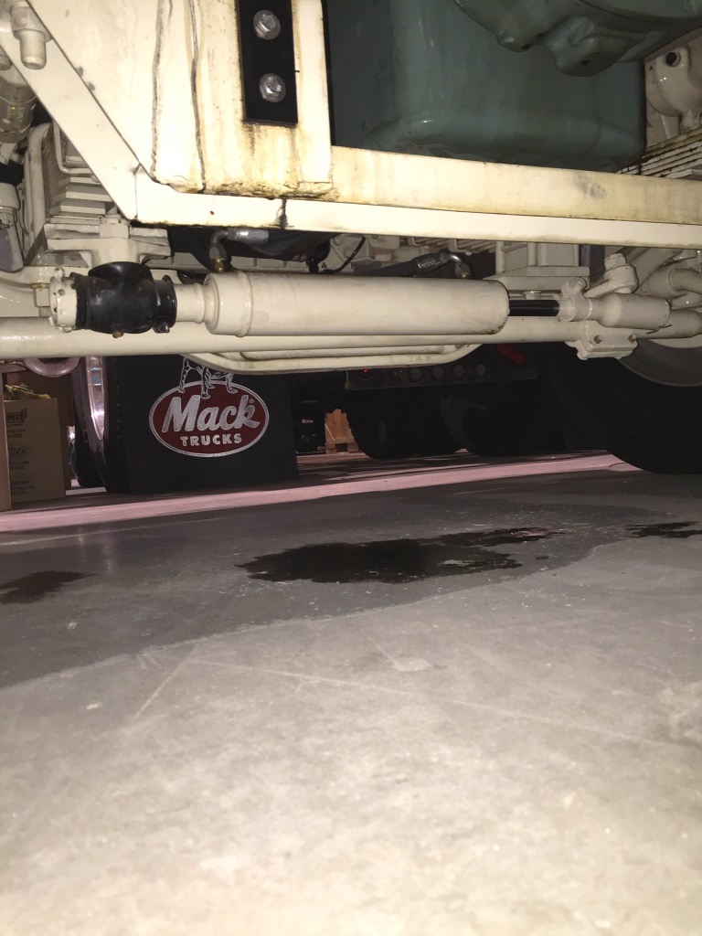

Mike, had time today to get a few photo's of the setup

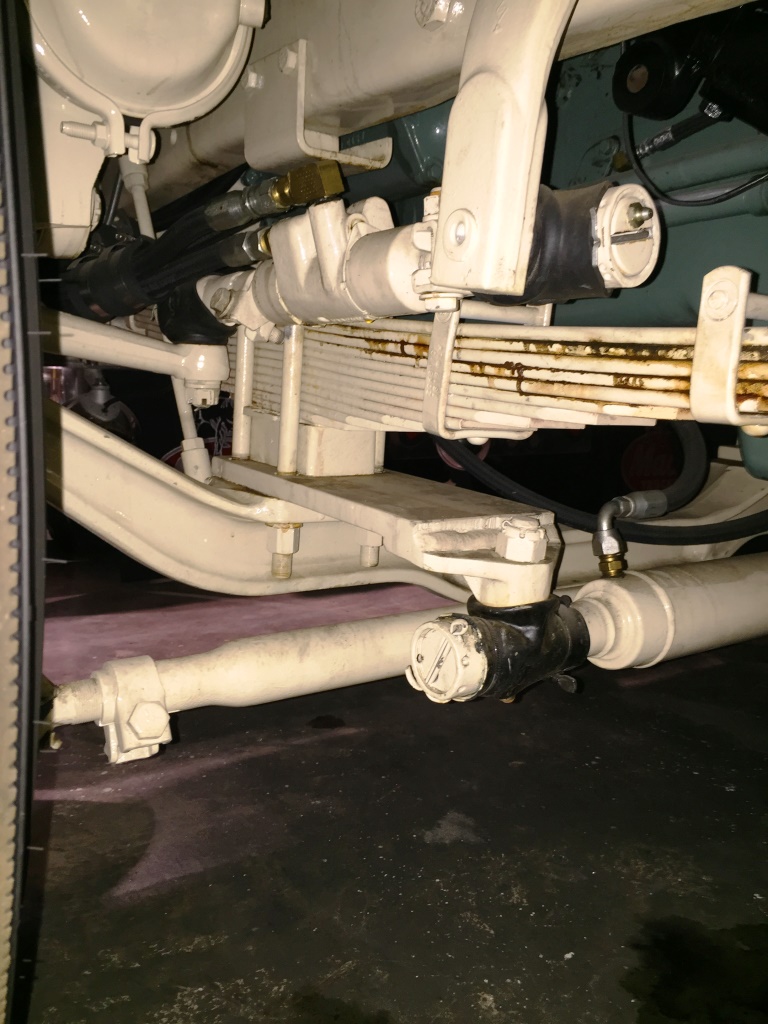

The mount for the cylinder, have to put the same height spacer in the passenger side or trim down the drivers side to compensate for thickness

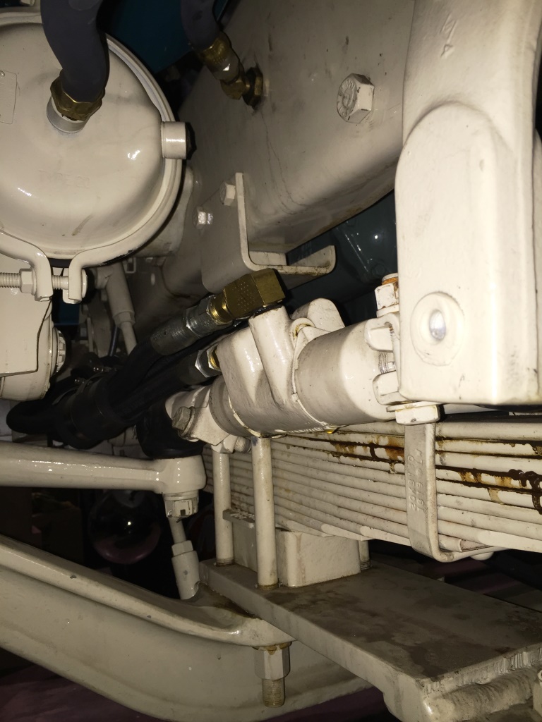

The control valve and mounting to steering link and Pittman arm
The hydraulic cylinder and mount to drag link

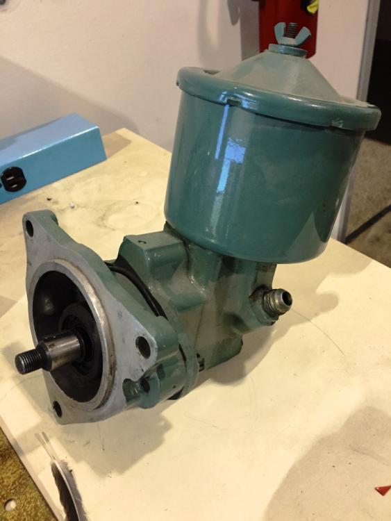

864 mount and small pump, small tank, mounts with 3 bolts, I do not have the gear, don't know if you want it, let me know

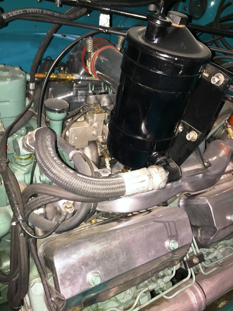

825/875 Pump and tank in my B755, a lot bigger pump like on a single steering box E9, a double box pump and tank are even bigger

Jeff, the pump you have for a 864 would fit with the 864 gear, but is the tank big enough for the garrison set up? Is that why you went with your set up? I have a spare tank off a superliner like the one you have on yours, but what pump would I need to get that fits on a 864 and works with a separate tank? Are the garrison set ups available new?
Live every day like it's your last, because one of these days, it will be.
The pump that I have is small for the volume of oil you will need for the setup. I did not use it for that reason, however an E9 or 825/875 pump would work. I think that drive gear was used on the bigger pump on my truck. You should have a spare pump for your stuff, if not one is on Ebay now for an E9. The thing is you will need the 3 bolt mount for a 2 bolt pump. The auxiliary drive on an 864 has the 3 bolt mount.  The only thing I don't know is if the drive gears are interchangeable from engine to engine and pump to pump. The bigger tank you have would work well. If you what the mount with or without the pump $50 plus shipping, As of a few years ago the Garrison was still available new. Less than $1500 complete if I recall right.
PM sent
