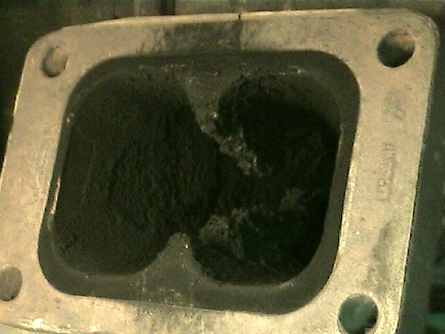

My RS700L with the 285..... when I bought it I found out the first time I pulled a trailer that it did not make more than 14psi. No air leaks in the intake system. did not have bad blowby. had new filters etc... I put in new remain injectors. still was weak pulling and EGT was going up into danger zone. I thought the engine was tired and needed a rebuild.  For shits and grins I took off the turbo to inspect it and found this... hard to tell in the pic but it was letting exhaust by pass the blades without spinning them.
just a thought

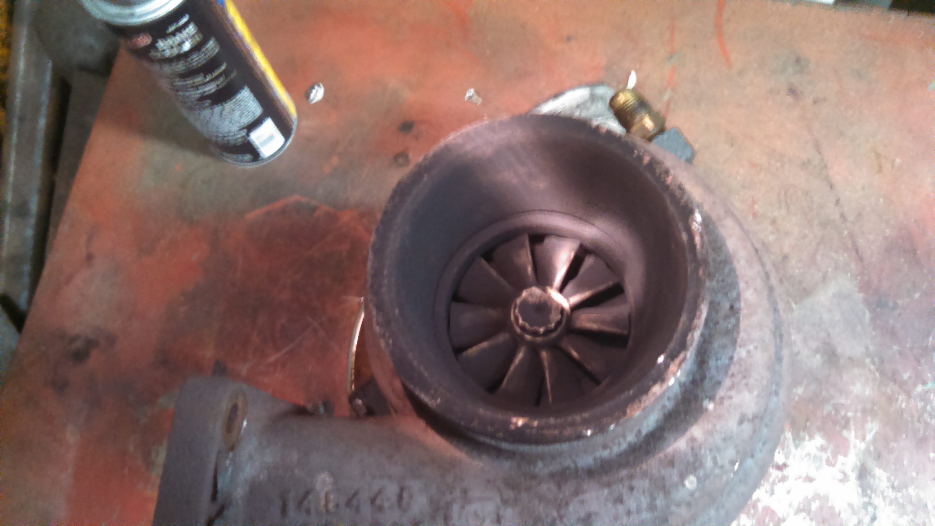

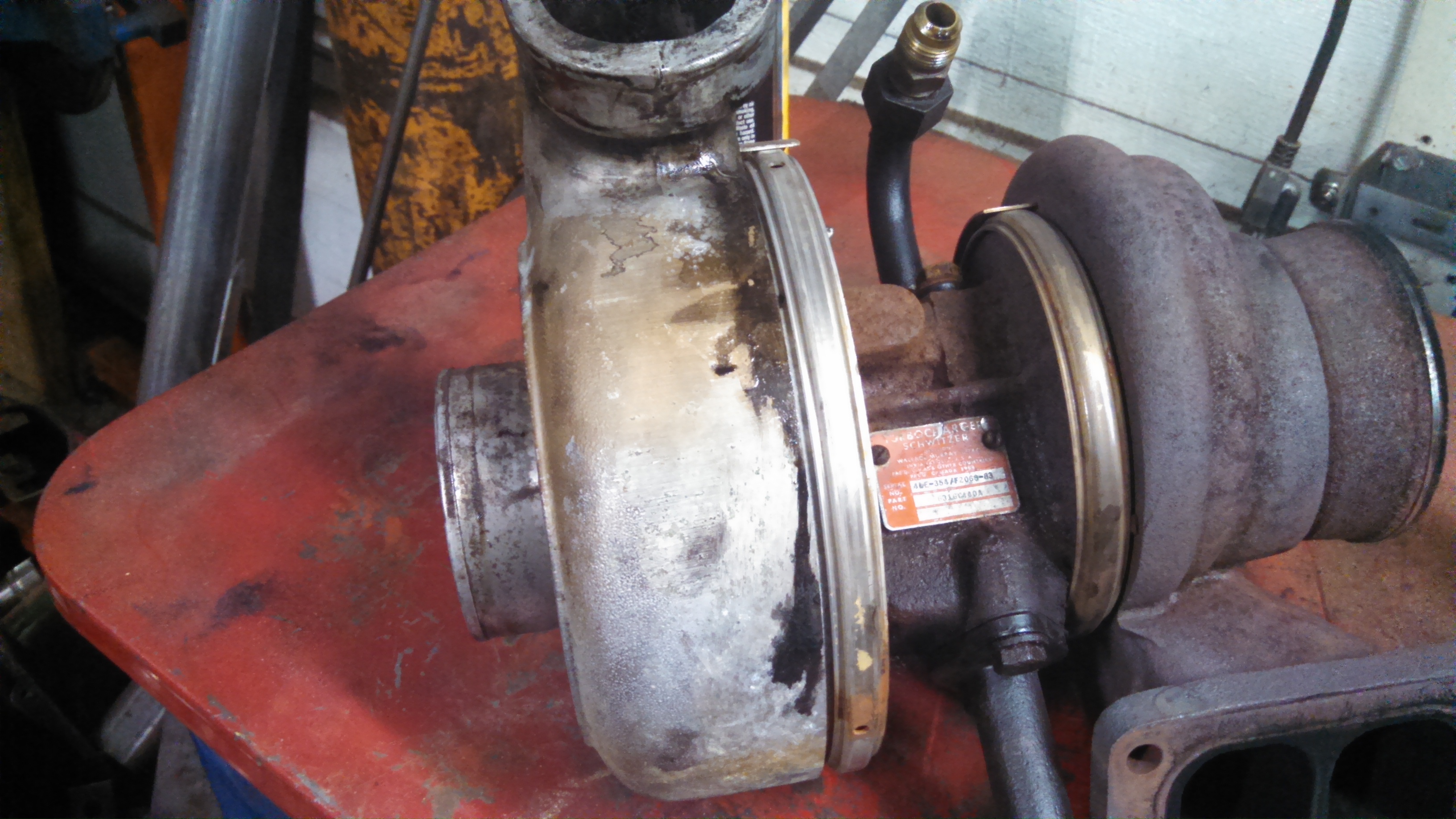

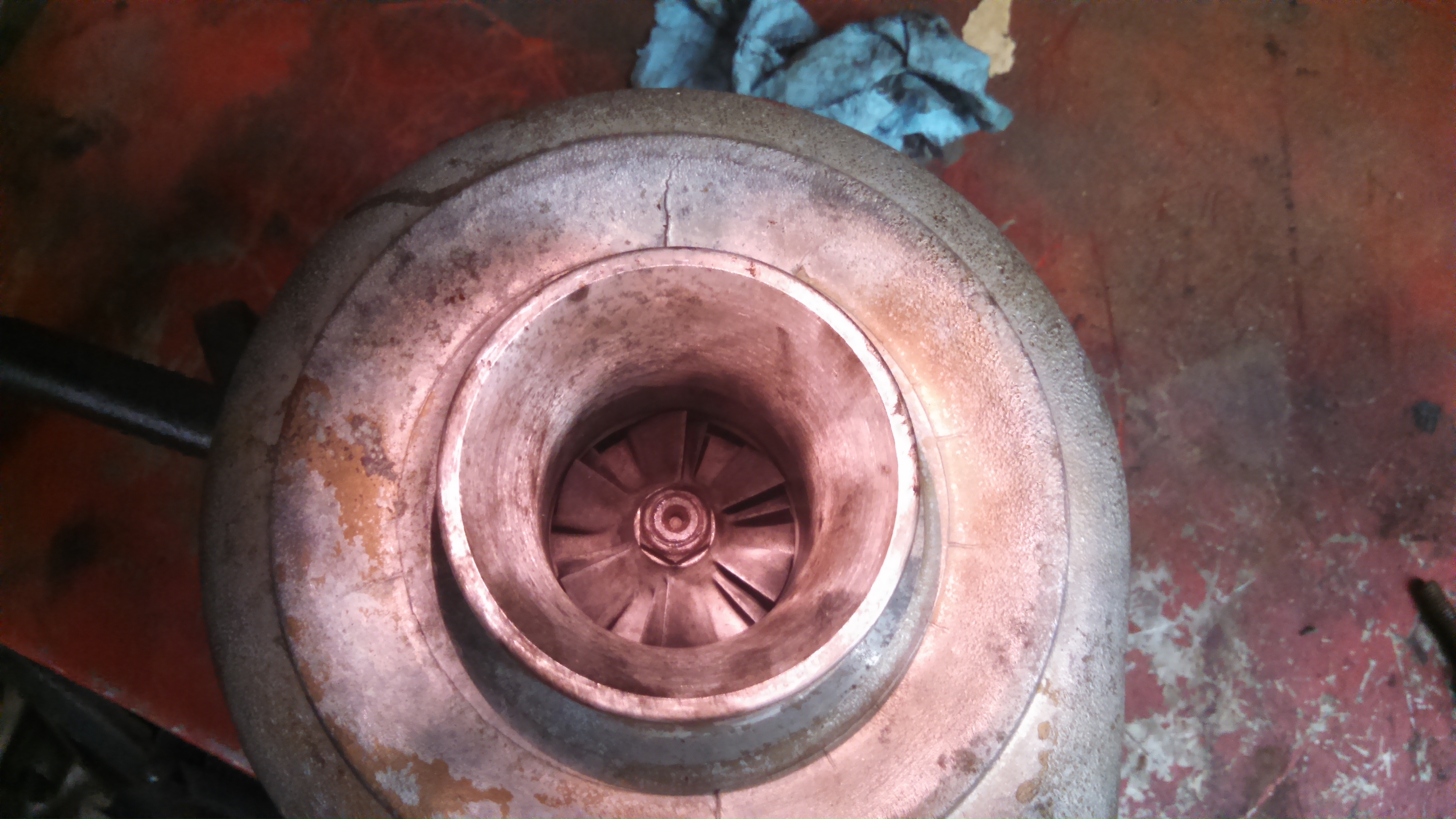

Well got it off tonight.  Bearings smooth but there is signs of oil on the pressure side(like I saw at show).  Not sure if that is the issue?  Both wheels look fine, no damage.  I think the exhaust side might have looked uglier when I first took it off but with some miles it cleaned up the rust/crud.
If there where issues with the pump not getting full throttle that would knock some boost also.  I know it hasn't changed externally but wonder if something went wrong inside.
Larry
