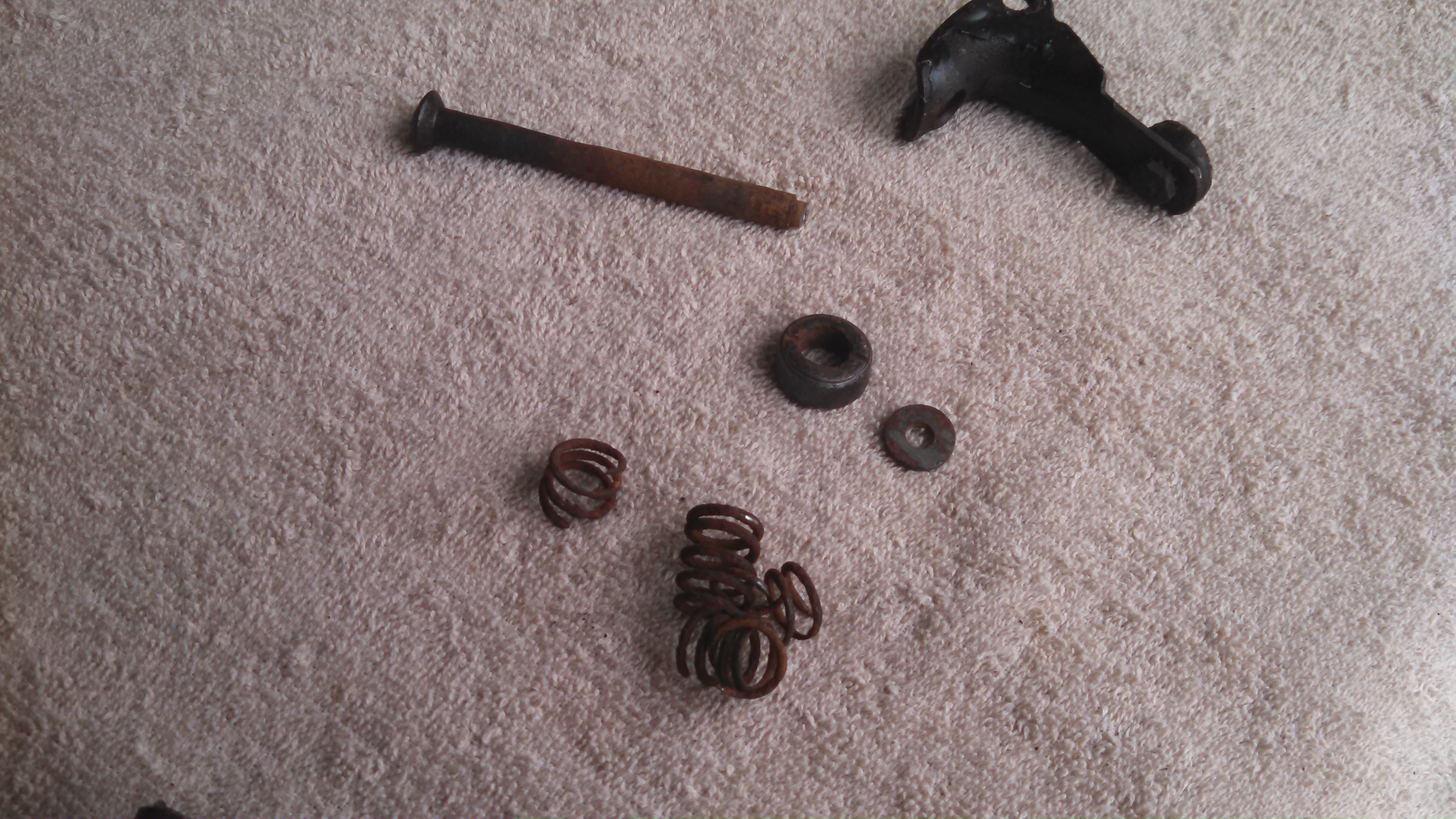

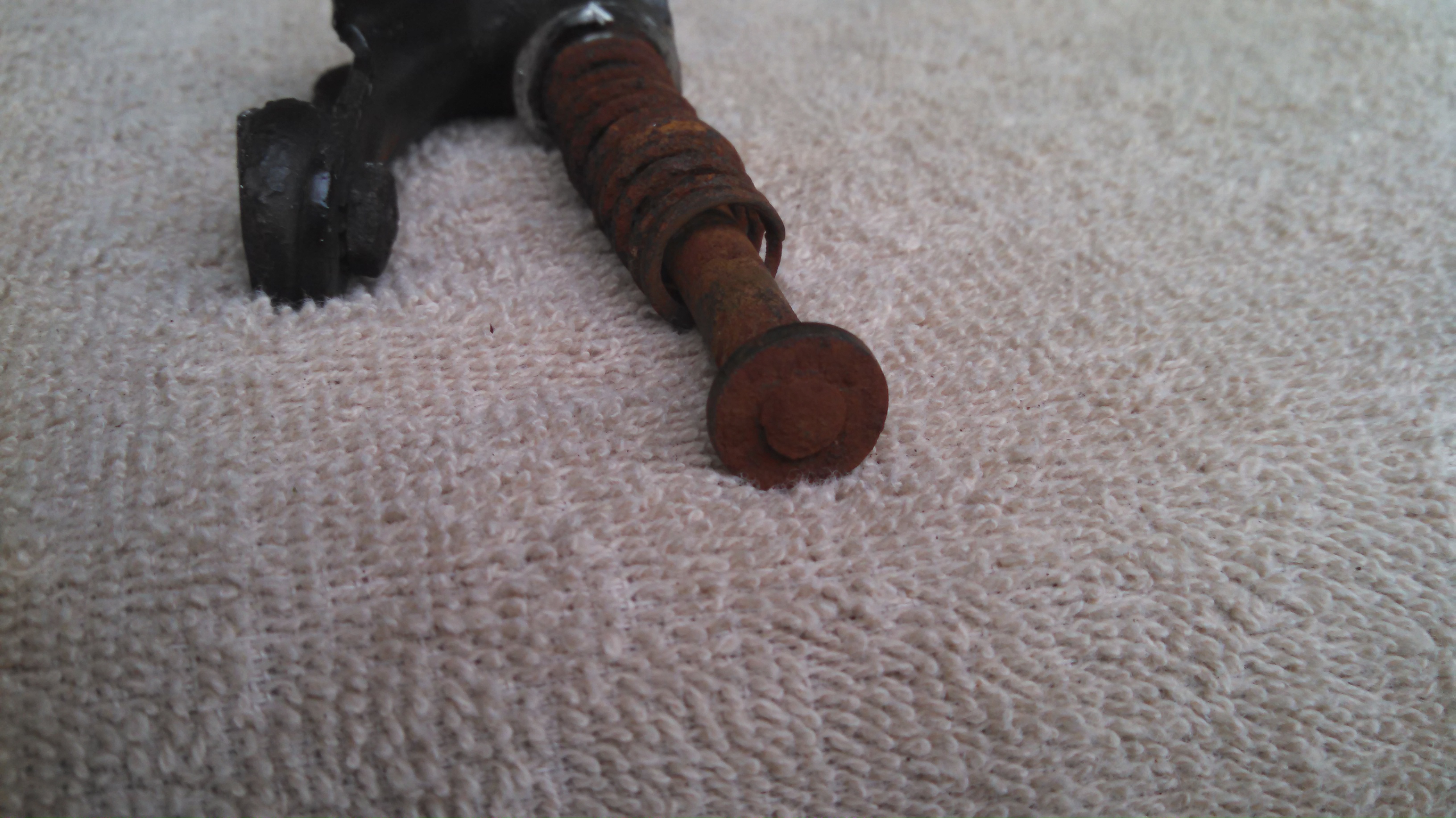

B model hood latch repair

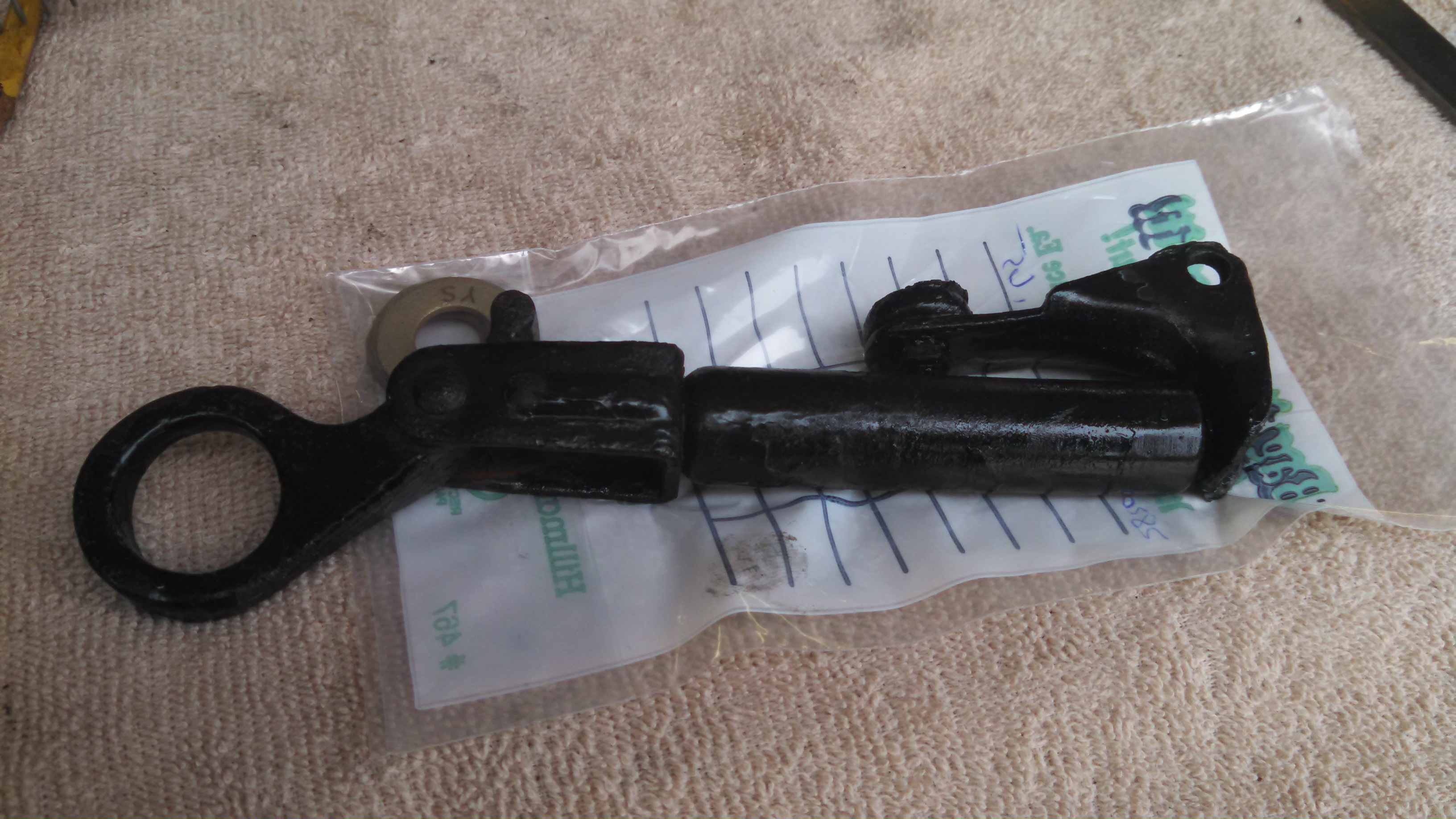

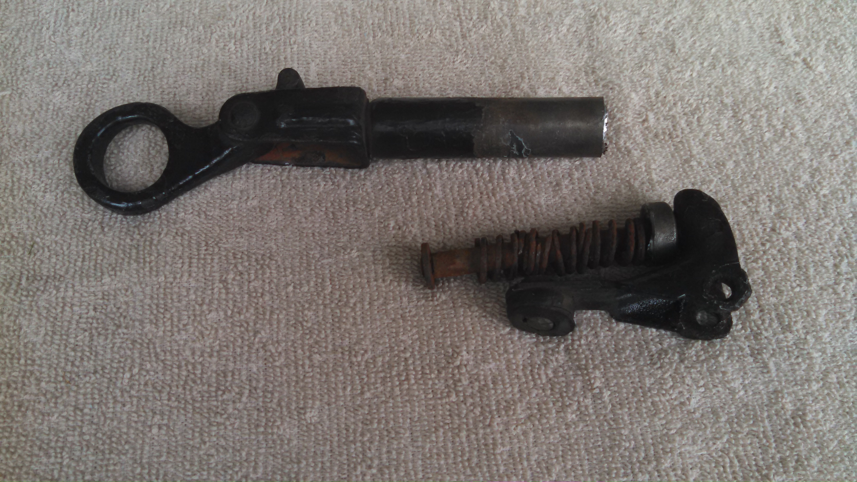

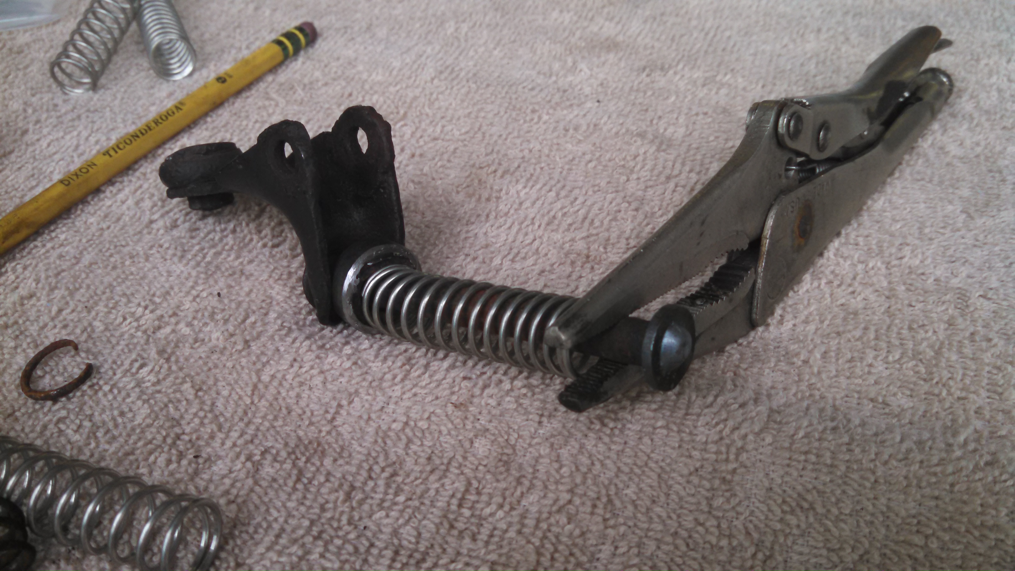

About 1/2+" up from where the pin comes out the bottom.  The threaded insert is about that long.  Gives you something good to weld into when re assembling it.  See 2nd picture from last.  They didn't upload in the order I put them.
The top picture you can see the lower mount is on backwards compared to the assembled picture below it.  I cut the mount and swapped it around once I realized it was backwards.
I edited the post to help tell what I did with each part.  I originally posted from my phone to allow me quick download of the pictures.  I added more text between the pictures to help make it easier to understand what I did.

Now that it has been a few weeks and I've used it, I can feel a slight difference in tension compared to an original.  I needed to find a STIFFER spring for the next ones.  Likely just a larger wire diameter.  I think I used a .047 wire.  I felt a .062 but it seemed too stiff.  I think it would be a tighter latch and likely use one on the next latch I rebuild.

Just an observation. The Spring is a coil, could it be screwed on past the pin head? It may make it easier to do next time with no need to cut or weld more than necessary.

I suppose you could screw it on?  But since you have to weld the body back together it is not that big of deal to put a dot on the top of the washer.  That is unless you can get the end of the tube to unscrew?
