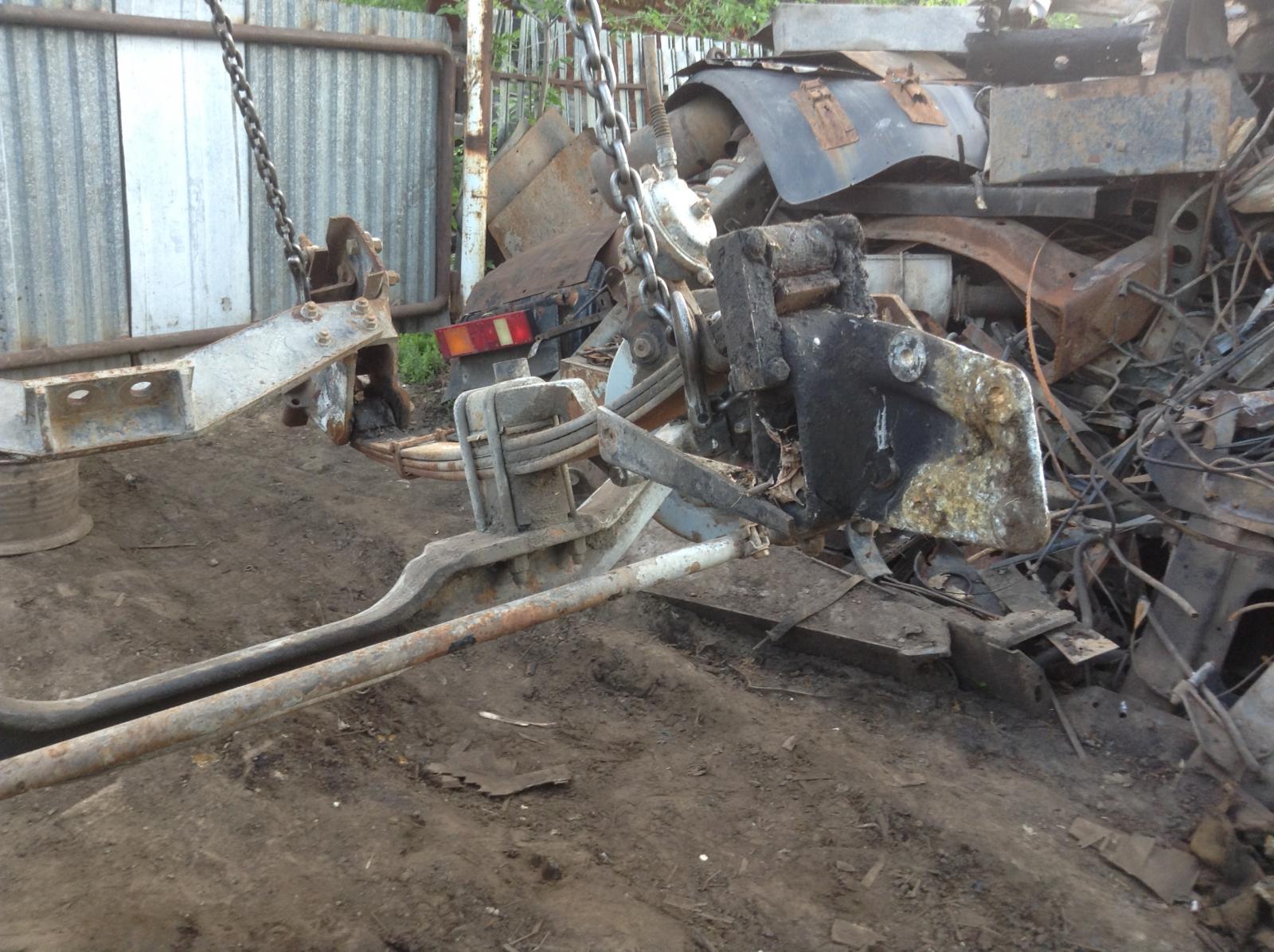

Seems like a normal front end heigth to me.
The green truck probably rides on 12.00R 24.5's wich are tall.

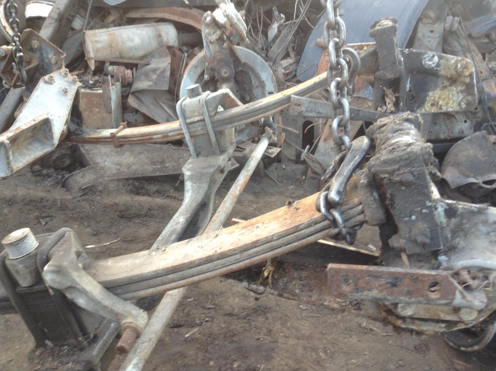

Both my R's have blocks of about 3 or 4" between the beam and the springs and I'd bet that's from the factory.
The pics show the front axle off R688 of late 80's wich was parted out. You can see them blocks. Note the paint is always the same.
post-3971-0-39758600-1455282093_thumb.jp
post-3971-0-19260800-1455282238_thumb.jp
