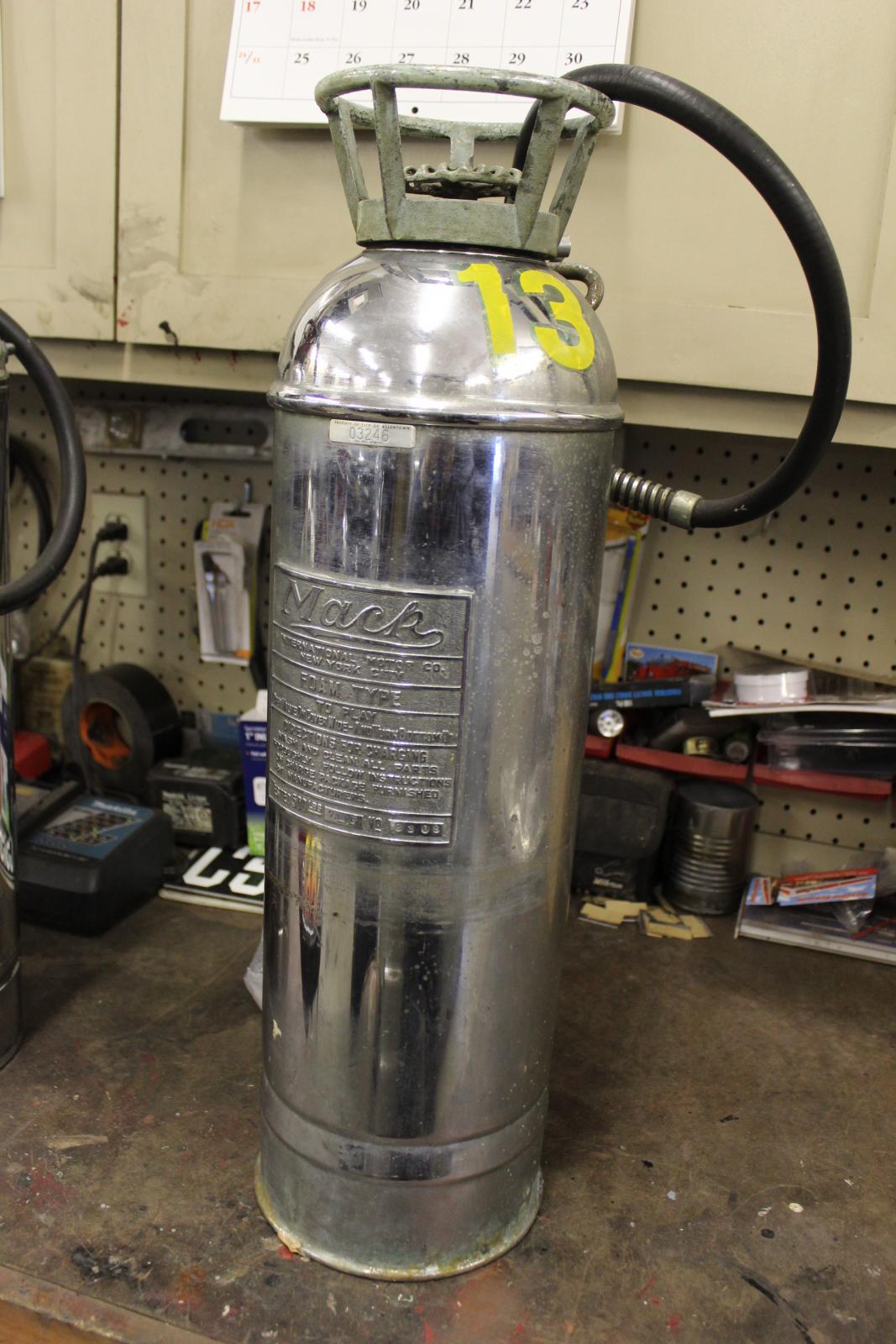

Wish I would have known you were bidding on the one with the #13 on it........could have saved you a few bucks!!! I think it was just you and I at the end
Sorry man! I am never sure about who to let know I'm bidding on something. I am out of the Mack extinguisher market for now unless the price is too low to pass on.

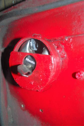

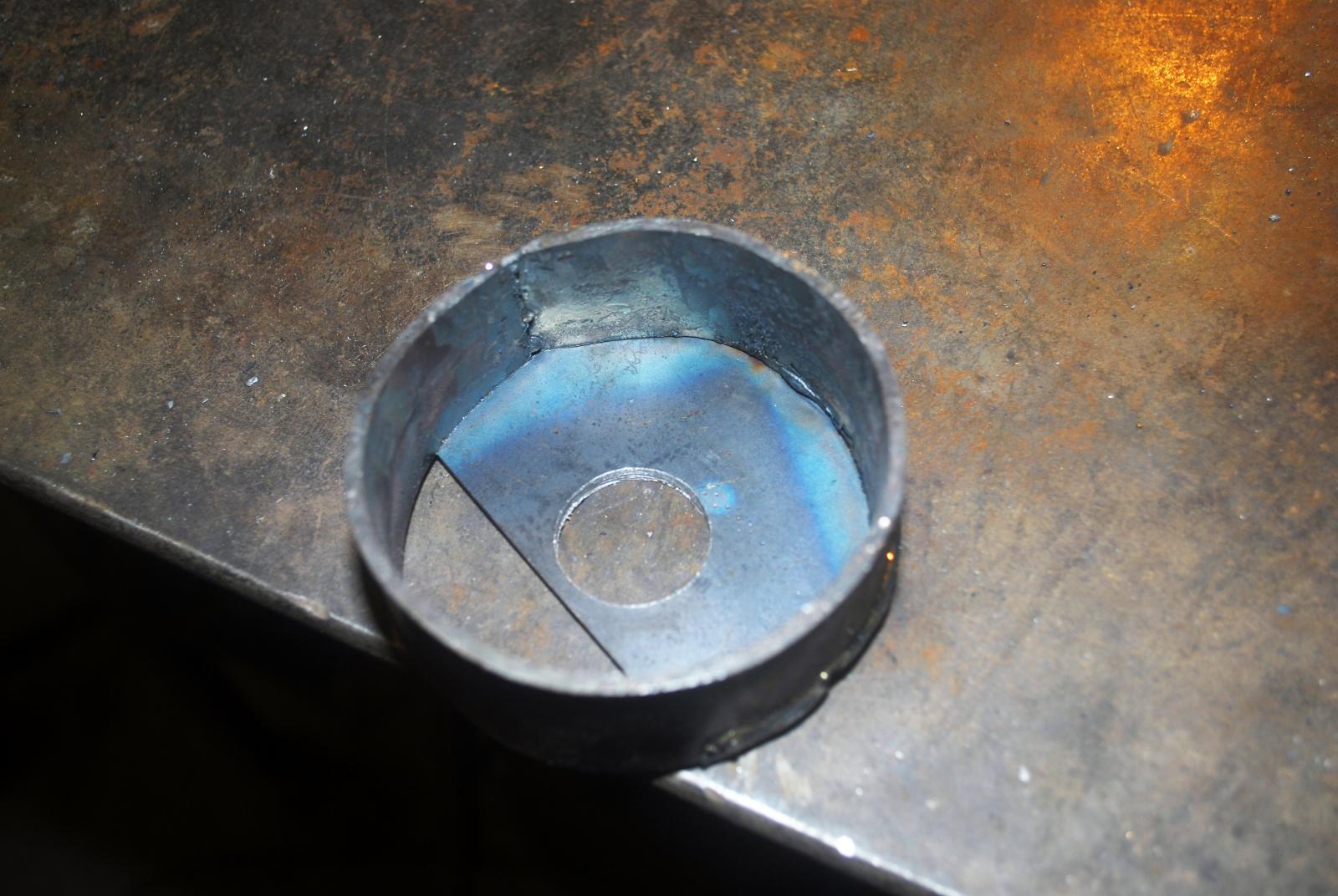

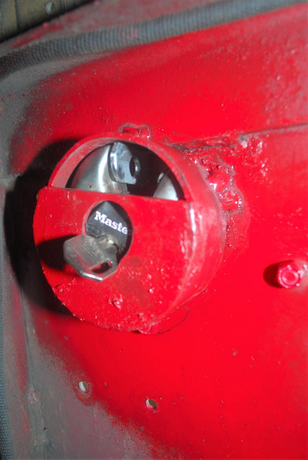

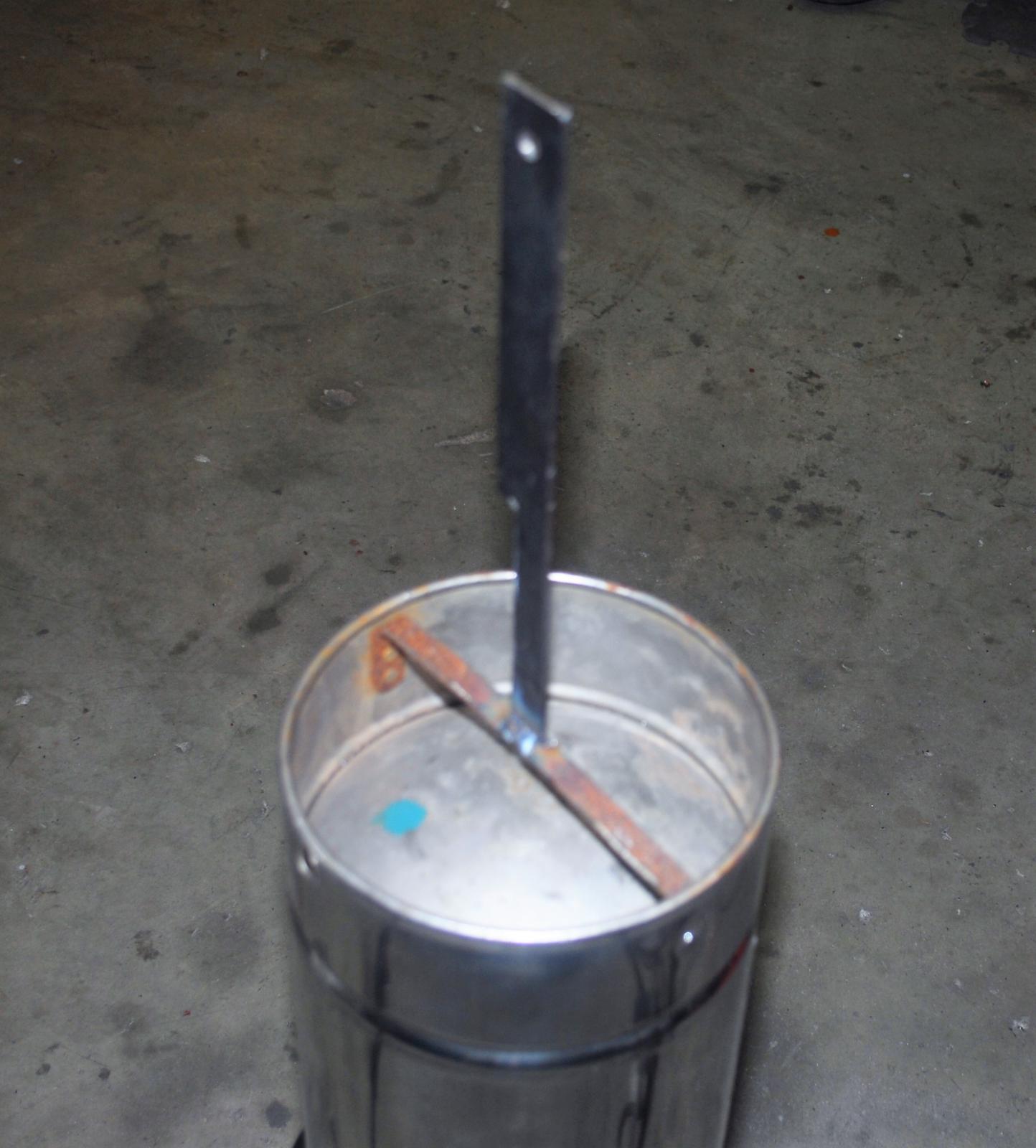

Good idea with the lock. I haven't put the extinguisher on the AC because I don't want it to disappear
I remembered you telling me that and I have been thinking of a possible solution since then. I wouldn't purchase an extinguisher for the truck unless I could figure out a solution to display it.
You really wouldn't have to weld the tab to the extinguisher; just make it a "U" shape at the top and hook it over the handle. The lock cylinder does not need to be welded to the running boards either; if the lock were enclosed on both sides by a welded cover on the cylinder it could be slipped over the tab and secured with the lock against the bottom of the running board.

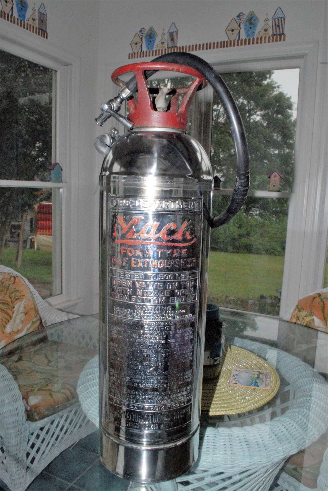

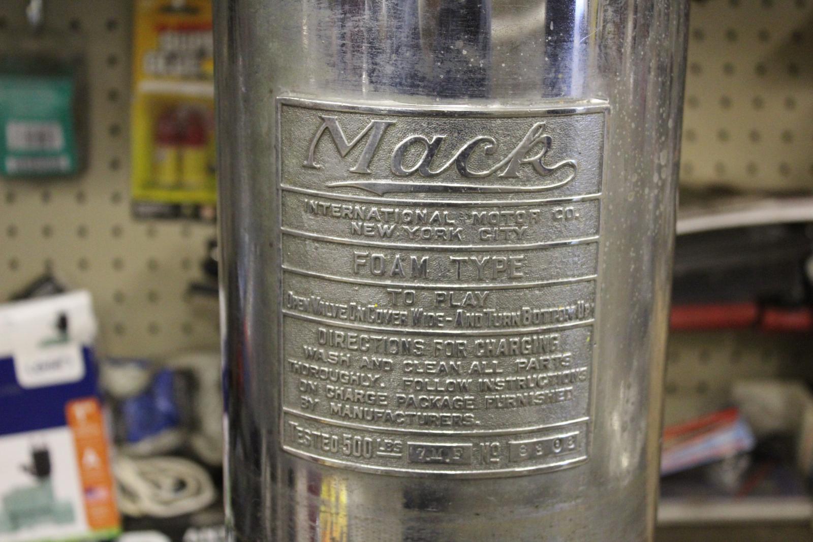

I have never had any issues at any show, but some items are so hard to find that I just don't want to tempt fate. The last three Mack extinguishers I saw sell at an auction before the ones I bought went for $1000.00 to $1200.00 each. Even at less than $500.00 each I paid, their loss would be hard to take.

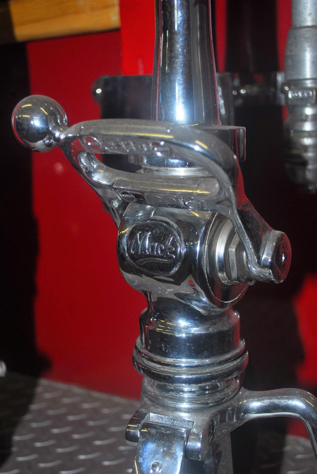

The nozzle is even rarer; I have only seen one other and it sold for $600.00 as soon as it hit the market. Like Paul said it is the small hard to replace items that seem to walk.
I know of two nozzles......one was rough and the other was it nice shape.
Buy 'em if you can. I can make the rough one look like new.
