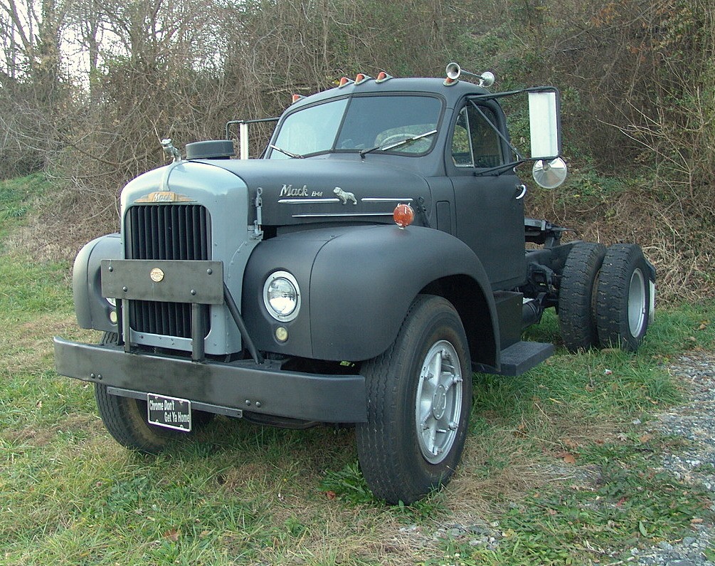

Nice clean B you have there. The 6/71 is not typical in a B, and you may hear some muffled groaning on the forum, but it's a good engine. Simple, lighter weight, starts easily even when it's cold out. Not as much power, tends to be louder, and usually leaks oil. However, I never met a 13 speed I didn't like. There was a day when the 6/71 ruled the highways; Detroit built a ton of them. I think you have an interesting combination there. Good luck with it!

Thanks a ton guys! I'm super excited about my first big rig! I'm a classic car guy, and even more of a Corvette guy, so this is a little of course for me, but always wanted a semi...and I'm REALLY excited to find that the total height on mine is a hair less than 8 feet, which means it's going to fit under my house, in my shop!!!
I'm going to grab some fuel filters and an oil and air filter and do some genearal maintence over the weekend to see if I can get the thing a little more road-friendly.
Trying to decide which route to go with the truck...I've got ideas all over the place, from just leaving it like it is, to taking the fifth-wheel off and putting a period correct wooden flat-bed on it, to going all out custom and slamming it on air ride suspension. Seems like a fun vehicle that everyone looks at though!
