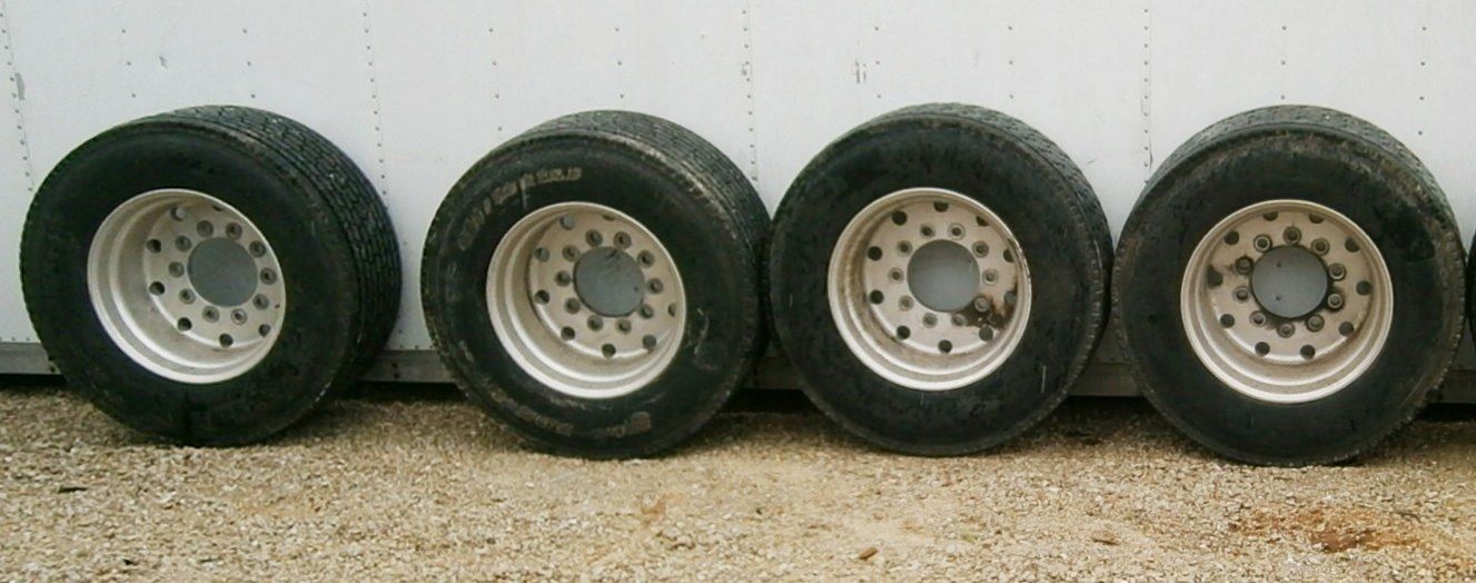

Don't know how about spokes (no, as far as I know there must be special spokes to fit the only rim inverted),
but I saw this on evil bay esterday. Pricy !!
post-3971-0-77507000-1412625675_thumb.jp

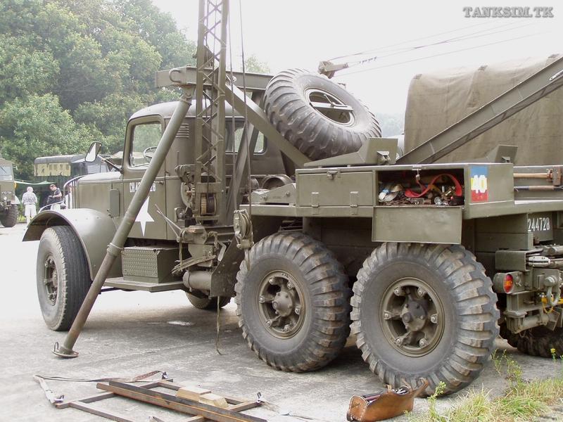

Sorry for the off-topic, closer to the matter.
Those single wheel hubs are about the kind of front ones.
They have a rim sitting shoulder near the outside to keep the wheel about the middle, not to put an inner wheel deep.
My 1945 army Mack (not the one on the picture) had them original single rears. But during its service in Russia (Soviet Union those days) some one cutted the hubs over with a big lathe to apply double rims. He just "moved" the shoulder deeper to the truck's center to make a room for one more rim and a ring.
