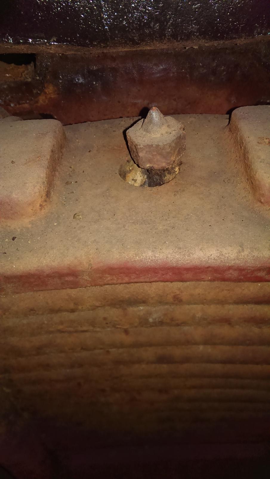

Looks like the center bolt is about rotted away. You will need to get the rear springs off or at least taken free from the other suspension parts. Once you do that you can replace the bolt or take to a spring shop or pay someone to do that work. Worst part is everything is heavy and big. The center bolt keeps the spring pack together and aligned over the axle and/or over the other suspension components depending on setup (single axel, tandem,...). The center bolt holds the springs and every thing aligned, it is a critical part of the suspension.
Luckily they are not that expensive and you can get them from a parts store or spring shop.
my problem is I'm afraid to try and take it apart. It's a 55k suspension and I think I will be opening a supersized can of worms. I would like to find a whole rear cut off from a dm800 so I can have spring brakes and go a little faster but everyone wants 5k or more.
yup, two new U bolts and a center bolt and your back in business. you can cut the old U bolts with the head wrench and grind that center bolt off and just unstack the pack of springs til you get to the main 3 leaves. then jack both ends up til you can get the old center bolt out and a new one in, then restack the leaves and tighten it all back up with new bolts. not hard just heavy. your right tho, might be cheaper to find Dm800 with newer rears, newer brakes and maybe a higher gear ratio, then stuff and E9 under the hood of that B81 and a 12 speed Mack and your good to go.......
