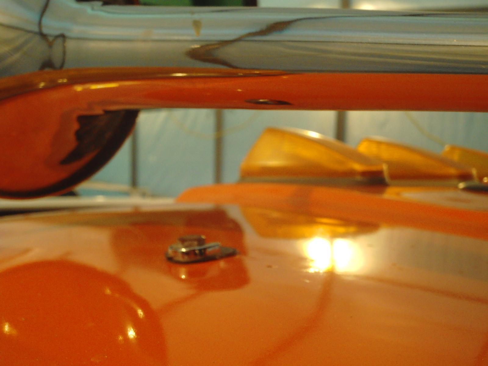

I would like to replace the factory single round air horn on my truck (1981 R) with a square horn. I've never done this before and would like some advice on how to do it. Do I have to take off the interior roof panels ? Or what will I find when I unscrew the original horn from the roof, etc. ? Thank you !

I agree about round horns but I replaced mine and I did have to drop the headliner.You will have to plumb airlines to go dual horns it's not a big deal.I also found that the length is different on the mounting brackets from round to square so you will have to do some drilling on your roof.
