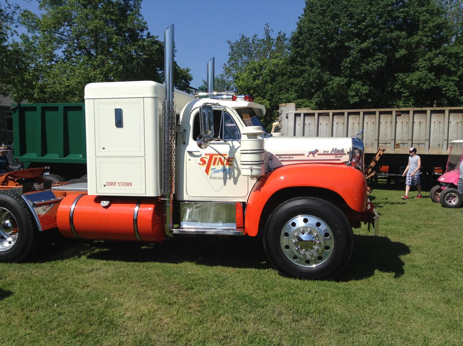

I'm no expert but I'm nearly positive that Mack sold B to R conversions back in the late '60s and '70s that would become BCR's (B converted R)
That's obviously the oppisite of what you're looking for. I believe that one issue you will run into is the width of the R model front axle compared to the B model body and fenders.
Ed Smith
1957 B85F 1242 "The General Ike"

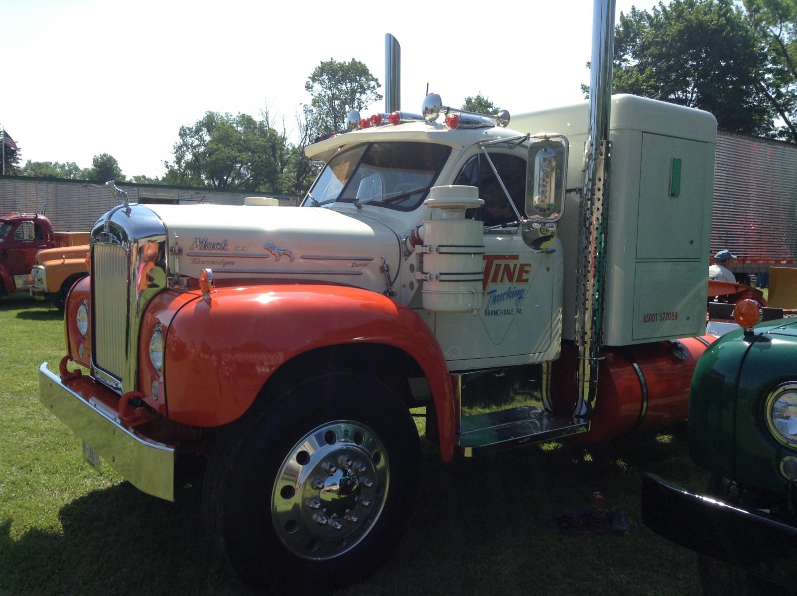

the early R models used B model front axles, same width. after that they went about 2'' wider. that Stine truck is on an older R chassis I believe to, you can see how the wheels stick out past the fenders. it can be done, the steering column might have to be used from the R model, but I have seen that done also
