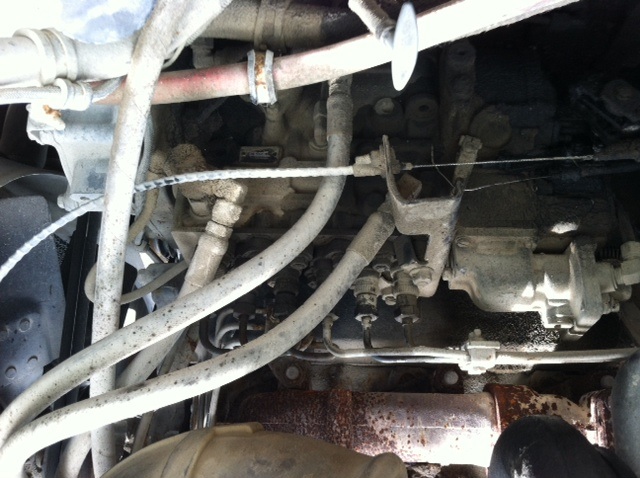

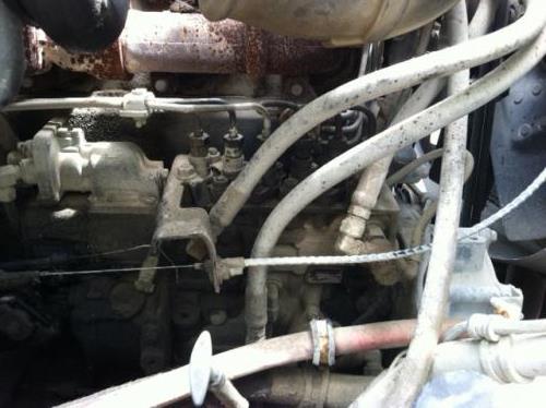

Ok I will try these things this weekend the injection pump is on pass side the shut off valve is in. Even released the set screw and made sure the lever was fully open. The truck has a pneumatic blower on it and was running at 800 rpm when it started losing power. Drove it home and now it won't start changed both filters the fuel smells like turpentine or thinner I have owned the truck 2 years and not used it much except has a back up to my other blower truck maybe 5 times always started quick and ran good this was sudden. We had just put 20 gallons of diesel in it the day before. I primed the filters try to start then when I take the short filter off it is half empty. So we will try the clean container first I guess. Thanks
Just got in from checking it out this is what we did
Undo main hose from tank at filter blew into tank lots of bubbles, then pressurized tank, fuel came out hose tighten hose un did filter fuel came out filter, tried to start fuel out return line at tank. Made sure everything was Tightened up. Had to either to start. Runs.

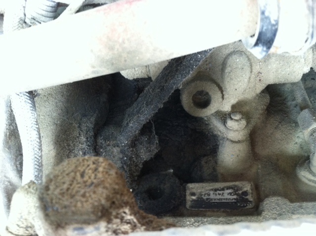

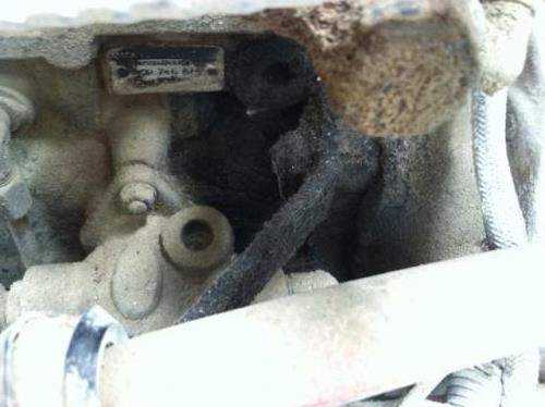

Now it will not idle unless you use the throttle cable, and then the idle is rough, will not start with out either does not seem to be responsive with fuel peddle, on top of injection pump is the lines all lines loosed showed fuel and made engine idle rougher except one the 2 nd from back. Now going to try and figure out how to get that thing out and what is it called. Any more suggestion would be appreciated.
No fuel prime pump at injection pump. Bummers

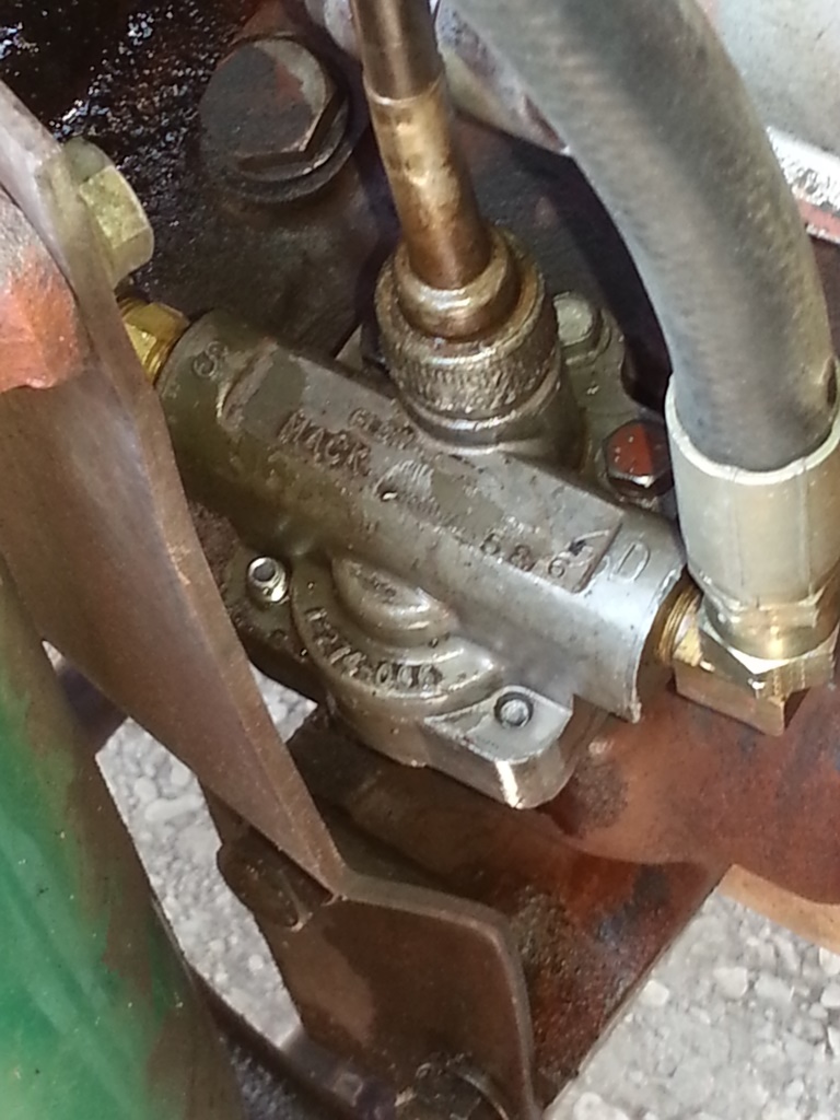

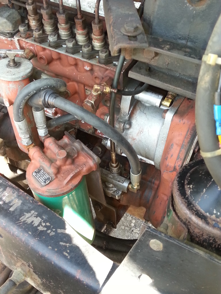

the fuel transfer pump is hooked to the injector pump and runs like off a cam, pull the line off on the far side before it goes into the filter and crank it over with the fuel shut off pulled so the truck wont try and start to see if it is pumping fuel? sounds like what was happening to mine.
The pump is not a hard fix to replace a little pricy, just make sure its clean and take your time I was afraid I would break one of the 1/4 inch bolts that hold it on by always not knowing my own strength. I moved everything out of the way, filters etc... and still only took about 45 minutes taking my time.

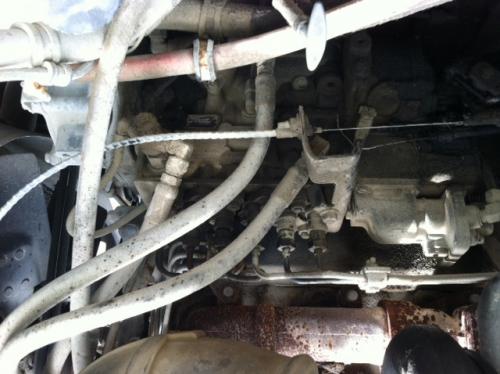

I have two filters on driver side long and short the fuel come from tank into short ( I guess primary) then to the side of injection pump i guess transfer pump, (which is where your tach is installed ) then out back to the other filter then back to injection pump so I should take line off after transfer pump that goes back to second filter? Sound like a good idea if the transfer is not pumping fuel than that's my problem.

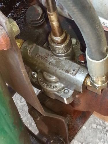

Exactly, the replacement fix for mine was a tach drive and a separate fuel transfer pump, it comes with a prime pump my original did not have a prime pump.
The tach adapter goes where the tack cable and transfer pump are in the picture and the transfer pumpw/primer goes on the injector pump had to take off a triangle plate and it bolted right on.
