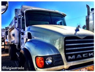

Yup, T309 is a manual trans. Just drove one the other day. 7 years old and 600,000 and it's jumping out of 4th and 8th gear. If you meant you were going to swap in a T309, I think I'd find something else, personally. Your best overall bet would be just sell your truck and find one spec'd the way you want it, unless you had a wrecked donor truck you could rob parts off of, such as clutch pedal and linkage, floor board, bell housing, transmission mounts, driveshaft,etc.....
