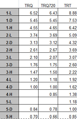

GreenDash- thx-I've seen that before-but what is the double 'O" version Maddog references? TRQ 7220??
It appears they use only one zero regardless of whether it is a single or double overdrive. it also lists all 20 gear ratios, even the redundant ones, on the 18 speed version of the Quad.
No 0 is a single overdrive in the back box, all triplex and quads are overdrive in the back box, A 0 like in a TRQ7220 is overdrive in the front, so there is your double overdrive. terry
yup, TRQ7220 is a double overdrive 18 speed. the 20 stands for 2 over. overdrive in the front and rear box.
Yes any 72 series with a 0 at the end is a double overdrive, either a TRT or a TRQ. Terry

All 72 series triplex and quadruplex compounds are overdrive.
Triplex direct TRT72, single OD
Quadruplex direct, TRQ72 single OD
With overdrive main box,
Triplex over TRT720, double OD
Quadruplex over, TRQ720, double OD
The 2nd 2 in the number is variation in input shaft (spline size, single /double disc)
