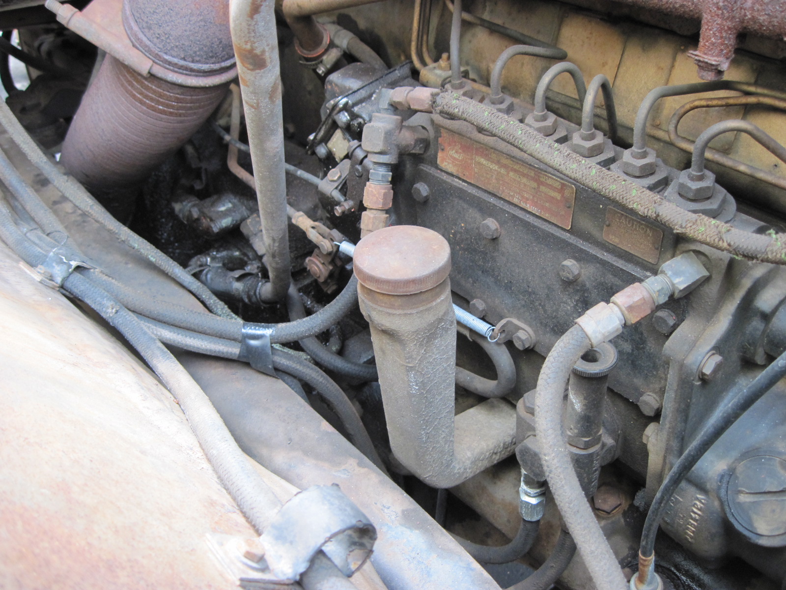

My engine is out of a 1973 U model...the oil fill comes up from below the injector pump
post-6773-0-84934000-1303059492_thumb.jp
That looks like mine but different. I will post a pick tomorrow since its dark here already. Did any Thermodyne diesels have a Oil Fill spot there?
Tom
Yes. The ones in the DM, R, & U models, and apparently the F models too.
"If You Can't Shift It Smoothly, You Shouldn't Be Driving It"
That's a good place for an oil fill. Don't have to be too concerned about spilling oil on any v/c or engine an parts. I like it. I'm just use to a six cylinder having to fill oil in the v/c on top front.

Most B models and 673's i have seen have the oil fill on the top valve cover.. some i have seen have it bolted to the side valve cover near the air compressor and a few have it under the injection pump like in the pic. i think in the late 60's and early 70's they moved it to under the pump. Most B61's i have ever put oil in that had it on the top valve cover have the damn radiator radius rod going right across the filler so its hard tp get a funnel in the cover. i think this was a Mack flaw haha. i have even removed the filler before and drilled and tapped new holes in the valve cover to move the filler out of the way of the radius rod a little. also on the number stamping, most cabovers i have seen have the number stamped in the back of the block just below the head. i have also seen it stamped in both places. Just when you think you know all about Macks, they suprise you haha. ~Matt
