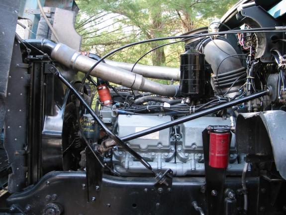

went to look at a1987 superliner yesterday the steering box was mounted on the front axle have never seen this setup ? could someone give me some info on this, are they trouble are they ok this sort of stuff. Also the E9 500 V8 smokes when you give it throttle an i notice the exhust manifold seems a little wet on 3 cylinders( around the gaskets)there is no blowby and the cap on the filler tube is free from condensation and the tube is clean. The guy said the motor was done by the previous owner.The truck has been sitting for 4 years also the trany. is a 2100 10 speed I have a couple of 2090's but no 10 speeds also the interior is painted black from factory 40 rears with neway air ride single frame never owned a v8 Mack so any info would be appreciated thank you BULLHUSK ernie67rt@aol.com

:SMOKIE-LFT: If the steering box is mounted on the axle beam it's a Superliner 1 it must be78 thru early 84 model. If that truck has been parked for 4 years and has only sat around and idled once in a blue moon that is why you would be wet around the manifold it's loaded up with fuel. It probably needs a good load behind it and work it to clean it out. V8s don't like to sit around idling. Probably has the Ambac V- type pump. Nature of the beast to give a good puff of black smoke if you crack the throttle.

I like the black smoke and almost instantaneous throttle response of the V8 engines. Sound good through the pipes too. Although mine are only the 865, and 866 variants, the sound is all their own.
