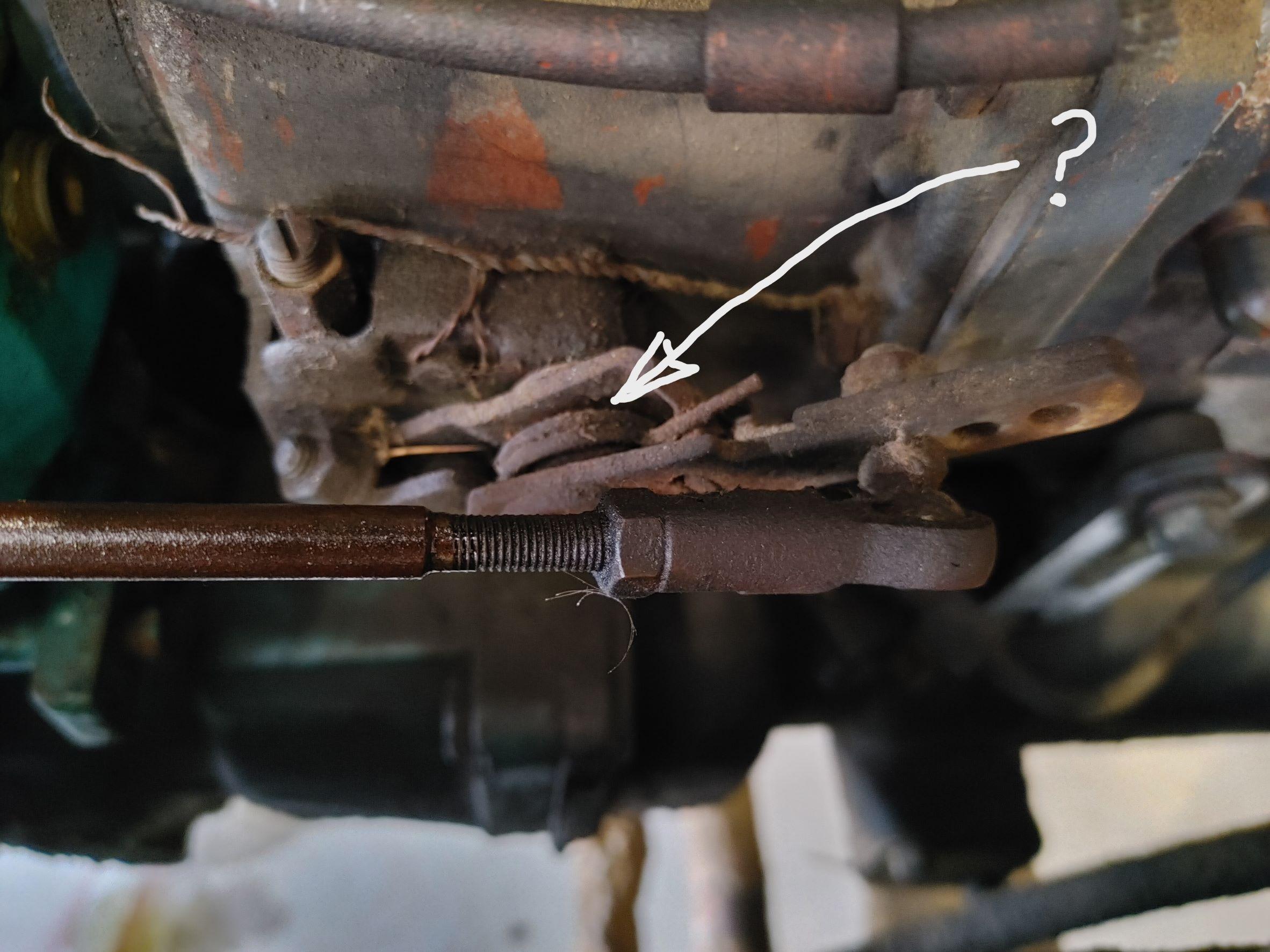

  12. Thanks guys - halo test was good, although with the extended oil change setup, there's a lot of oil there! Break over spring didn't have any slop - directly working the lever (vs linkage from pedal) didn't indicate any dead spots where the spring wasn't tight. I didn't work on the truck much since Friday. I'm trying to minimize any low rpm/idle time on the engine as well (due to unknown engine break in after in frame). So I'm gathering troubleshooting ideas to maximize benefit of run time. Chasing some cooling system issues as well. Lot of reliability things creep in when a truck sits for several years (or a decade!). Thanks again for all the advice and input!

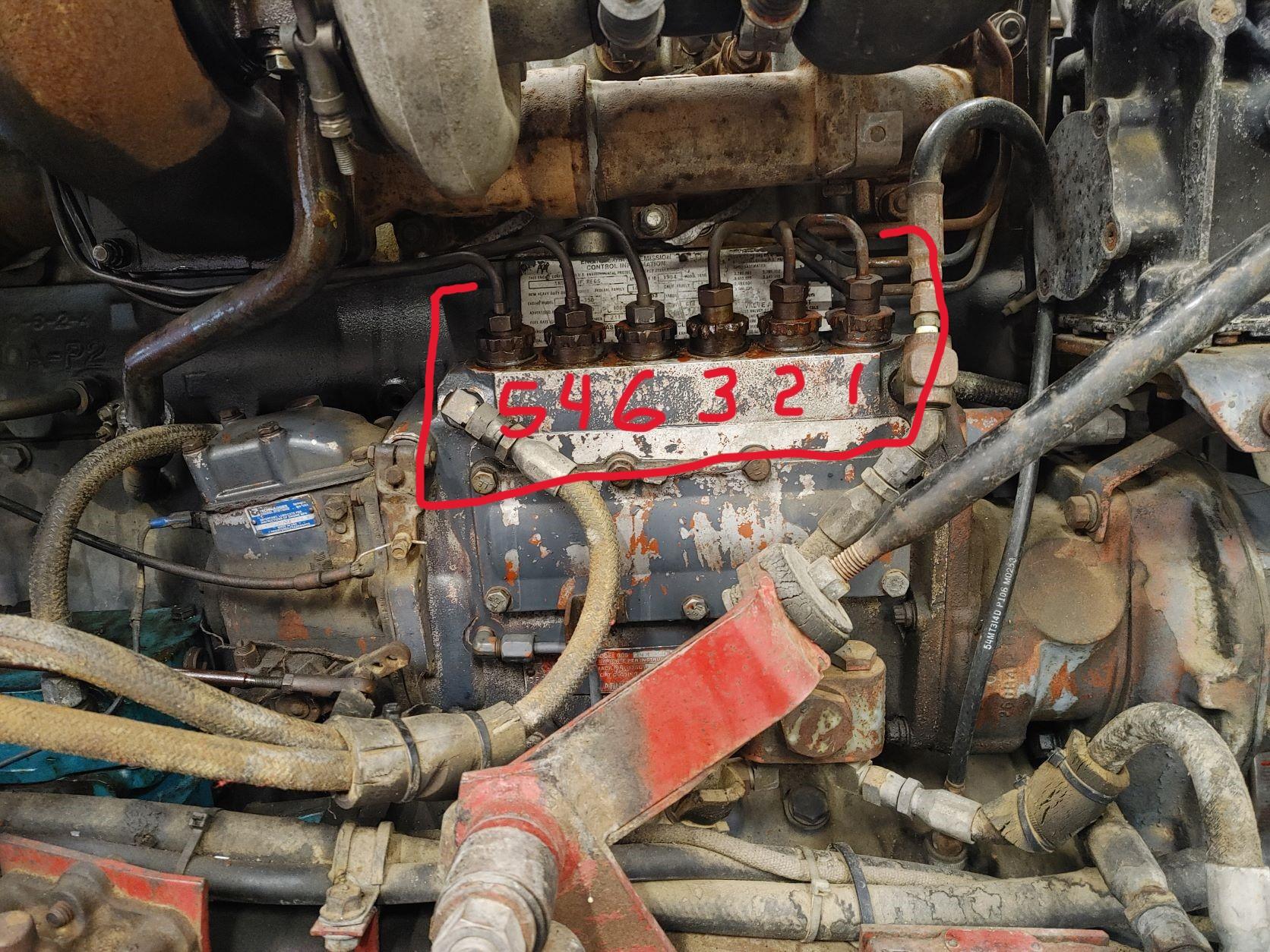

  13. All right, all six injectors checked out/cleaned up/corrected. Fuel inlet tubes 4, 5 and 6 "adjusted" to line up correctly on the pump. Definitely plan to replace them, they were in rough shape before my work over, they certainly aren't any better now... Truck does run a LOT better with no fuel seeping out turbo/exhaust connection. Still have the surge right after start up, even before it gets warm - fjh and/or jojo, is the throttle lever breakover spring shown in the photo? I'm not counting out a worn or sticky governor though, it sat for a number of years. Will try your idea of getting the truck unlevel and see if the surge goes away h67st. The truck supposedly had an in-frame done and what looks like new heads. Ran like crap and prior owner started to work on it, but didn't get it done. So I'm unraveling some of the history, but concerned a break-in was not done and that I might wash down cylinder walls. Going to check if any local shops can put it on a dyno - I don't have a trailer/load to put on it for a proper break in.
  14. Thanks guys, seems I'm battling a couple problems here. Going to verify injectors are decent (1), find new/used tubes or "adjust" existing to fit correctly (2), and then (3), see if my surge problem is still present after that. Kinda surprised it was running with that drastic of timing problems on cylinders 4-6!!

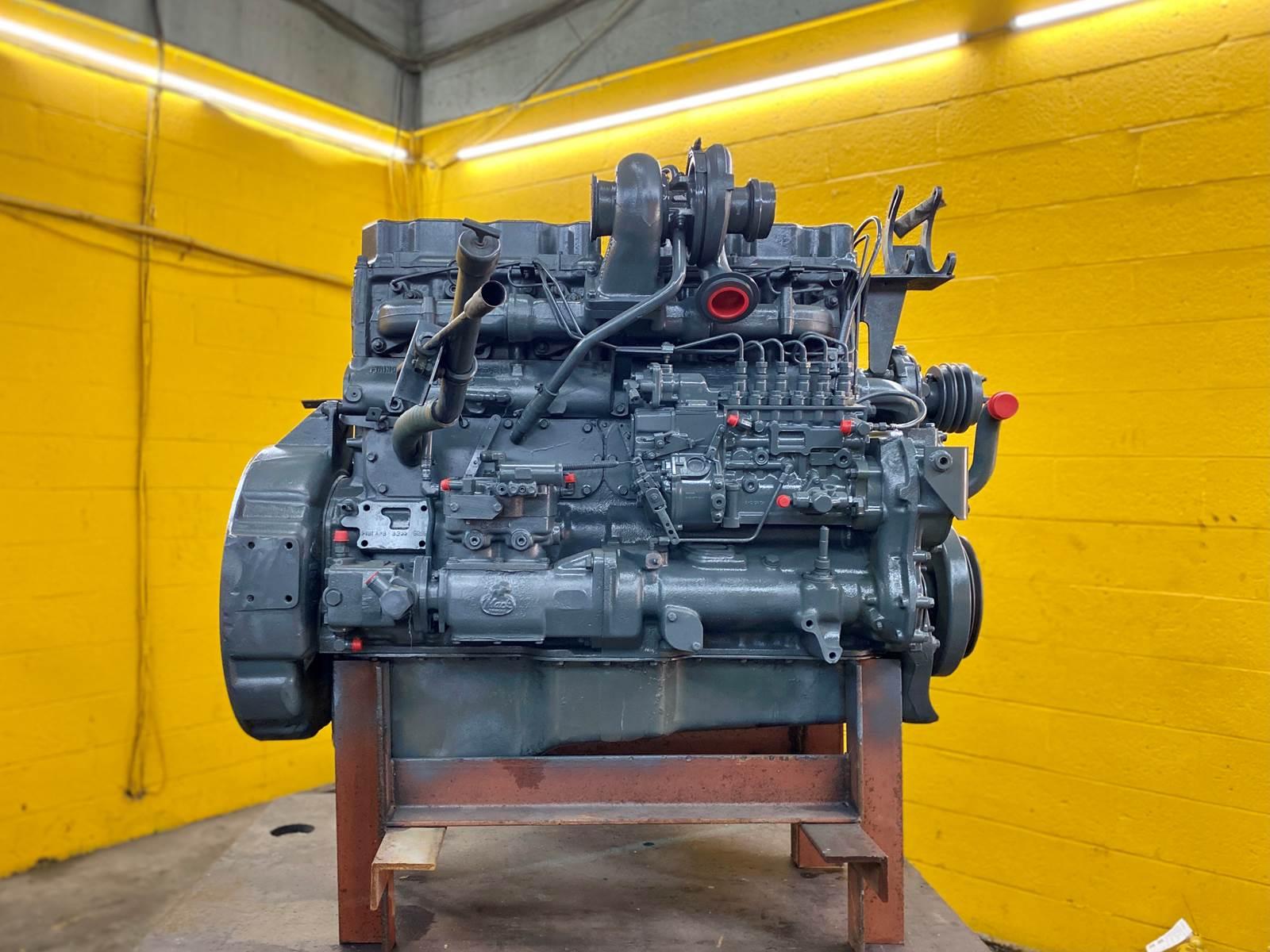

  15. I took a picture and did some markup to help show what I'm talking about, although you are tracking jojo. I've got injectors 1-3 at the shop getting pressure/pattern checked, so the tubes are loose at the pump. It's the 4-6 positions that are definitely hand bent. It appears my turbo comes out straight, others seem to kick up and have more room underneath to run tubes. I attached a pic of an E6 4 valve from the interweb (although you can't see turbo well in my pic). Thanks, Scott
