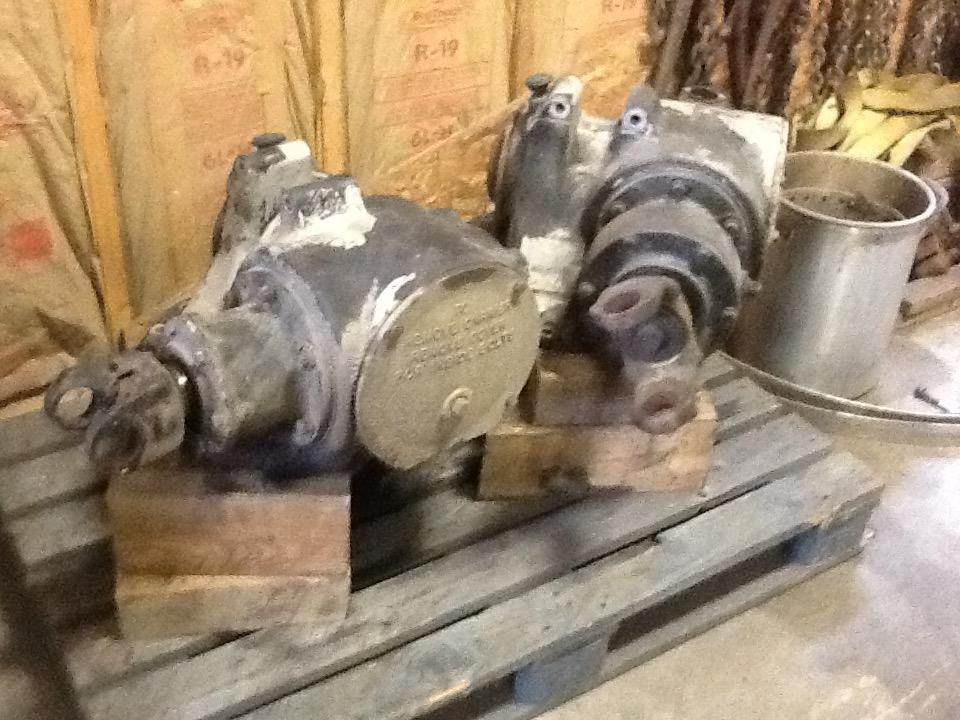

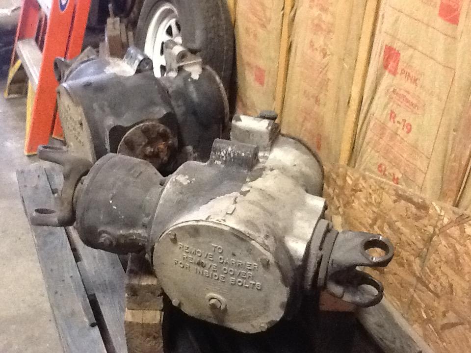

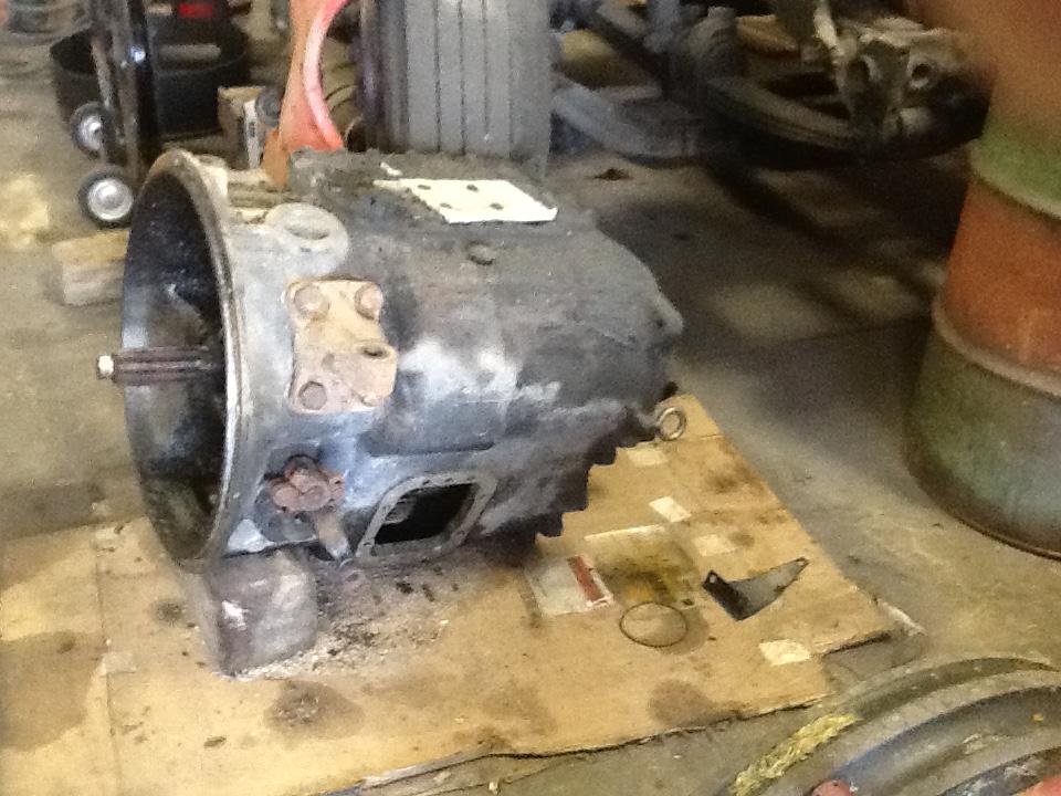

  21. I have a 5 speed trans. and a set of 5.73 rears for sale.
