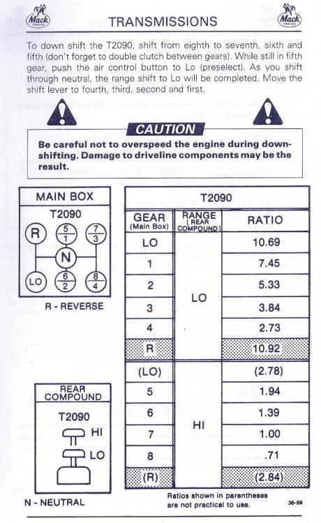

I believe oil goes through the small tubes and the coolant surrounds the tubes. The oil first goes through the oil cooler then it goes to the oil filter assemblies. Heres a pic from the manual that shows each of the tubes. I think the tube you are referring to carries the cooled oil back to the oil filter assembly.
